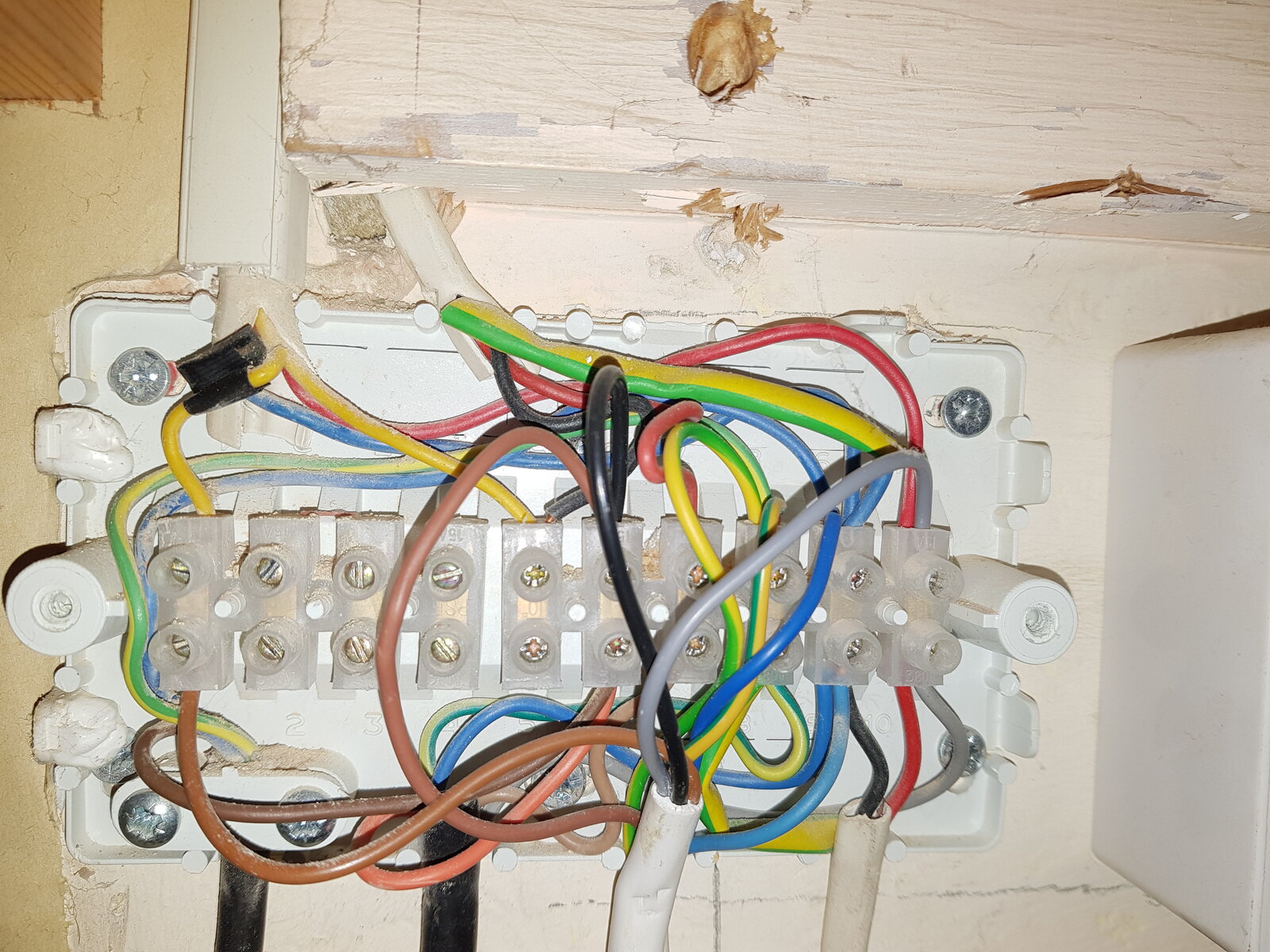

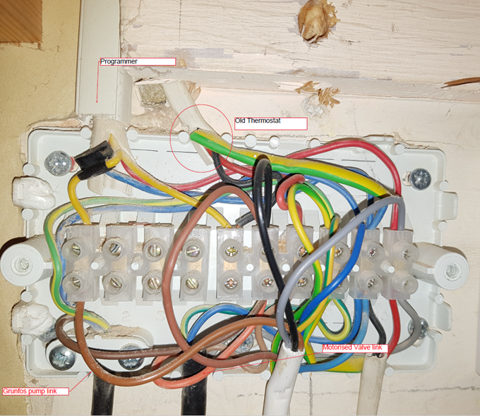

Would you be able to help me with the attached please?
I assumed that I could just cap off and make safe the wires to the Honeywell Thermostat and put up the wireless Hive stat but I've been told that it will still try to call for heat or not work at all through Hive?
So:
The top left white cable is the programmer,
The right cable is the Old stat which I need to disconnect.
The bottom left black powers the Grundfos pump
The bottom Right powers the motorised valve.
My wiring looks slightly different to that which appears to be online (S & Y) which is making it harder for me. Would you kindly guide me on where I need to move the cables to make the programmer work with the wireless Hive please?
Am I correct in thinking that the yellow currently at no 5 will need to move to no 3 (Heat on, on Hive)?
And what looks like grey coming from the black bottom right from the motorised valve will move from 10 to 3 also?
Still don't think that's right.....
Hopefully this makes sense! Thank you!
Easiest way to do it, fit the hive receiver where the existing Potterton is and wire as I already said, remove existing thermostat and join the two wires (red & Black) in a single terminal block and insulate , pop inthe wall and fit the hive thermostat over the existing hole , no need to touch anything inside the wiring centre, importantly before you do anything, on theexisting controller select only the heating and make sure the hw light doesnt come on with only ch selected, if it doesnt thats a fully pumped system if it does you have a gravity hw system, and will need to set the hive accordingly

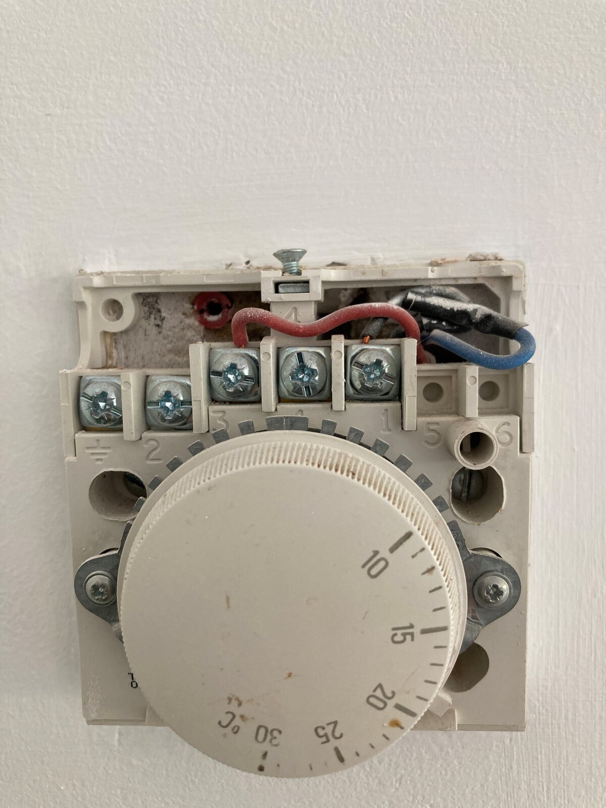

Sorry, I also think the wires at the stat are blue and black - the red appears to be a jump. Does this make any difference?
As per your pic the wires are red & Black in terminals 1 & 3 of the room thermostat, the blue is not connected and is isolated, you need to join the red and black wires to complete the circuit, the Hive will take over this task,
Have just turned up the thermostat and put heating as 'on’ and the hot water did not come on along side it.
For absolute clarity, does that mean that I can install as per your instructions, remove the stat, cross the wires and leave the wiring centre alone?
Yes and set the Hive to fully pumped, should be set as that out of the box anyway
