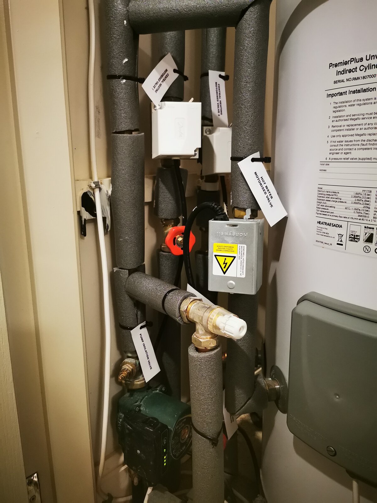

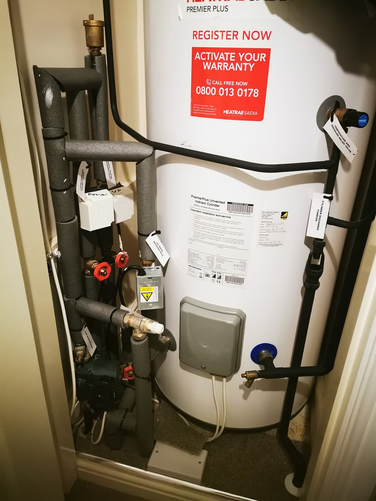

I'm after some advice on how difficult it is to wire a hive system into my existing CH/HW system.
I'm confident on the tools, but have never installed Hive so want to know if it's something I can do before I attempt it. Its a new build, with a split level heating system, and how water, fired from a boiler into a tank.
I'll attach a picture of the tank and this is where all the valves and controls are all wired to.
I want to have a split heating system as it is currently and seperate control over the Hot water to enable timing to be changed etc.
Is it quite a methodical thing to do with working out where each feed goes and wiring it accordingly?
Thanks for any info in advance.

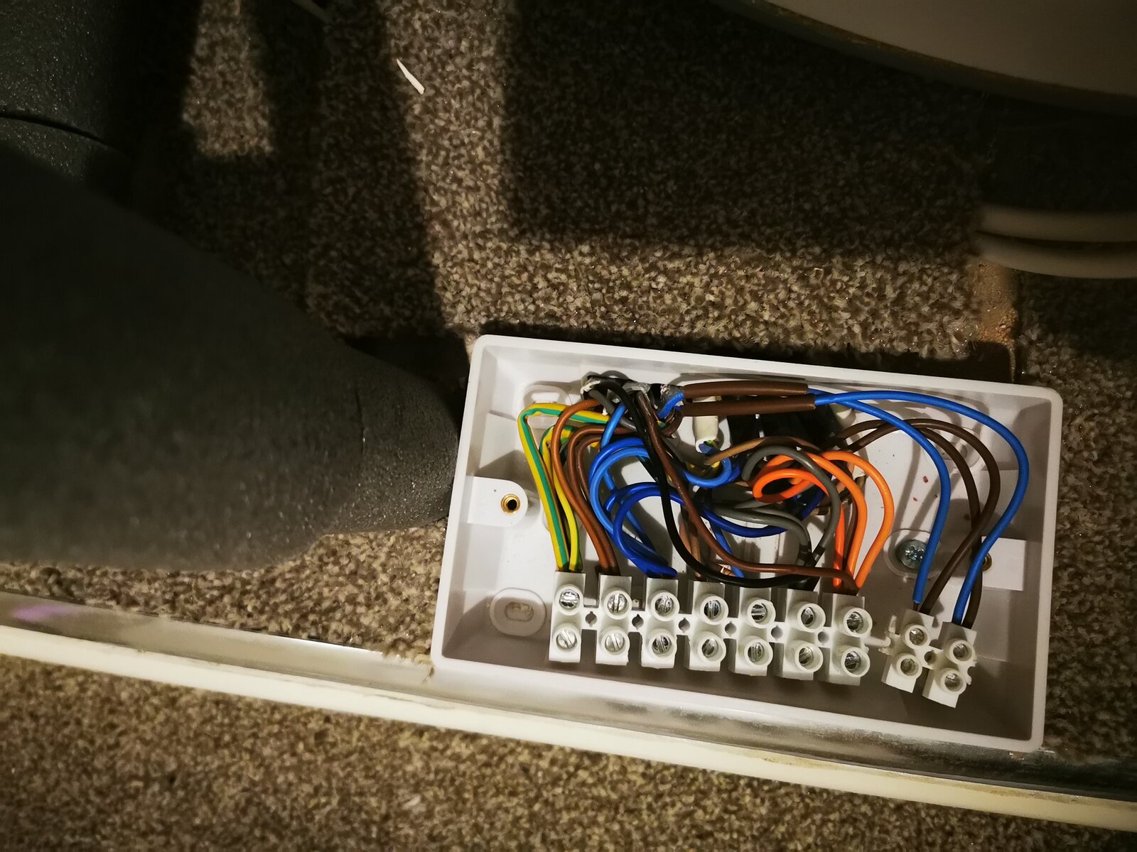

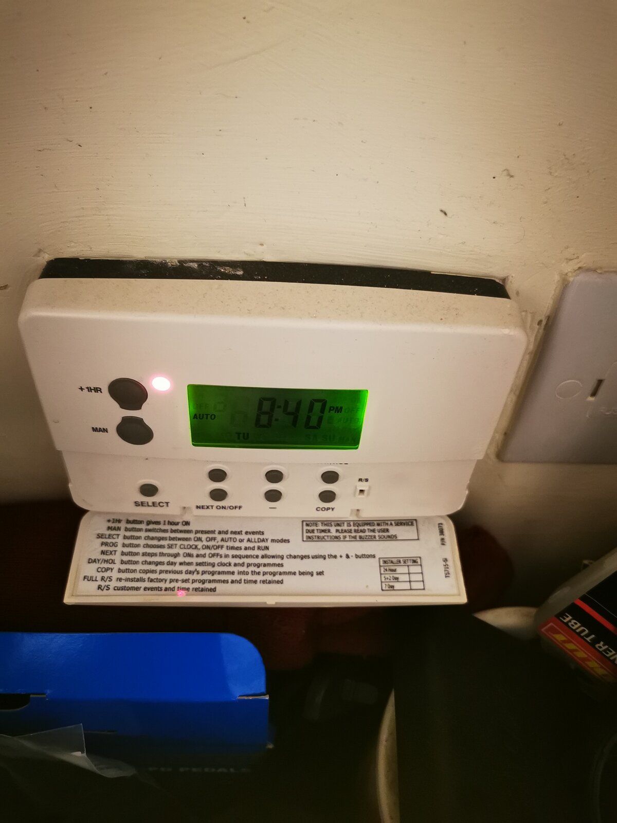

It’s not that complicated, the hive controller replaces the existing programmer, the wall thermostat is shorted out and the hive wireless thermostat communicates with the controller.
You don’t need to go into the wiring centre, it can all be done at the programmer end unless you want to disconnect the wall thermostat

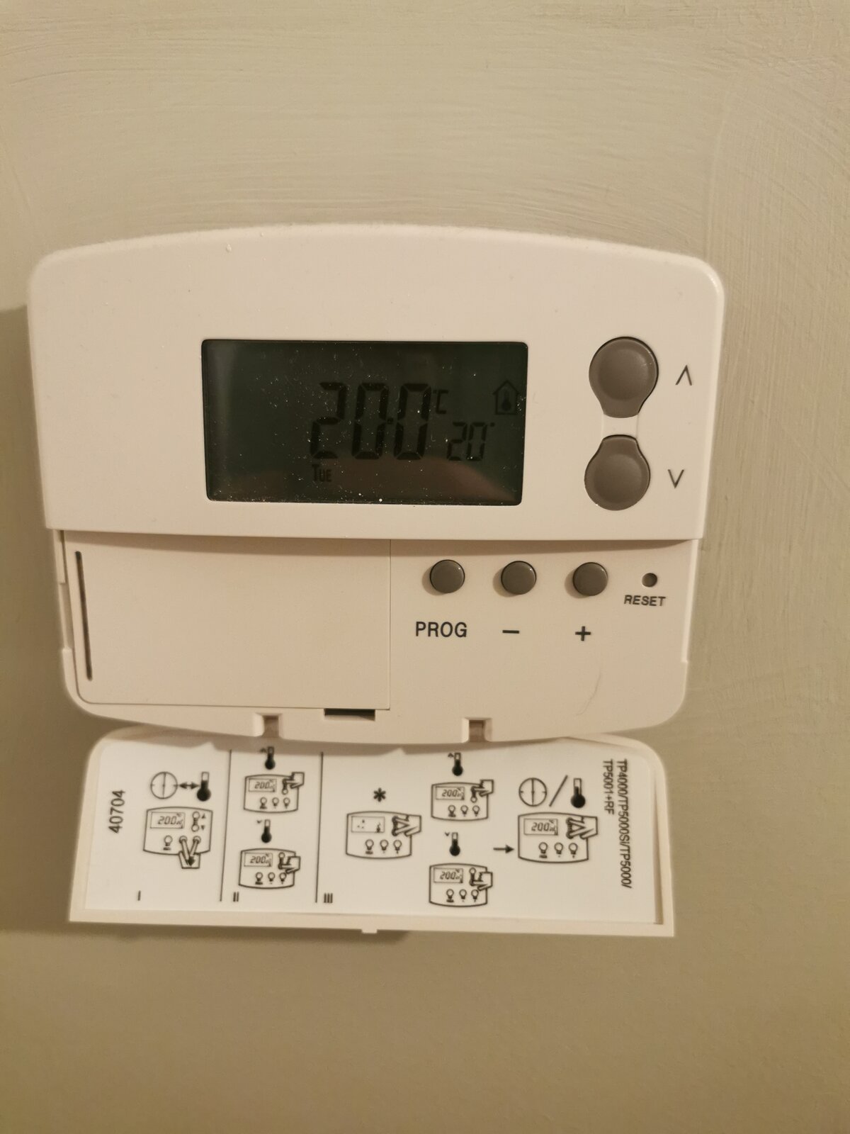

So the programmer is integrated with the thermostat. It's a danfoss t5000 if I recall.
We have 2 of them, and then a hot water controller all of which are located around the house.

Hi all,
Thanks for any info in advance. View attachment 210102 View attachment 210102 View attachment 210103
Not so simple if you want to convert to hive, you will require one dual channel and one single channel set up, they will work together regardles of what someones mummy wanted
