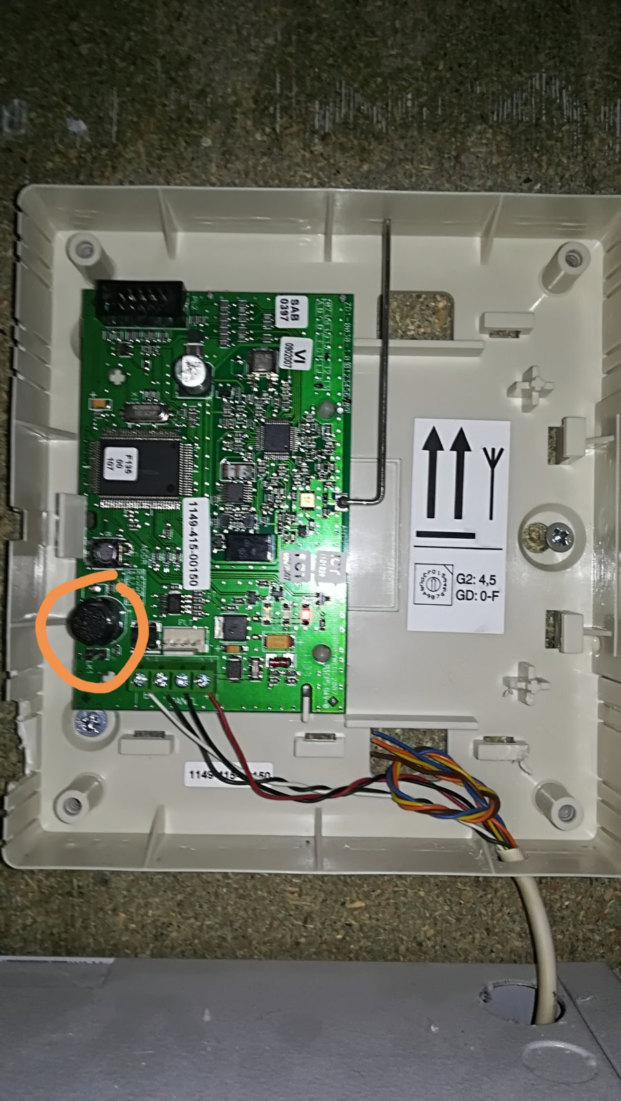

I'm not an engineer but I've found my way around our alarm system fairly well using the manual. I cannot get out of engineer mode. I've entered the engineer code and pressed escape, it checks for tampers and finds 'RF Module 4'. I think it might be something to do with the fob but I am not sure and unable to find out for sure and how to clear it.

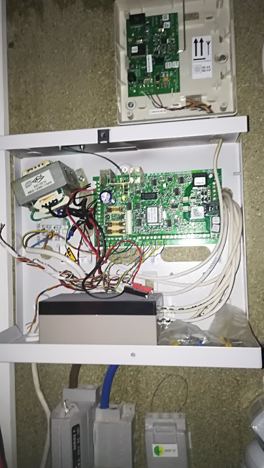

Hello
folks. I hope these photos are helpful. G
Ah! Right, that'll be this then

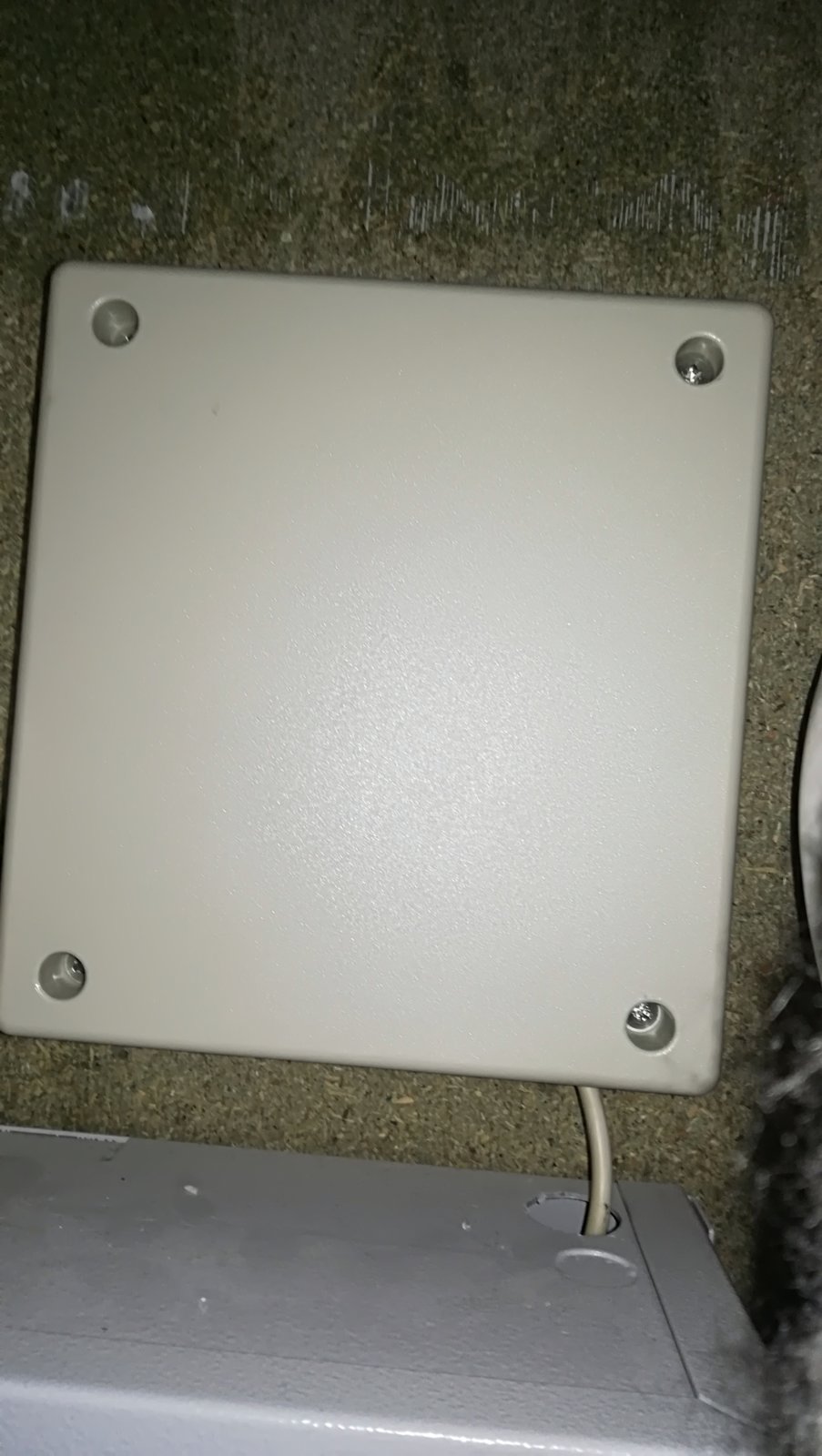

Done that now dude

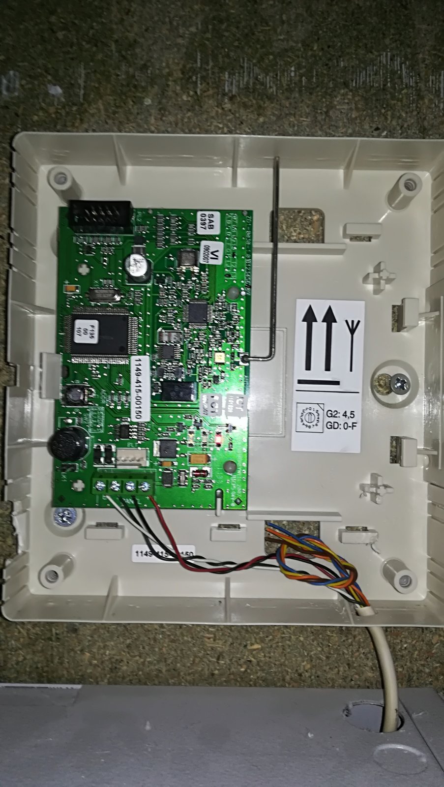

Also removed the cover from the power control too in case that's useful.

Didn't say that ! Anyway looks like the spring is missing off the tamper switch ( see posted picture and your picture ) black button, unless the later ones are different and there's a moulding inside the lid ?
Ha! No, you didn't
I see what you mean though there should be one in the area I've circled in my picture. I opened this firstly over a year ago and that's probably when I lost it. I'll have a rake in the cupboard, it may still be there.
I think you've solved my problem Sparky! Many many thanks Wish I could get you a pint
Aah, I didn't know about that. Certainly will. I still have to get a replacement spring and it needs a 'user reset' again but my wife can unset using the fob which is good for now. Thanks again dude
