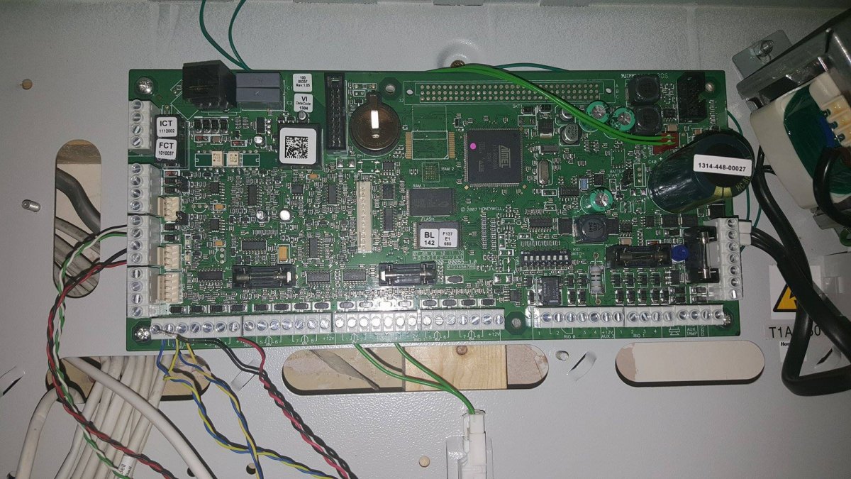

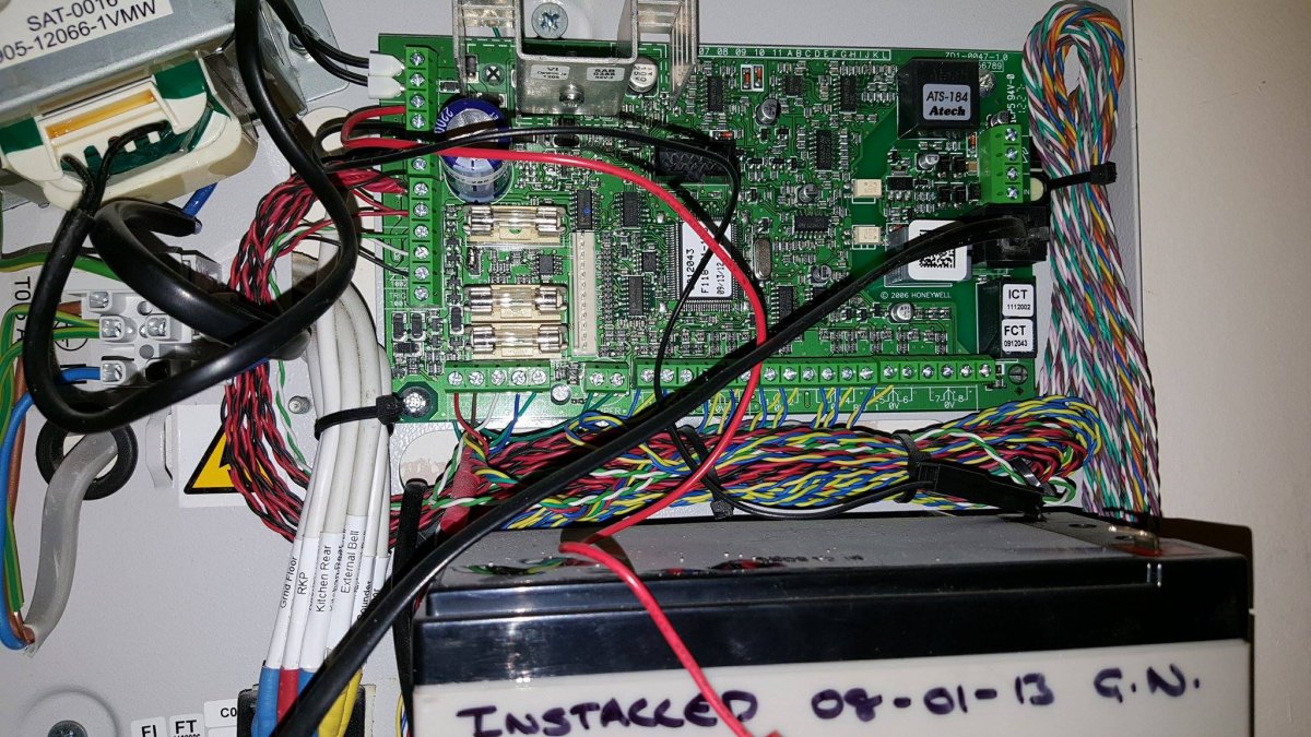

Hello everyone - I seemed to have bitten off more than I can chew. A couple of years ago we had a Galaxy G2-20 installed, I recently decided to change that unit out for a Galaxy Dimension with an separate Ethernet module. The mistake possibly was thinking I could do it myself.
Below is the steps I've taken so far:

Wrote down and took photos of the G2-20 wiring
Removed wiring
Removed unit from the wall

Connected the MK7 to the RS485 line 2
Power up and all works OK
Now I want to start connecting up the inputs (PIR's & 1 door sensor), the outputs (internal bell & external bell). However, the 2 issues I'm having are, firstly the G2-20 had a negative on the AUX power, yet I cant find any negative on the Dimension. Secondly, I cant work out how to connect the internal and external bells. I have included the photo I took of the G2-20 before removal and the new Dimension installed. If anyone can help I would really appreciated it?
Many thanks

Would guess the bell is Rio 0 as per old galaxy's 1 being bell 2 relay strobe and aux tamper being tamper return, 12 v and ground being the power at a guess
Galaxy guy is probably the person to ask
You're right Mark. RIO 0 output 1 for siren trigger and 2 for the strobe relay. The siren tamper return is marked 'AUX TAMP' on the PCB (second from right on the horizontal terminals) and the negative is marked GND (furthest right on the horizontal terminals). You need to add a GND(0V) wire link to the common on the volt free relay contact common terminal.
There are plenty of outputs and they are programmable. If the internal siren doesn't use too much current, then wire it's positive terminal to +12V and the negative terminal to one of the free outputs, then program that output to bell. If you want the internal sounder to keep on sounding once the bell timer has expired, then program it as strobe or intruder.
