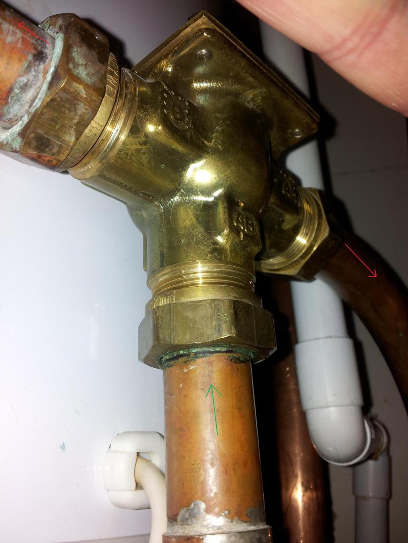

Your cylinder needs to have another valve between your diverter valve and the cylinder. It is a safety shut off.
One was supplied with the cylinder, so there isn't an excuse for the installer not to have fitted it.
