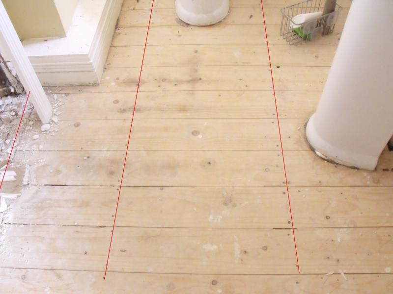

Richard, I have marked the poisition of the joists in the photo below.
The joists are 1.5" wide. I assumed 2 x 4 but as you see from the pic the boards are so close together that I can't see whats beneath them nor get a tape measure down them. I didn't want to start lifting them as they were in such good nick.

So you haven’t actually had sight of the joists? You will need to lift a few boards, say every 5th one, to check where pipes & cables run but you may establish this by lifting jut 2 or 3 boards; this will also allow you to measure the actual size & span of the joists. It’s fairly important in both cases.

Richard - Thanks for your continued help. I can't get the frigin boards up. They are toungue and grove and the buggers won't budge individually. There was one board where the toungue wasn't in the grove one one side but as soon as I tried lifting this board it started to break the addjacent board.
Can I not find where the pipes / cables run using a metal/electricity detector and overboard with the Hardiebacker 500 or aquapanel? Surely I wont need anything more substantial than that will I? I don't want to cut corners but I can't see anyway of getting the boards up in one piece and because they run into the main bedroom and under the stud walls I am not confident in pull them up completley.
