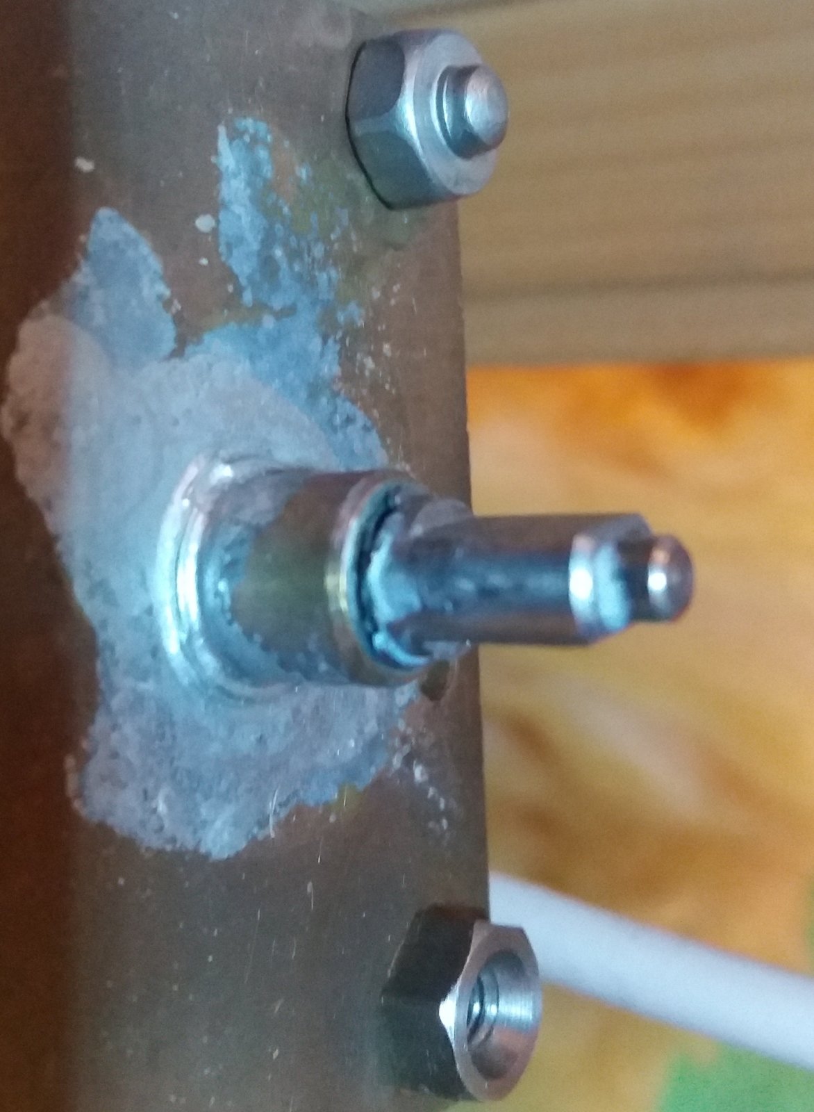

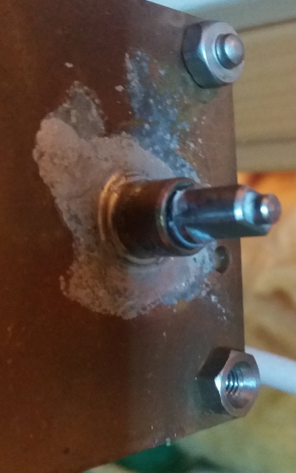

Hi again flameport/ericmark - Some further points following your much appreciated input. Firstly, I have now accessed the spindle which you mention. The spindle does indeed turn by hand albeit only by a few degrees. See attached file showing the spindle at its two most extended positions. Feeling the apparently limited travel of the spindle may be being prevented from opening further, I took a small pair of pliers and with a bit more force tried moving the spindle further but nothing dislodged allowing for further travel. Unless you guys report that the spindle should travel further, I'm inclined to feel the spindle is working okay?
Whilst the motorised head was removed, I took the opportunity of looking inside to see if any bits of broken cogs or springs were present. All appeared as it should. However, prior to removing the head, I had learnt previously from a youtube clip about checking the manual lever on the head for resistance then watching to see if the lever returned from manual position to auto. This it did regardless how many times I tried it. (At that point, I felt happy that at least something was doing what it was supposed to) Now, with the head removed from the spindle and with access to view inside the head, I moved the lever to watch as the gears meshed and springs operate. This worked fine and I saw how the two points engaged with the micro switches just as it had on the youtube clips I had watched. Satisfied all was good, I began replacing the head to the spindle.
Recalling a youtubers advice, as I gently aligned the head to the spindle, I moved the lever from auto to manual. (This as you will probably already know, the better to allow the spindle to locate and align itself without undue force or incorrect seating) Now with the units two locking screw in place, I again moved the lever from its auto position to manual expecting the familiar resistance. Nothing! There was no resistance and the lever stayed wherever I left it. Despite being certain I had the head & spindle aligned, I removed it again and could see immediately the contacts were still engaged with the micro switches. I then inserted a screw driver at the point where the spindle locates and turned. Sure enough the gearing worked and the contacts disengaged from the micro switches. The problem which now appears to be the contacts are not backing off from the micro switches - new powerhead? I am unsure if this is the cause of the initial issue or just something to cloud the issue.

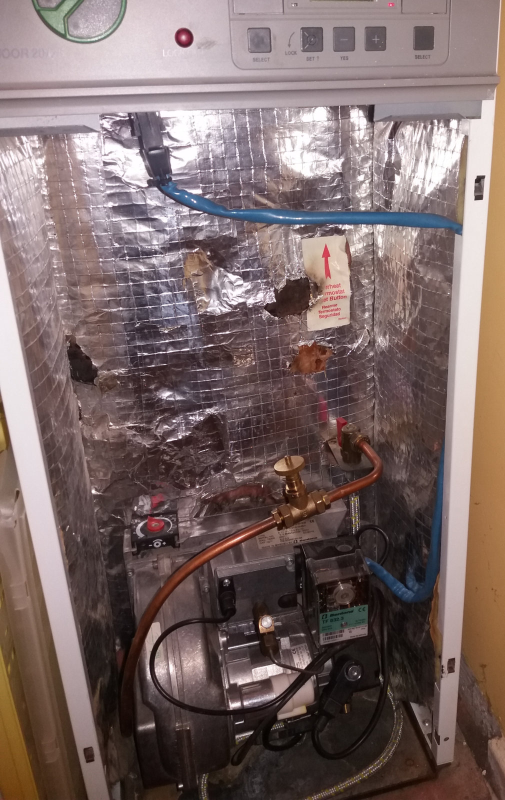

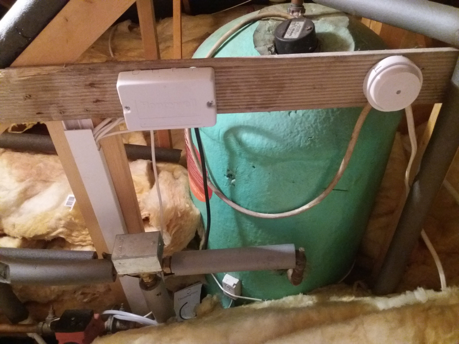

Ericmark - Thank you for your thoughts. Your efforts deserve a better answer to your question concerning ''what system is used'' I have uploaded a photo of the heating system located in my bungalows attic but suspect you mean Y C or W of which I haven't a clue? Any pointers to help me. determine which I have. Also aattached is a photo of the boiler itself and its programmer.
Concerning micro switches inside or at the back of the boilers programmer - there does not appear to be any. Following the powercut we had, when power came back on we noticed the boilers lcd had disappeared. I replaced the programmers small 10 pence sized lithium battery and even I was surprised this had the desired effect and the display came back on. Looking back, coincidentally, it was onwards from then this issue began :(
