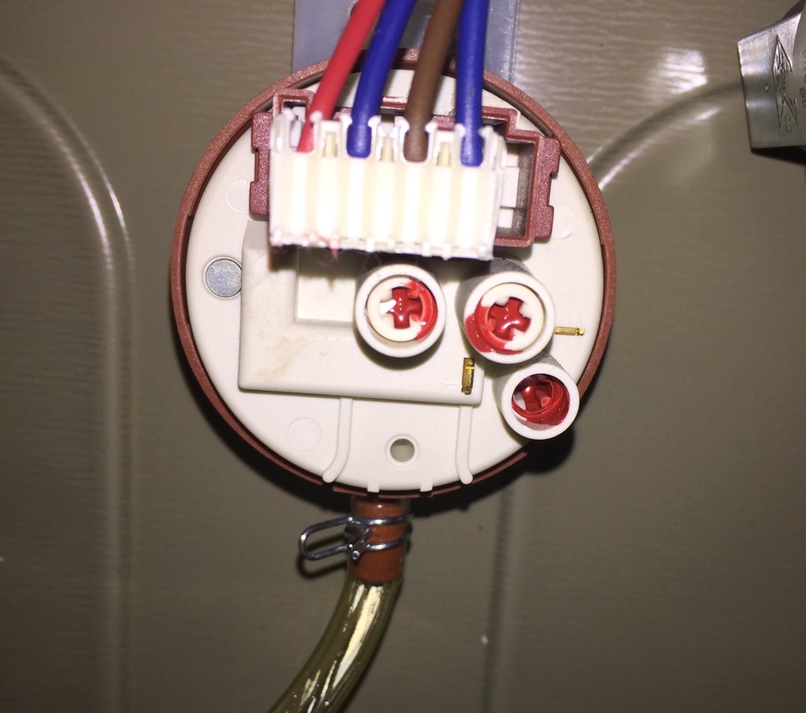

Now and then i get the error F05
Im taking the top off to take a look.
If this is the pressure switch then I can blow down it and here a gurgling sound.

Error F05 means the pressure switch did not operate, if you now cannot get the machine to rinse & drain it suggests that there may be a blockage/ contamination in the pump body. If you have stripped & cleaned it all then it may need replacing.
Hi,
If the code is for pressure switch would an issue with the drain pump cause the pressure switch not to operate and show the error message.
Nothing happened when I selected the pump out cycle but hitting the drain pump with pliers then the drain out started and machine emptied.
The switch is operated by air pressure created by water in the pump body going up the thin pipe to the switch.
