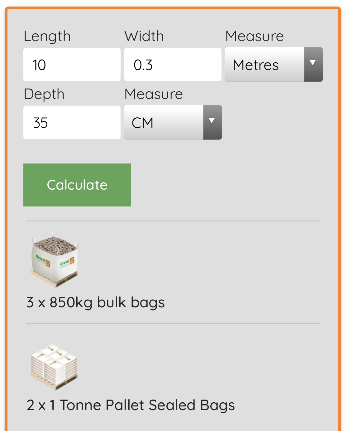

Looking for some help on how bulk bags of gravel I need?
Its for a french drain sizes below
Length - 10m
width - 50cm
depth - 50cm
I will need a layer of gravel 15cm, then the pipe laid on top (PERF LAND DRAIN 110MM), then back fill the gravel for another 20cm (35cm in total)
I found and online calculator with a gravel company... put in the figures and it calculated 3 bulk bags?
I did change the 0.5 wide to 0.3 wide as prior to that it was 4 bulk bags (3ton)
I thought that was extreme, how do you work it out?
Had a look just now looks the same as the others I have tried 3 Tons
I just imagined cutting a bulk bag into 9 like a # and thought that would be close. Although when I read the post I thought the trench was 35cm wide :LOL:
