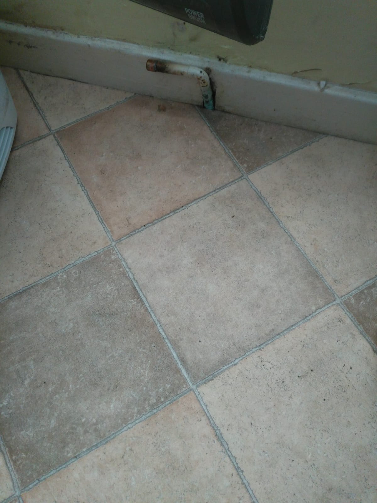

Hello all,
My brother has just had a new boiler fitted and the gas engineer routed a new copper pipe directly from the meter to the new boiler. The old copper pipe that fed the previous boiler came from under the concrete floor, where it tees off to feed the gas supply for the cooker. Although the engineer capped this off above the floor, it started leaking soon after he left. He's come back, dug up the floor and repaired and tested it now but he isn't available for a good while now to repair the floor.
Can the small section of pipe (see pic attached) be simply taped up and concreted over please (as suggested by the engineer) and if so, what sort of tape would be best in this situation? And is there a synthetic alternative to concrete please, as i've read that concrete can corrode the copper in the future? As you can see, it's just a small section of the floor, which will be covered with lino, so the appearance of the finish is not an issue.
Thank you in advance.
I would ask the "engineer" to disconnect the other end of the pipe to ensure that his dubious soldering skills to not result in yet another leak under the floor. The vibration from hacking into the concrete could have affected any other joints along the buried pipe.

Leaving a live but redundant gas pipe buried in concrete has a higher risk of an adverse incident than if that same pipe was no longer live.
We dont know what was discussed with your sibling,maybe he as a responsible person can discuss this subject here himself and offer more information at what was discussed on site.
The installer returned and rectified the fault,what was discussed on site with your sibling we will never know but please consider the original job is complete and any other work which includes defective concealed pipework will have conditions ie customer to employ their own operative to make good.
kind of doubt the original installer (being busy its winter) will ever want to return and he will not have X ray vision.

Thank you all for your replies. Yes, he is Gas Safe registered and I watched him test the work he did. He seemed a little confused about why it had started to leak and asked my brother or his kids had touched the pipe, which they hadn't. Anyway, i'll get some Denso tape and get the job finished.
P.s. And yes, the pipe is not redundant!
