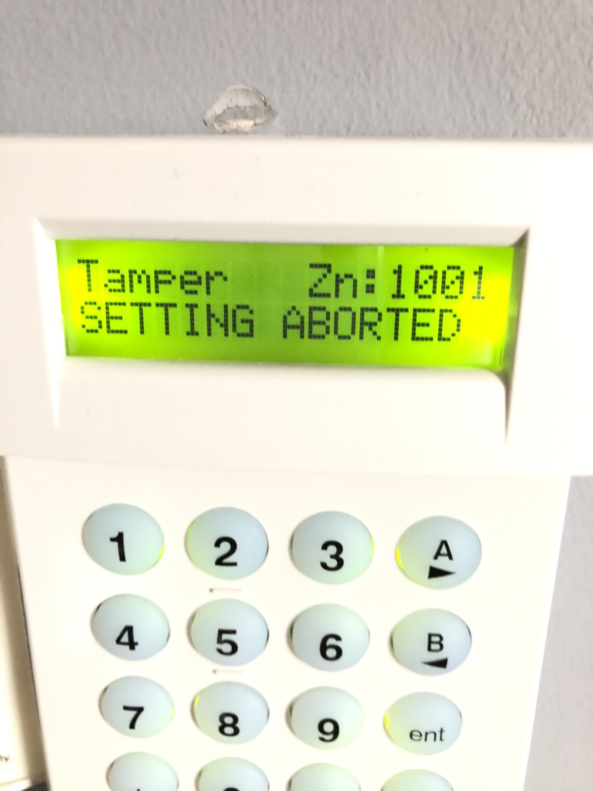

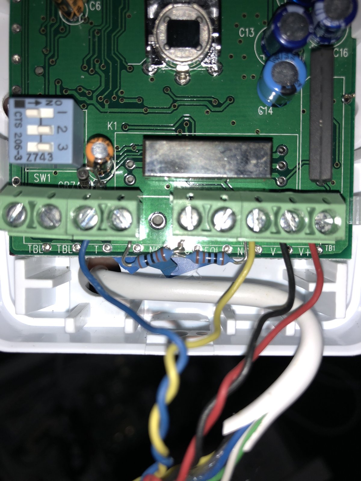

You will need put resistors in all other zones as well or they will show as tamper too
No green on its own
White and yellow together

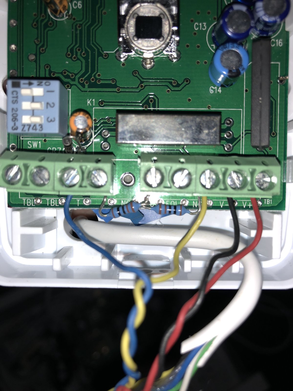

Green on its own
I want to wire it like this PIR this was Done for me by ADT
The pir is right just for an example u r only using this one pir put the blue and yellow into zone 1 remove all other zones just wire that one and go from there
Just wire up and if any other zones show up u will put in panel

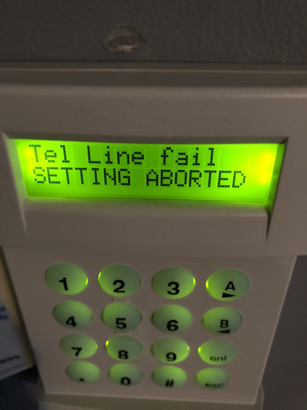

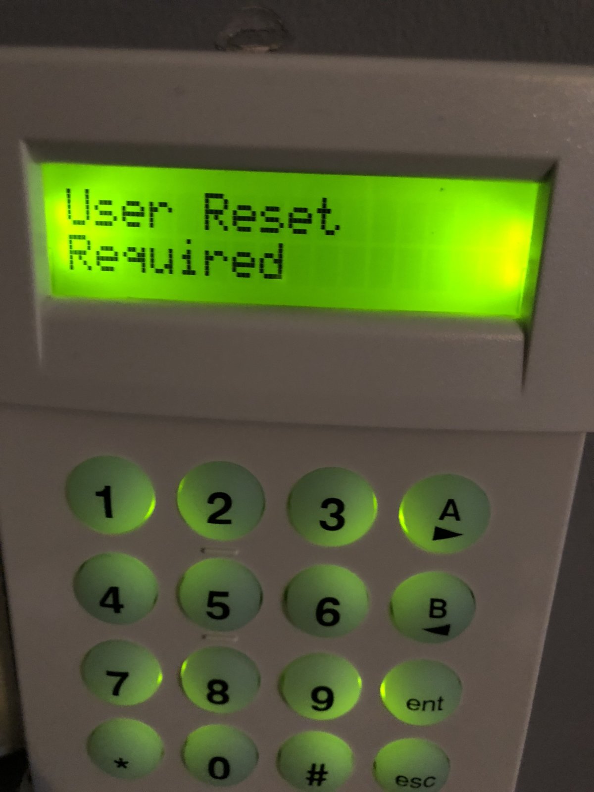

Hi Neil I keep getting this messages along with user reset required?
If it is go into engineer mode at set zone 1 as spare see if sets after that

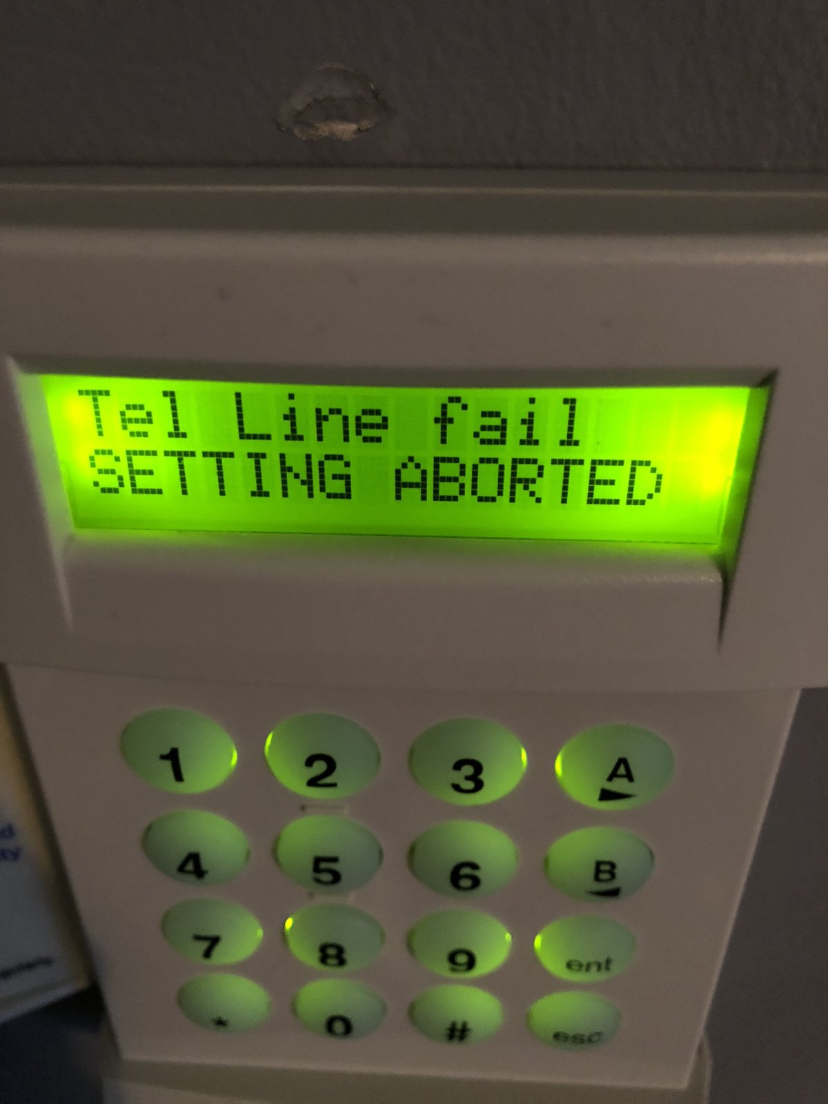

This all comes up now

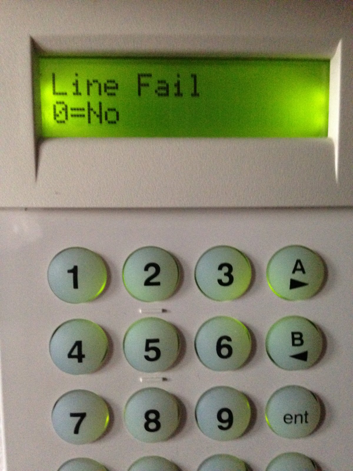

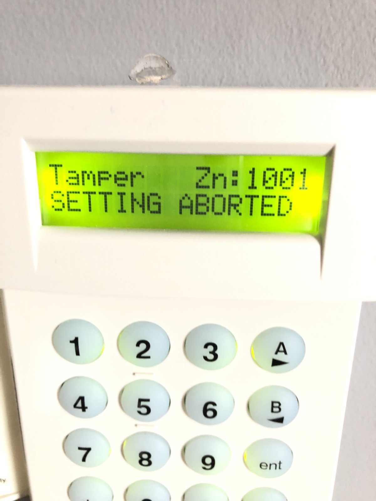

User reset is your code

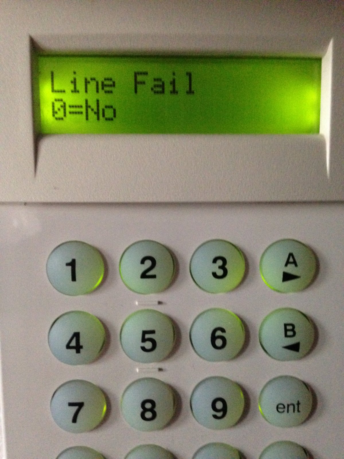

When u disabled line does it now look like this
