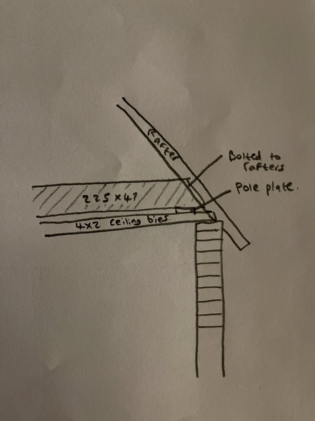

Pretty much as the title. Going to be putting 225x47 joists in the loft. They will sit on external walls and mid point on supporting walls below.
Mid way in my loft is a massive 300mm steel that will be not used in floor support, but obviously I want my joists to sit fractionally above this.
What's an appropriate method to raise these joists? Brick? Wood bedded onto the walls?

Wall plate on external walls that the current 4x2 ceiling joists sit on. Nothing on the mid point supporting wall. Just brick that sits level with the lath and plaster.
As I'm typing I'm realising that raising the mid point supporting wall 75mm merely requires packing of some sort. But raising the external wall plate is going to be an issue with roof slope. I.e there will be no gap for a bearing of the new joist o_O
Ok so is it a hip roof? If you are trying to get over this you can build up the central wall .
Pole plate with your new floor joists cut to the pitch of your roof, and then bolted to your rafter feet whilst sat on the pole plate. If that makes sense?
Is this what you’re on about. Got my crayons out.
