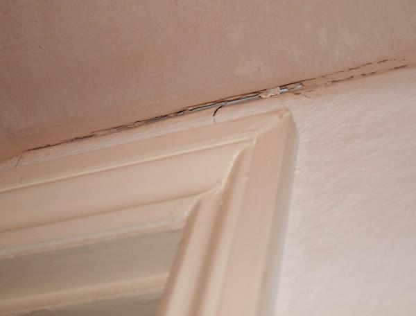

Hi Guys
I've just had a ceiling replastered. You can see from the below pic that there's a crack in the plaster at the edge of the ceiling. What product would you recommend to fill it?
Thanks :cool:
Looks quite a big crack for a newly plastered ceiling.
Normally when wall and ceiling are both done, a tape is used to help strengthen the join e.g. Scrim. When only doing one, it's not always there. For your case here, it could have been used before plastering the ceiling and then easi fill to blend in to wall.
If you don't get much joy on the post, ask the mods to transfer to plastering forum. Don't duplicate tho.
