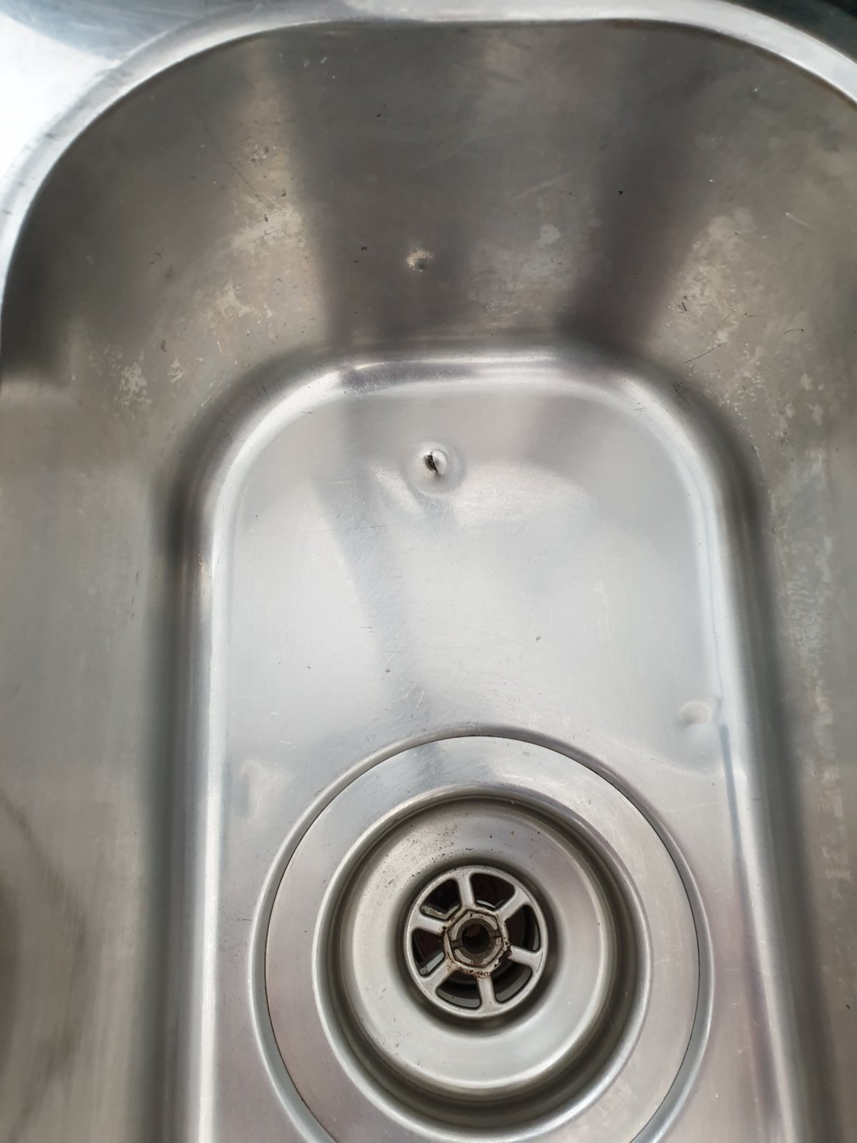

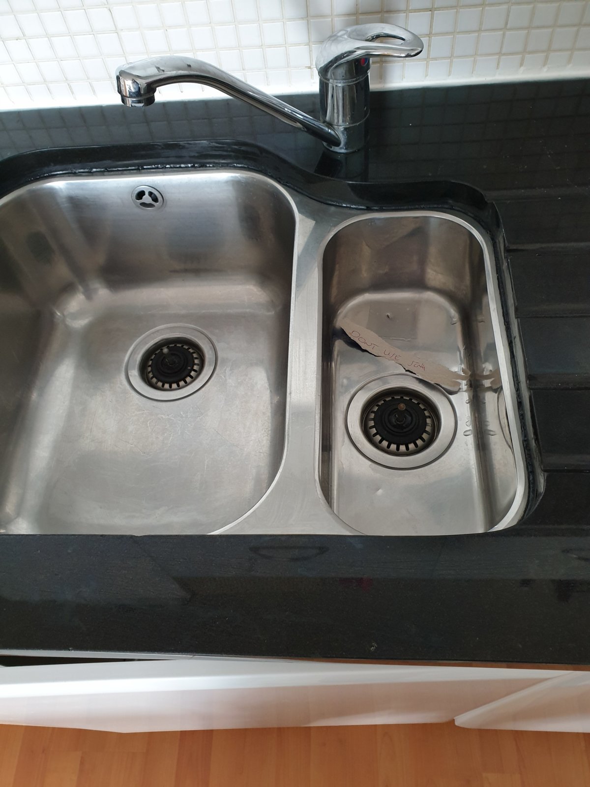

Managed to get a small hole in the kitchen sink (see photo), which is leaking underneath.
Unfortunately the sink can't be easily replaced as it's fully integrated within a granite worktop.
Just wondering what's the best way to repair this?
Would applying plumbers mait underneath the hole keep it sealed and water tight?
Any suggestions and/or product recommendations would be appreciated.

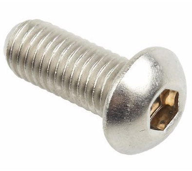

Put a suitable sized stainless steel dome head bolt through the hole. Ensure it covers all the hole.
then a tap washer ( if large enough ) , a metal washer and nut under the hole.

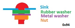

dome head bolt
A stainless roofing bolt might be slightly better, being slotted rather than having a hex recess to collect gunk. A stainless carriage bolt would be even better having nothing on top, but then underneath you'll need to use some sort of bushing rather than a washer to 'miss' the square bit before putting the nut on. Multiple washers is a bad idea.
Either way, shouldn't the rubber washer/gasket go above the sink, or it will still weep through the threads?
Yes it would as a long time / permanent repair but would require the hole to be made ( roughly ) square.
Putting them under the sink keeps the height of the bolt head as low as possible in the sink. For a quick fit temporary repair the amount of water wicking along the thread would be managable

Fitting a new sink is a definite no go. I've had plumbers out before and they advised it could cause more problems because it is so tightly fitted.
It's also the smaller and less used sink of a 2 sink configuration.
Ideally looking for something semi-permanent for the time being to last at least a couple if years and needs to be non-toxic solution/substance as it will occasional get used for washing dishes.
The hole is very small so keen not to put a screw through it if possible.
It would be good to try to decide on the best solution based on the above. Many thanks
Perhaps tap it flat using a hammer (same as a panel beater would) using a couple of hammers - one on top held flat and hammer from below to get it back to shape
I'd do this first to make the hole as small and inconspicuous as possible and then i would use araldite or chemical metal to seal the hole from underneath. I'd probably bond a steel plate or similar underneath as part of the seal to give the repair some strength.
