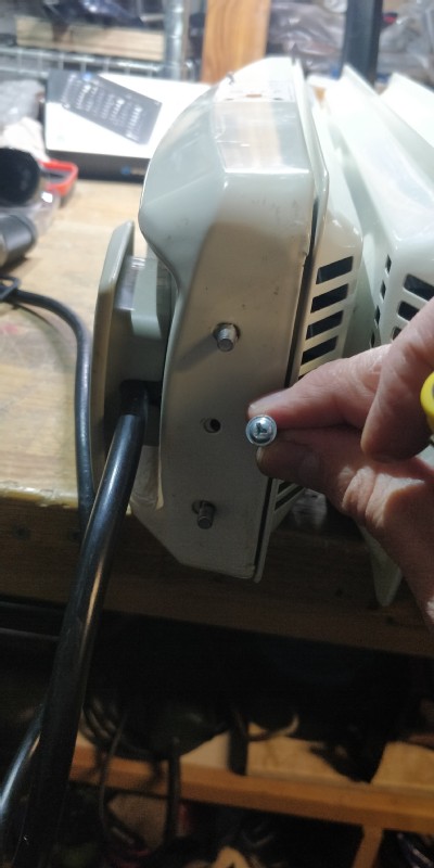

I had the same problem - puppy chewed the mains cable (luckily not while in use). On my model you needed a special "tri-wing" screwdriver (like a triangular Phillips I guess to stop you taking apart - I had one a bit too small in an ifixit kit for electronics) on the bottom in between the two wing nuts. As my largest tri-wing was on the small side I gave it a squirt of penetrating oil first as I guessed I had one shot not to strip the head and it worked. You could feel the whole side was now free at the bottom but the threaded rods for the foot wing nuts still held it on.

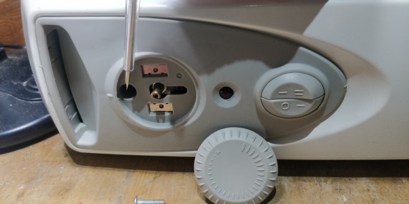

There was clearly a bolt at the top holding the side on, but I didn't have a plug hiding a screw as described above. I carefully levered the temperature control knob off the variable resistor spline, which revealed a deepset Phillips bolt head. After that it was exactly the same as described above. All other screws were Phillips.
Looking around for some flexible 13amp armoured (puppy proof) cable.

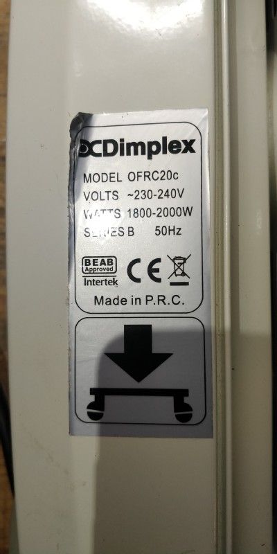

Dimplex Model OFRC20c 1800-2000W
Stupid tamper proof screw. You could just cut the head off. I replaced with a phillips screw - guess you could have cut a slot instead.
Temp control knob slides off. Location of deepset bolt.
Back of temp control - deepset bolt moulding above variable resistor.

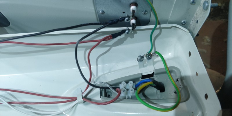

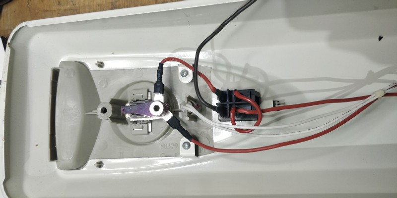

New cable installed. Terminal block can pop out to ease wiring in new cable. 2 lugs clip it in. Earth requires crimped ring.
Tested continuity from plug pins to heating element / earth tested entire rad. All working - thanks everyone!
