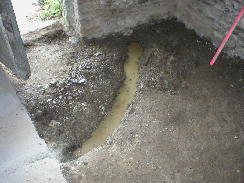

During the work on the dirt floor, the builder told me that one day, after a period of heavy rain, a trench that he'd dug across the floor (removing an old soil pipe) filled with water. A french drain was put in along the front of the property, and the water disappeared. We've now got french drains along the front and rear of the place. But not down this end wall that is so damp now.
I am guessing that the installation of the damp proof membrane is forcing water out sideways, and its leaching up the wall. Does this sound plausible? I am hoping that a 3rd french drain, down the length of this end wall will cure it. However, I hear all sorts of opinions regarding whether or not rising damp is a real phenomenon or not! I don't think that injecting a damp course is an option given the higgedly-piggeldy construction of the wall and its immense thickness.

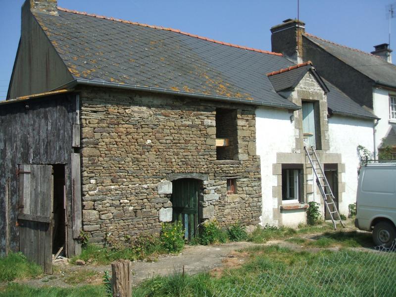

Firstly, it was a mistake laying a retrofit concrete floor in a property of this type. This will displace water from the floor area and push it up the walls under hydrostatic pressure. The granite, if that's what it is, is highly resistant to moisture so you can guarantee that if you have a damp wall then the moisture pathway is the mortar joints.
As a general rule of thumb, no DPC in the wall so the internal finished floor level must be 200mm above the external finished floor level.
Another mistake was made in your approach to dealing with the wall. These walls are built on the overcoat principle, which means they are meant to breathe and go through seasonal wet dry cycles. It was ok or render with lime mortar as this is breathable but then you render a good material choice useless by coating with an impermeable paint (Weathershield).
The lean to which was demolished was clearly responsible for the damp in this wall so ironically, demolishing this structure would have led to a natural improvement in conditions probably within 6 months. The reason for this is that wall base ventilation is critical to ensuring these structures remain dry. Build a structure against a wall that inhibits natural ventilation and you will almost assuredly experience damp conditions.
Rising damp does exist as a phenomena but its incredibly rare and even you have it then chemical treatments are completely inappropriate for that form of construction. Interestingly rising damp can rise to higher heights in thicker walls. French drains can help if you have a high water table. Dig a small trial pit down to foundation level and see if this fills with water percolating through from the water table, whatever height you get in the pit is the height of the water table at that time. If it remains dry then the water table isn't really a problem and French drains are unlikely to help, even in France.

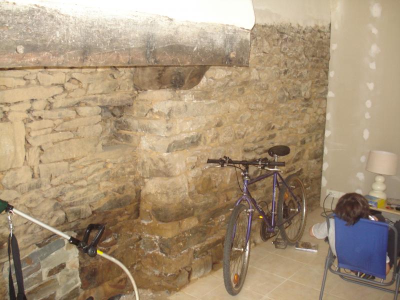

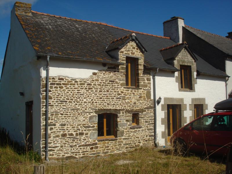

Doug, I would strongly recommend a mineral silicate paint for the lime plastered walls. They have the benefit of being both breathable and durable. Untreated lime plaster will have quite a dusty surface even if treated with a lime wash. You also have to accept that lime plaster has a downside in that it does stain rather easily. The mineral silicate paint should improve all these issues.
French drains sound good given what you have described relating to the water table but do if at all possible reduce external ground levels to ensure they are a minimum 200mm below internal finished floor level. I'm unsure what you have decided to do about the retrofit concrete floor slab but assume you are keeping it. If that is the case then I'd be looking to increase wall base ventilation even more than 200mm. I am concerned that you have built in a problem here that will cause long term damp problems with the walls and the only defence you now have is external wall base ventilation, the more the better.
If the render is very old I'd hack it off for planned replacement anyway. Give it maybe 3 months over the summer to ventilate then plan to replace the render around August time before the bad weather starts to set in.

The original dirt floor (before digging out and putting in DP membrane and concrete floor). The trench is where a soil pipe was taken out. Then after a few days of rain this happened.....
Here's the outside of the place before we started work...
And here it is today (the end wall is the one with the damp):
Finally here's a good shot of the damp wall:
