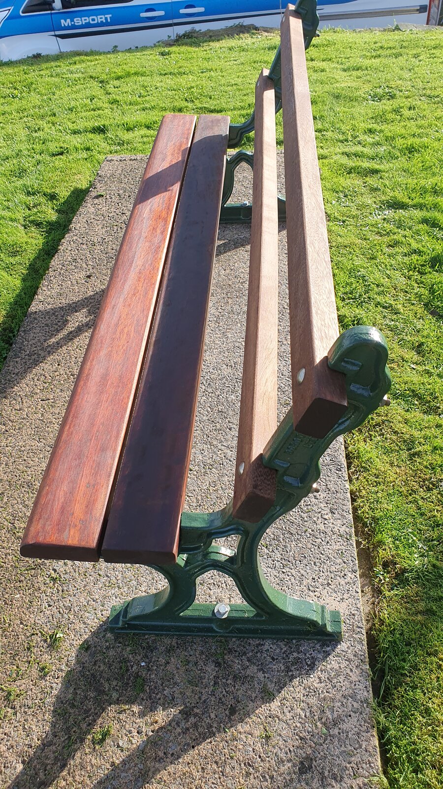

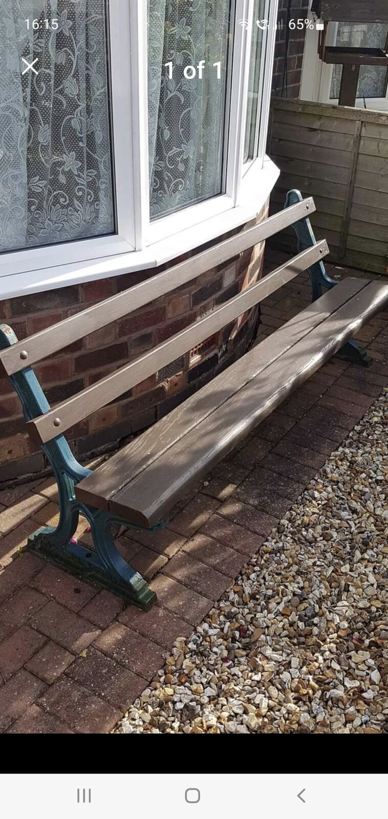

The first thing I used the sander for was this bench I bought on facebook for £50. Hardwood, painted. Although I resorted to the belt sander for the damaged sections on the seat that were obscured by the brown paint. Finished it with tung oil.
But now I'm doing some softwood pine where I need to go a bit easier and I don't think I'm getting the most out of the sander because I'm not handling it properly. I'll try a slower speed and see if that helps.
