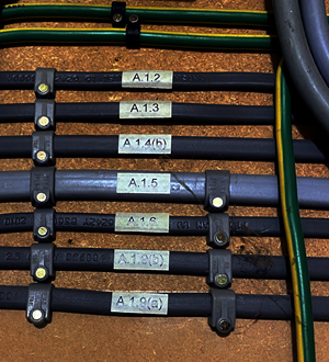

I do (in my 'domestic property') :) ... but only on the backs of the accessories, so not normally visible.
Most cables are also similarly labelled, but again not usually visible, the one exception being in the vicinity of some of my CUs/switchgear etc, where the labelling is visible (not very good photo!) ...
Kind Regards, John
