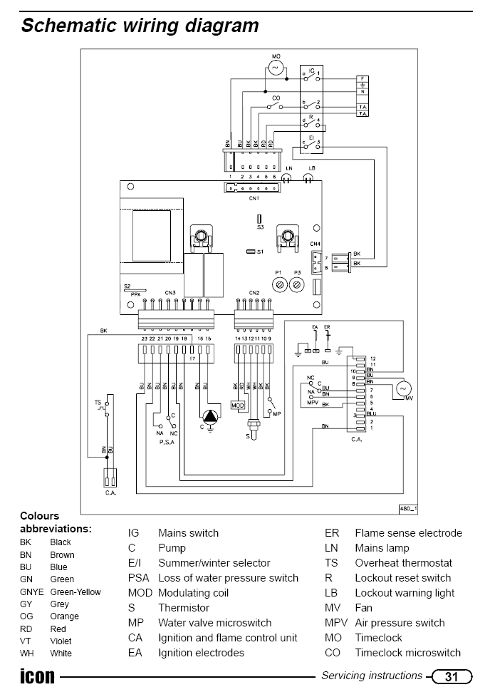

An Update! I isolated all the power, water and gas and took the front cover off. This led me to the source of the smell and "sparking". It's what looks like an oversized,blue, spark plug, with a copper feed going into the bottom and power going into the top. I assume this creates the spark. The top (power end) is completey burnt out, melting plastic....all that fun stuff.

It doesn't appear to be mounted on a PCB. It seems like a screw in unit with a fitted cap / power lead on the top (which is the melted part) - sort of like the leads you'd fit to the top of the spark plug in a car. I'm obviously not going to attempt a swap myself, but as far as I can see nothing else is damaged. What does worry me is that the melted part was all of 5mm away from the Pump power lead - glad I caught it when I did!
asked for price for pcb for one of recently and they retail at £250 plus vat from hrpc (special order) u could try heateam (gloworm) as they do fixed fee repair that can work out cheaper.
the part u are talking about is the low pressure water switch, hrpc sell them about £50 they leak into the 240v electrics

Ah, that makes sense with the clicking I heard. I assume this basically kept telling the boiling one thing, shorting out and telling it another. Is it possible this is an isolated problem or will it have knackered something else in the process?

Here is a picture of the part if there is any doubt.
As CG says thats the low pressure water switch.
Its a bit difficult to get to but you could change it yourself if you have enough skills. You will probably have to reterminate the leads as well !
As a VERY short term solution you could connect the leads to the working position if you knew how but thats not recommended when the part is easily available.

I've worked on pretty much everything I've ever laid my hands on, but I've always stayed away from boilers fro 2 reasons. The first is it's my first house so I've never had reason to. 2nd is gas scares me a little, I'm good with wires -- but if I can't see it I'm a little weary. I do think I could swap it out myself, but if anything does happen to go wrong I don't want to be the cause of more damage.
Heat Team is Baxi/Potterton Icon is GlowWorm - HeatCall!
I've had a local corgi out to this -- but since he can't find a wiring diagram anywhere, I fear he's done a bit of a bodge job. Does anyone know where to find one?
