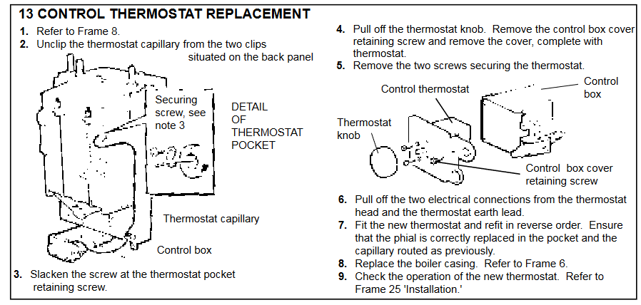

All Ideal Classic use the same thermostat part no 137658
Perhaps I'm missing something, but I can't see anything in that link that looks like a control-stat.
Got this from the boiler manual. No idea whether it's still available (if that's the problem)

fixitflav. Trouble is, I'm not even sure the problem is the control stat. Could be the gas valve or anything really, but definitely in the boiler. I could end up changing everything, including the drop down front panel which dropped off years ago! The burner is also showing its age with lots of rust, as it is mounted on a single skin outside wall in the garage, so moisture gets in all the time. Bottom of the boilercase looks like it's covered in gravy granules.
