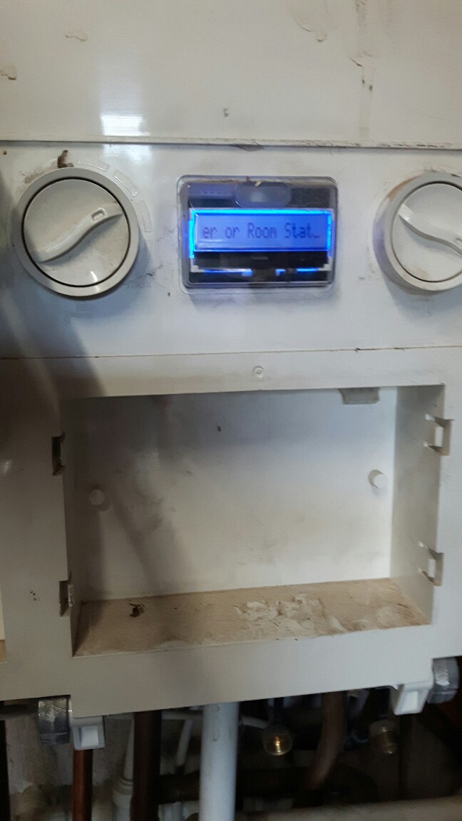

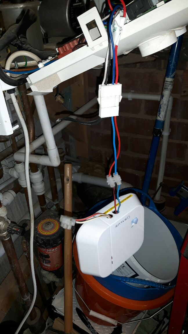

Whave a ideal logic combi 30, tried to fire it up yesterday to no avail, this morning things I have checked:
Pressure nearer 2bar than 1.5
Salus rt500rf is reciving the wireless signal and showing the green light, also using a multi meter on the thermostat wires shows continuinty.
I have bridged the 2 black thermostat wires and the display still shows - timer or room stat off -winter mode
Any ideas where to head next?
I have c&g 330 but its not very often I have to use it
Ta Ray

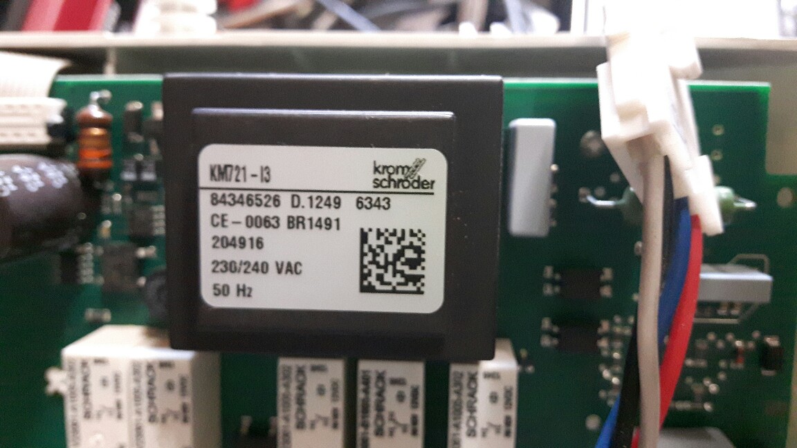

Have power up to the pcb, when I switch off or do a reset it goes through the fan purge etc
The pictured part on the pcb is quite warm

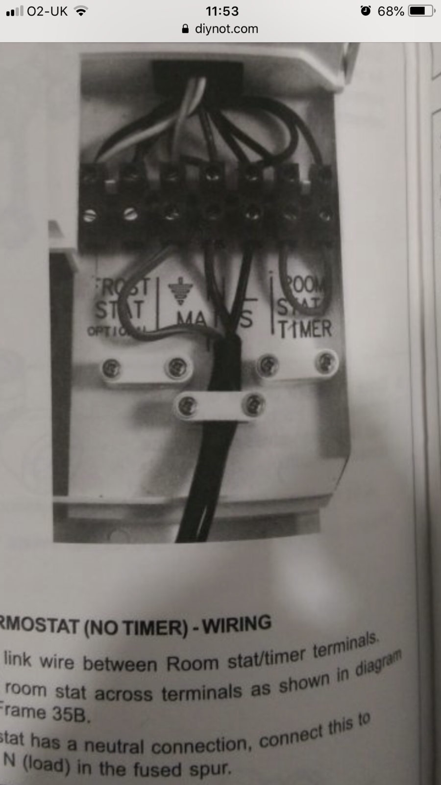

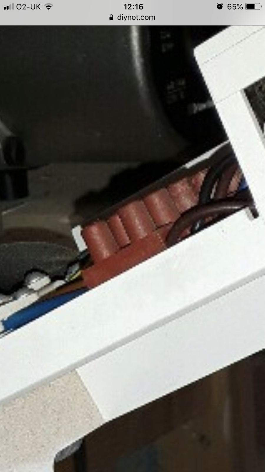

If you’ve got power and you linked the thermostat out correctly in the boiler, I’d try the control knob
Ok, sounds like your thermostat isnt linked out properly.
It’s possible now you’ve linked it out the right hand link in my pic is missing

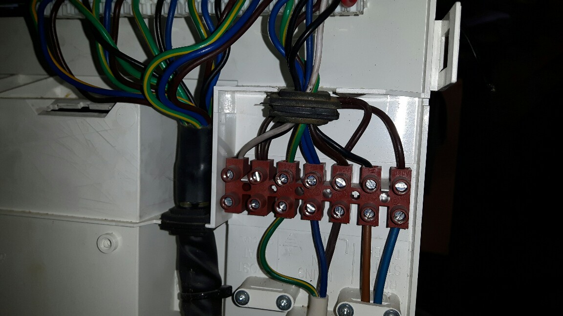

Take a pic of the brown power block from above
