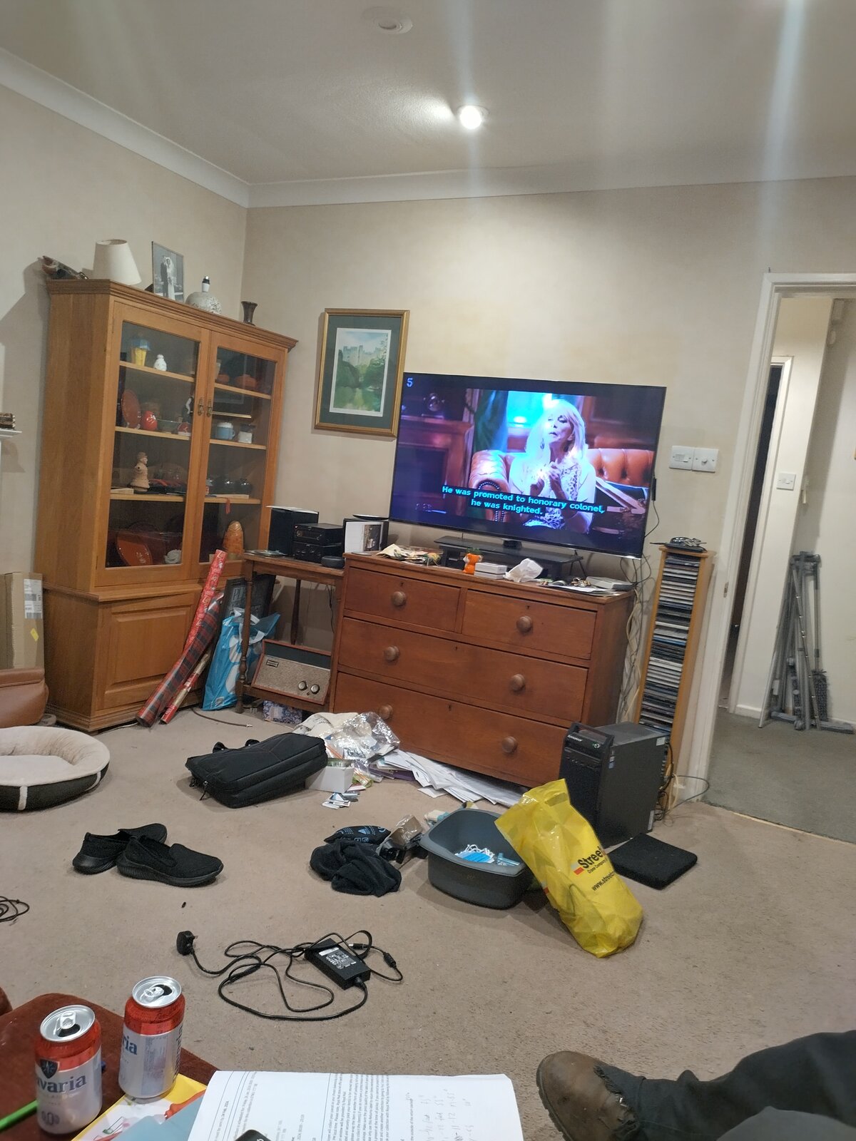

This is what the current 48" TV looks like. Excuse the mess, we are in the middle of a big sort out.

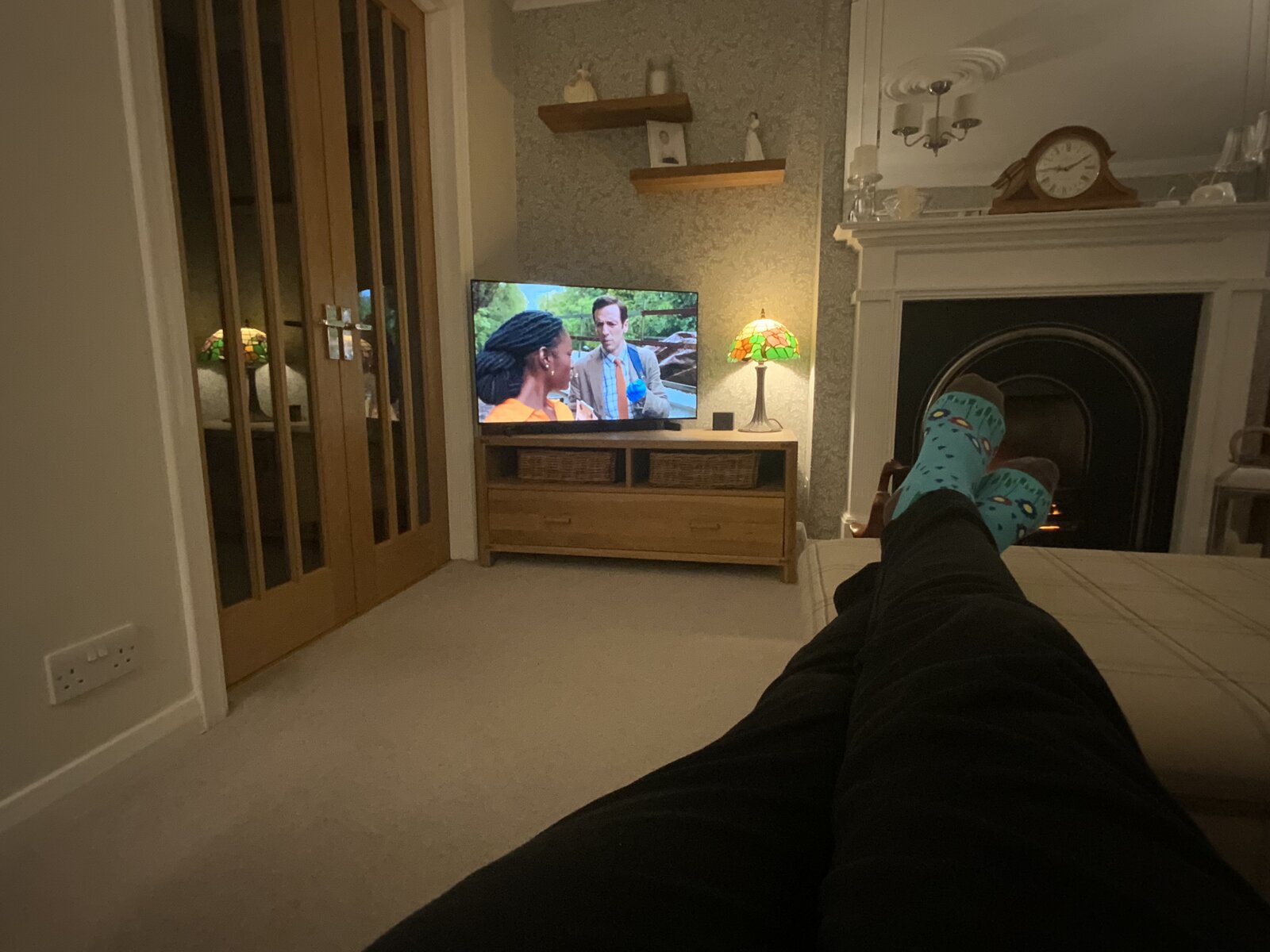

As has been said you will get use to whatever but mine is 55" and about 8 foot away but from what I was reading at the time of planning the room its best to have the tv centre slightly higher than your eye level looking at the screen. But NOT up above the mantle piece and please please put it on the wall not in the corner. The only reason we have a - put tv in the corner is from the old tv tube era when they stood out so much at the back.
When this tv packs in I will be getting a bigger one.

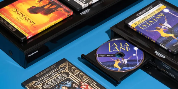

IMO, this whole "correct screen size vs viewing distance" thing has got out of hand. In the rush to publish some kind of guide, too many websites forget to mention that their size recommendation is based on seeing the extra 4K UHD detail vs 1080p when the source signal is top quality. For most of us, that means playing a 4K UHD disc, and a really good one at that.

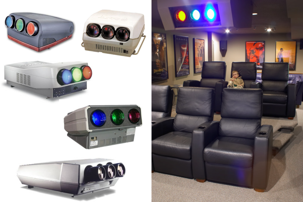

The bottom line here is that you don't need anyone's 'golden seal of approval' to buy a humungous TV screen. We never did when CRT projectors were the pinnacle of home cinema performance. The TV in someone's lounge might have been a 25" or 27" 4:3 CRT, but the projector would make an image on a screen at 84" or 96", that's 7 or 8ft.

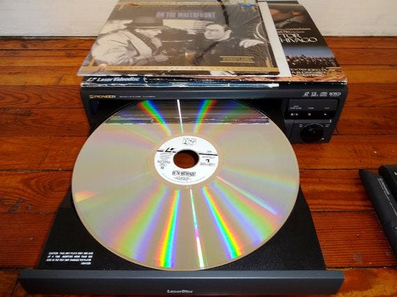

Our best source before DVD arrived was Laser Disc. It was miles better than VHS, which is not difficult, but still not a patch on the picture quality of DVD when that arrived.

Back in the late '90s we knew that Laser Disc wouldn't look as sharp on a 7ft image. That was an acceptable trade-off for the huge increase in screen size. Besides, there was nothing else to compare it to. Since then, video resolution has boomed. From 380 line Laser Disc we've gone through 576 line with progressive scan DVD, then 1080p Blu-ray, and now 2160p for 4K UHD. The thing though is that most of the other resolutions are still in circulation. You can have your Sky Q box set to 2160p, but much of the original content is no better than 1080i or even 576i.
