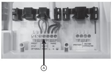

Also, initially the factory fitted red link in the Room stat / timer terminals shown in the photo below was removed, based on the boiler instructions which state:
"The Vogue Combi GEN2 boiler comes pre-fitted with a link wire between the Room Thermostat/Timer connections on the terminal strip. This creates a permanent call for heat and must be removed when adding a Room Thermostat/Timer"
Obviously though, Ideal don't consider the Nest to be a Room Thermostat or timer, because when the Nest was calling for heat the boiler display continually showed "Timer or Room Thermostat off"
As the Nest uses the OpenTherm terminals and wasn't actually wired to the Timer or Room Thermostat terminals, I wondered about the link and so it was reinstated. Now the Nest will turn the heating 'on' and 'off' correctly.
The next problem is that with the actual room temperature shown by the Nest as 24 degrees, a set room temperature of 30 degrees and the boiler humming away nicely showing that the Heating is 'ON', it only fires up for a few seconds at a time with the display showing that it is maintaining a water temperature of 26 to 27 degrees. The flow pipe leaving the boiler and radiators remain cold to the touch.

However I have tried it with the link both 'in' and 'out'. With the link 'out' and the Nest calling for heat, nothing happens. The display shows:
With the link inserted, the Nest will switch the heating 'on' and 'off', but when it's 'on' the boiler temperature goes as high as 30 degrees....
....and that's where it stays. Firing for a few seconds every 15 minutes or so to maintain it. On Friday it was maintaining a boiler temperature of 27, On Saturday it was 30.

I see you have realized that the link wire (230V instructions) is not the same as the link plug (OT instructions). Have you joined the plug and socket together as in item 2 of the OT instructions? If you don't join them the OT terminals on the boiler go nowhere. Look at the wiring diagram on page 35.
Yes. The installer told me he'd done it, and when I checked later I can confirm that it had been done.
I know the Nest was sensing the OpenTherm connection. When being set up, it searched for, and confirmed that it had found OpenTherm. I suspect Muggles is right that the problem is with the "logic" ie the software. [not to be confused with an Ideal Logic, which is another boiler altogether :)]
IMHO, I think that the instruction manual from an electrical viewpoint is very poor. As well as the ambiguity about the 'link', the function of the two room thermostat terminals is not shown. One terminal will be the live supply out to the external controls, and the other will be the switched live back from the external controls. However,
From one of the optional installation methods, the diagram below shows the left of the two room thermostat terminals as the switched live coming from the controls.
Yet under 'Fault Finding' it states:
"If not 230V on 'A' there is no voltage from the timer / room stat"
Which is identifying the right of the two terminals as the switched live from the controls. To make it worse, the photo doesn't even show any controls connected, but the link firmly in place instead, which would mean that there would always be a live on 'A' as it's linked to the permanent live next to it. :rolleyes:
