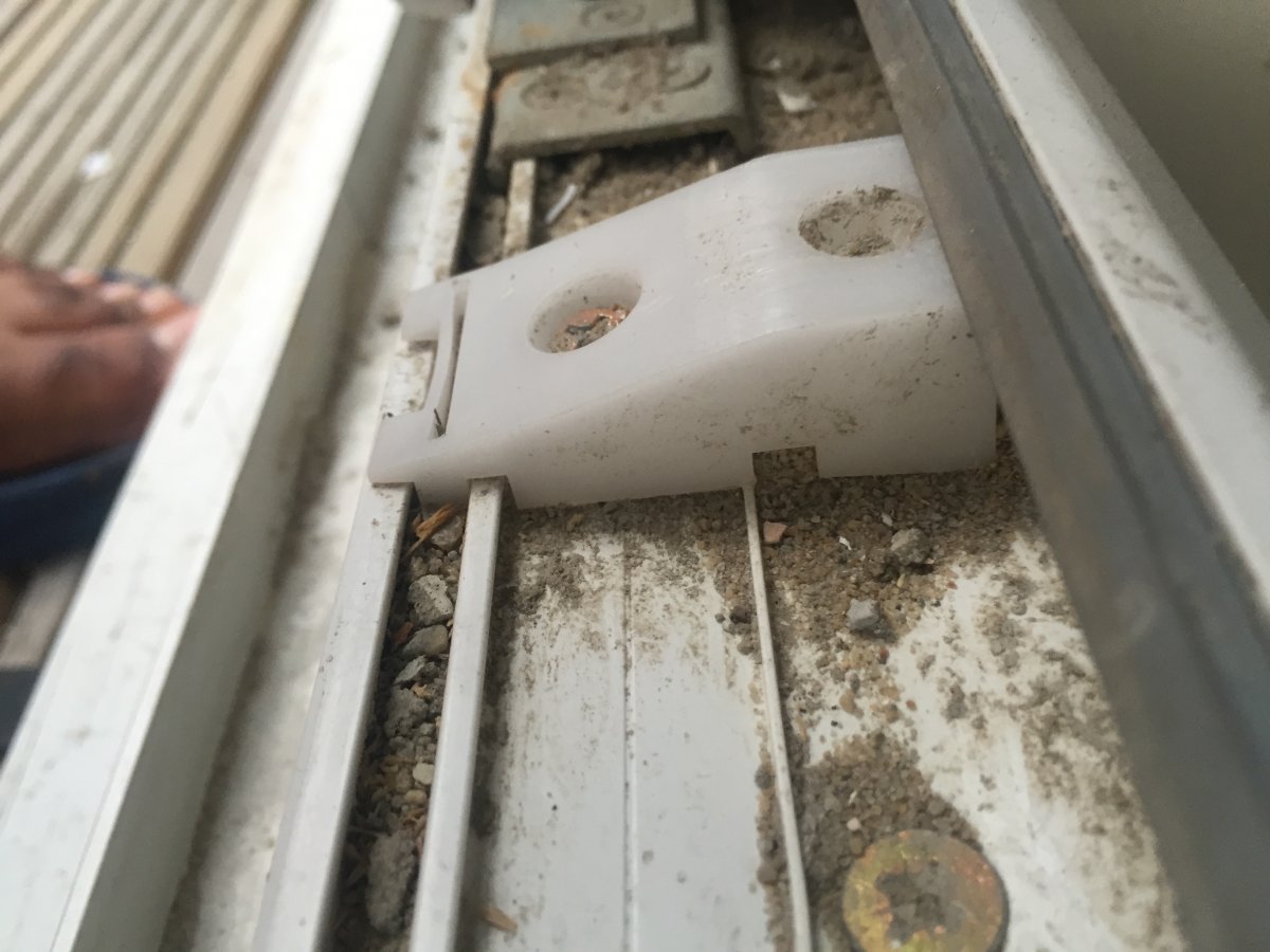

Hi,
I hope you can help me, I have a Deceuninck folding patio door and have broken the one of little plastic wedges which can be found in frame of the door.
I am not sure what this part would be called but without it the door is not flush and will not lock properly, please see the pictures below and I have noticed that similar parts are also fitted on window frames.
I have tried googling plastic window wedge and cannot find anything similar.
I only need one part and want to order one online but not sure what to search for, I have emailed the door makers for advice but thought I'd try this forum and see if anyone out there can advise me.

Picture of part
Part pic again
Wider angle
If your sure of the make try Googling for some local Deceuninck installers. Some company say these are just transit wedges and are only there to stop the doors/windows from being bent out of shape before fitting.
To be honest your doors need adjusting. Basically it needs Toe and heeling
Take out the beads, Lift the door on the handle side and add some non compressible packers above the glass.
