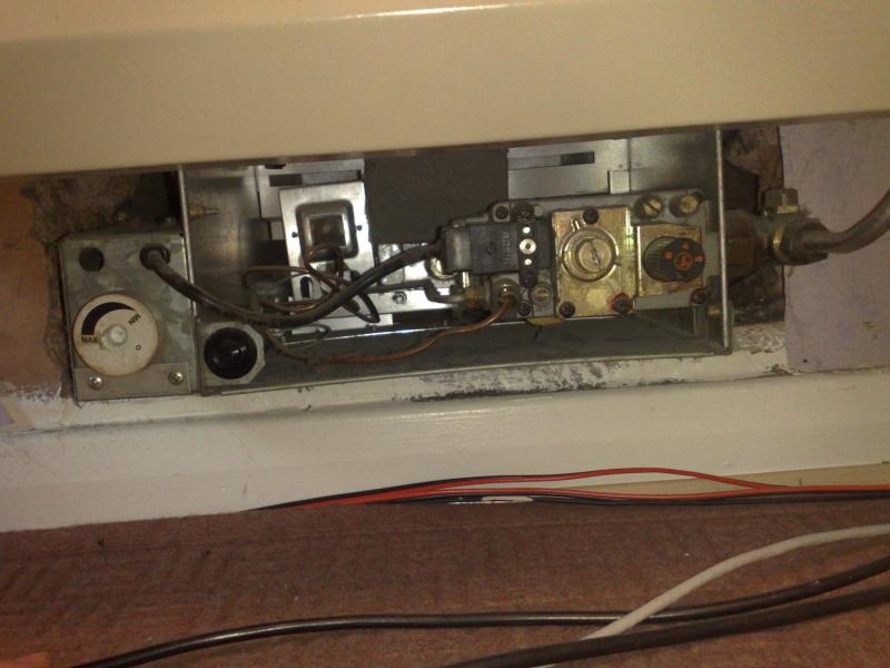

I'm having trouble identifying what boiler I have and so don't know if I'm eligible. No idea when the boiler was installed. If anyone has any idea what model this is and what the rating is, I'd be very grateful!

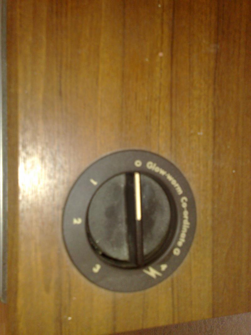

When I remove the plate at the bottom where you access the controls, the label simply states "Glow-Worm BBU lighting instructions"... No model number. The knob on the firefront says "Glow-Worm Coordinate G".
I looked at the Glow-Worm website in the "discontinued products" section and the nearest match I found were the "Co-Ordinate 45" and "Co-Ordinate 56" back-boilers. There is one obvious difference though, my piezo button is to the right of the thermostat knob, but the manuals for the Co-Ordinate boilers show it above the thermostat.
Unfortunately the boiler data badge that the Co-Ordinate manuals refer to has completely degraded over the years so is completely useless...
The controls at the bottom of the BBU:

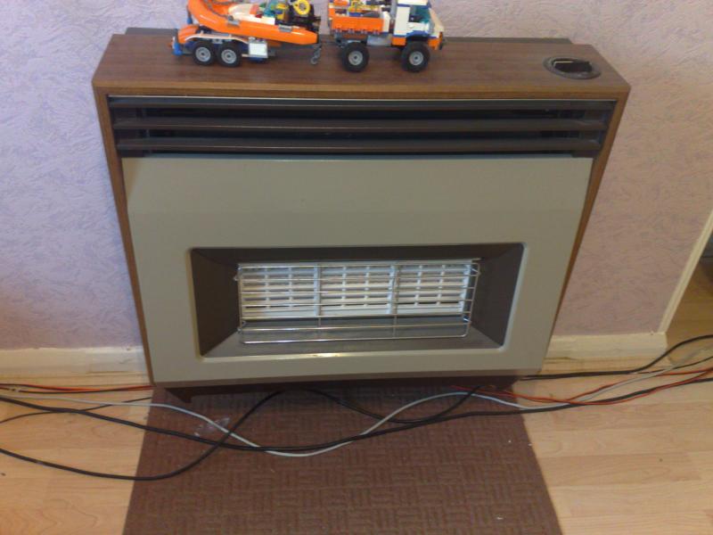

The unit in place:

lookds like the data plate is missing
the co-ordinate is the fire
its either a 45, 55, 65 boiler
your bbu is a coordinate aswell. A 45 or a 56. Makes no odds, its still band G.

Dont get rid unless you wanna change your decor where the fire is!!
Parts are still available and you just cant beat a BBU with the exception of a Mexico!!

you might not beat a baxi BBU but gloworm BBU's are hateful things and a lot of the parts are obsolete.

The Capricorn and Majorca have an obsolete gas valve - still available, but a lot of RGI's cant be bothered to find one. (made my ICC) - All parts available for a coordinate. Repaired one last week - a new gas valve. (Made by S I T).
Keep it.
most of the heat ex's are obsolete now i believe.

Yeah, the capricorn / majorca Heat Ex's are hard to get hold of.
