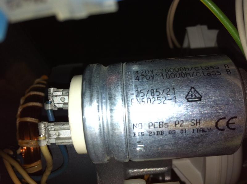

I have noticed the metal thing looks like a d type battery with live and neutral wires is very hot is this normal ?
I believe you may be referring to the wash motor start capacitor. Post a pic or look at what is written on the body (should say 8 or 10uf). If the capacitor fails the wash motor will not run, it will just "hum". Similarly; if the wash motor is jammed (either because the impellor or seals are jammed) it will have the same effect...the motor just hums. With the power off try to turn the rotor on the wash motor to check if it is actually jammed. If it turns freely it may point to a defective start capacitor.
If the motor turns freely I would suspect a faulty capacitor (the silver "D" type battery thing you mentioned). Remove the capacitor & pop into your local domestic appliance workshop & ask them to test it, or if your multimeter has a capacitance function test it yourself.
the capacitor has 4 uf on it the reading came out at1.011 nf does this mean the capacitor is broken??
Off the top of my head (which doesn't always function as it should) I would have thought it may have been a higher uf. That said...if it says 4uf & measures 1nf it is history. Buy a new capacitor & that should cure your problem. They are not expensive :D
