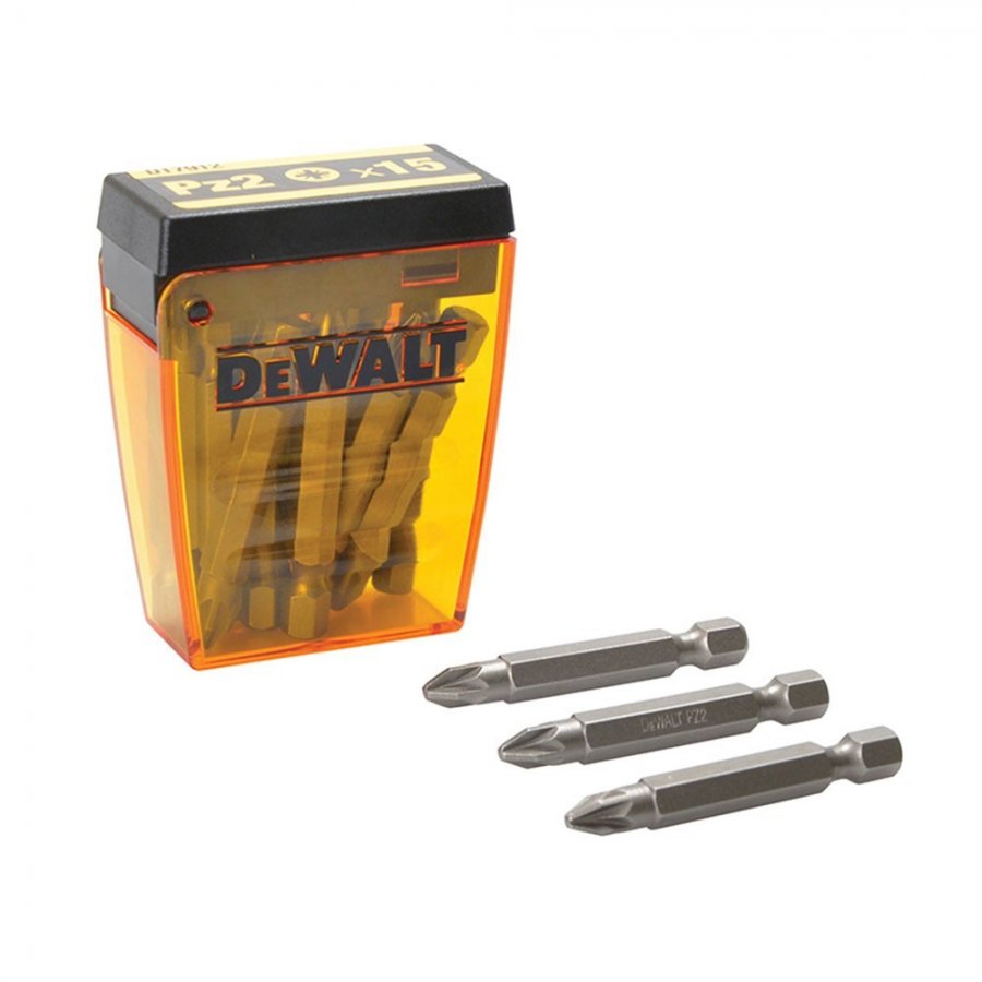

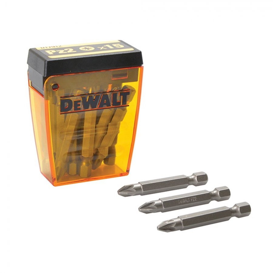

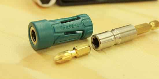

i have bought an impact driver since my little 4v Ryobi pistol style one is not up to some of the jobs i am doing and i reckon it will gradually die..
the bits which fit the small driver, which came with it, go into the impact driver chuck..but disappear into the hole...or fall out
the impact driver came with a driver bit which is a bit longer and clicks in to it ok however
i do have an adapter which fits the impact model and take the small bits...its magnetic
is this a usual method... or do you chaps go out and buy a complete set of screw bits to use with the impact driver... if not...are the bits which came with the small driver...up to taking the impact forces..
the impact driver is the Ryobi +1
cheers
geof
I do that all the time. Every now and then one will explode due to the force, which depends what you're driving in to. Generally I don't have a problem.
Go and get yourself one of these Makita gold impact bit holders. Without a doubt the best I've used. The green sleeve has a really strong magnet on it to hold screws in and you can take it off to knock off any swarf you might pick up. Also acts as a flush sink stop.
You can buy 40mm impact bits in packs of 5/10 but they cost a bit more so I just use the older cheaper dewalt 15 packs. I don't have any problems with them.

The new 50mm dewalt extreme torsion don't need a bit holder and I'm yet to snap one, they're also precision machined and fit the screws to absolute perfection and surprisingly are very affordable
If not these then use WERA bits along with a bi-torsion holder if money's no object, if your just an occasional impact user then the dewalts in the tic-tac boxes Sammy posted are fine

i am going to do that...i have decided to go for a makita holder and so use up some of the bits i have with it
i like the idea of the stop when the screw is flush...the impact driver can run away with itself.
