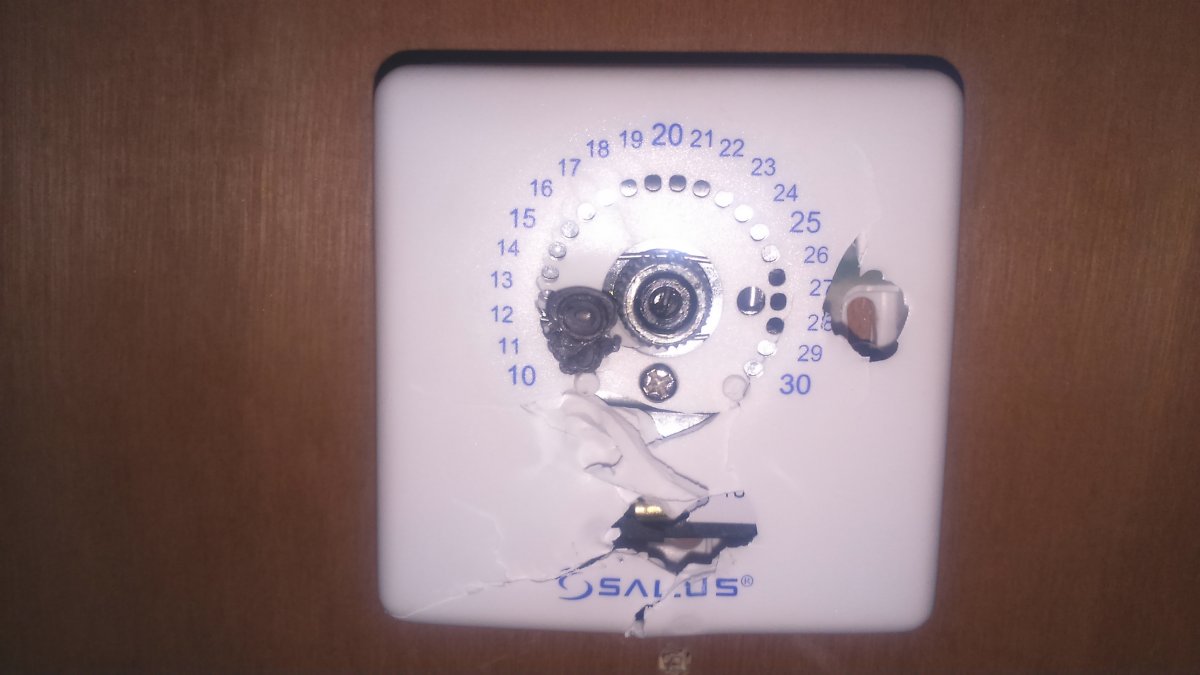

RIGHT!
Let's get this up to double figures so on with the banter!!
Video didn't bloody record but a quick 4 shots 2 dead centre and a couple for practice! It's now 3 degrees more accurate and still just as reliable! Its surprisingly sturdy with a bit of body armour in the centre! It's a stat I would choose to survive a shooting. Still crap for your heating requirements
though.
