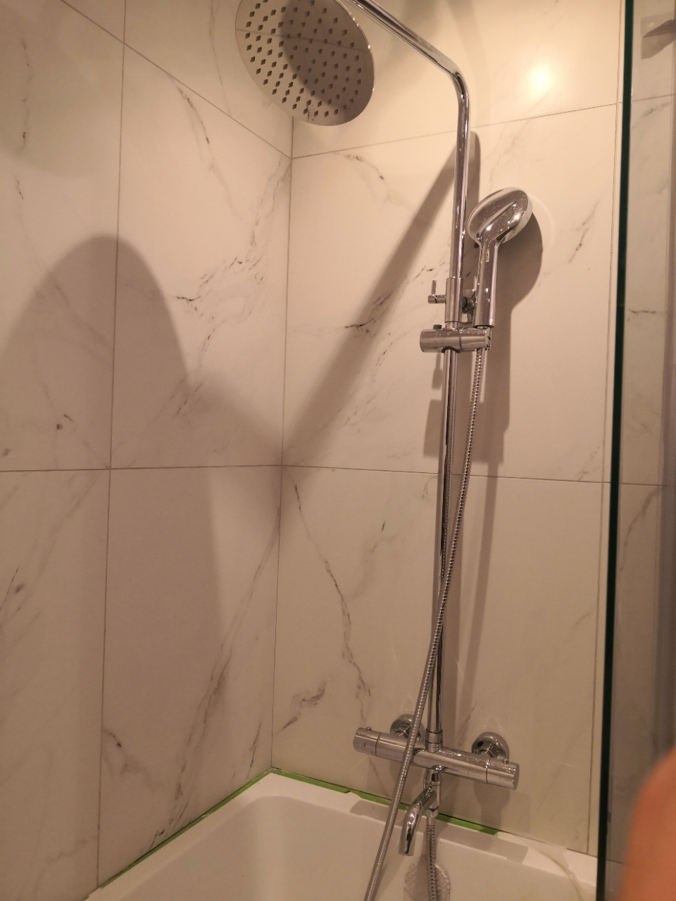

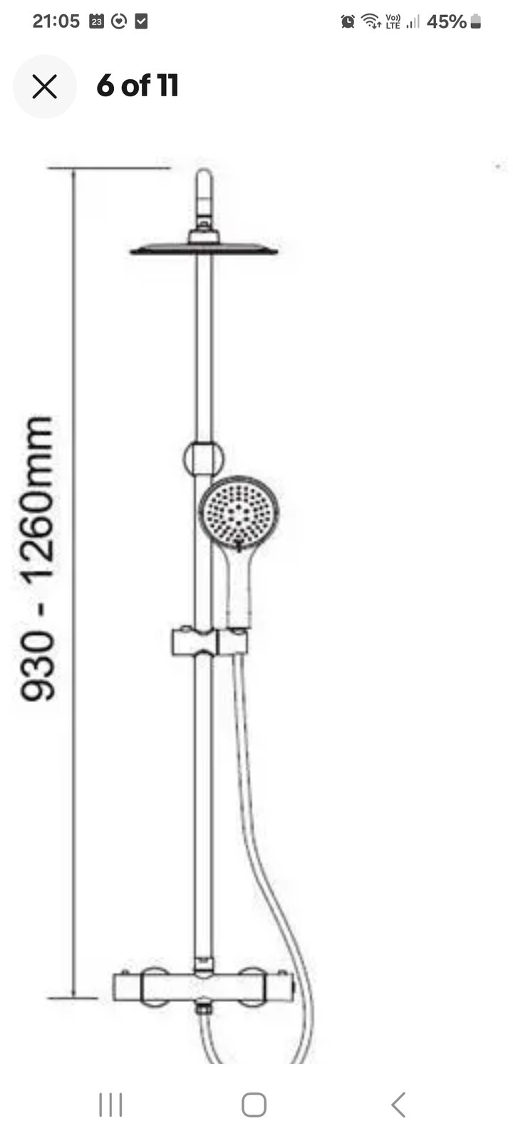

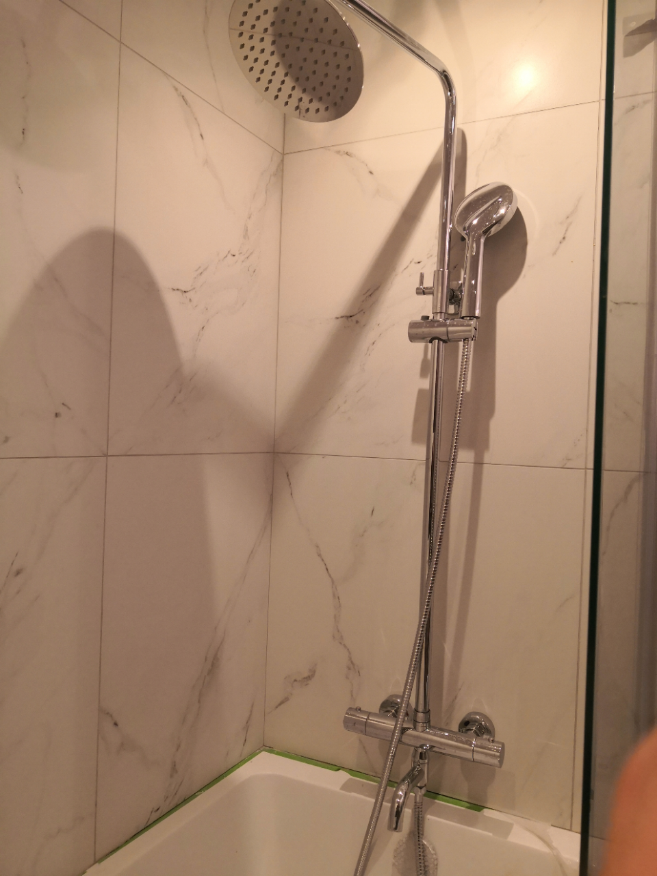

Hi there,
My bathroom fitters have installed the following shower https://www.victorianplumbing.co.uk/nova-round-thermostatic-shower-kit-with-bath-filler only to find the telescopic shower arm extends to only approx 1m or so from the mixer; meaning the shower head is below head height when standing in the bath! The mixer has a spout to fill the bath, so I assume that's why it was fitted at this height.
The height needs to increase by about 50 cm (so about 150cm from the mixer).
Is there a way to do this without moving the mixer? Is it possible to buy a replacement riser pipe of the required length i.e. 150cm or thereabouts? Is there anywhere that can create a pipe with the appropriate connectors? The fitters will resume in a few weeks, so trying to get some info in advance.

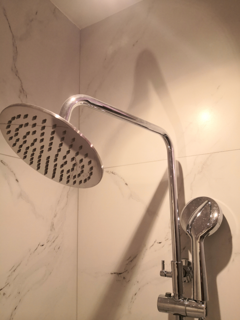

The top section to the rain head is telescopic .
If you release the small lever on the left hand side how much does the top section move upward?

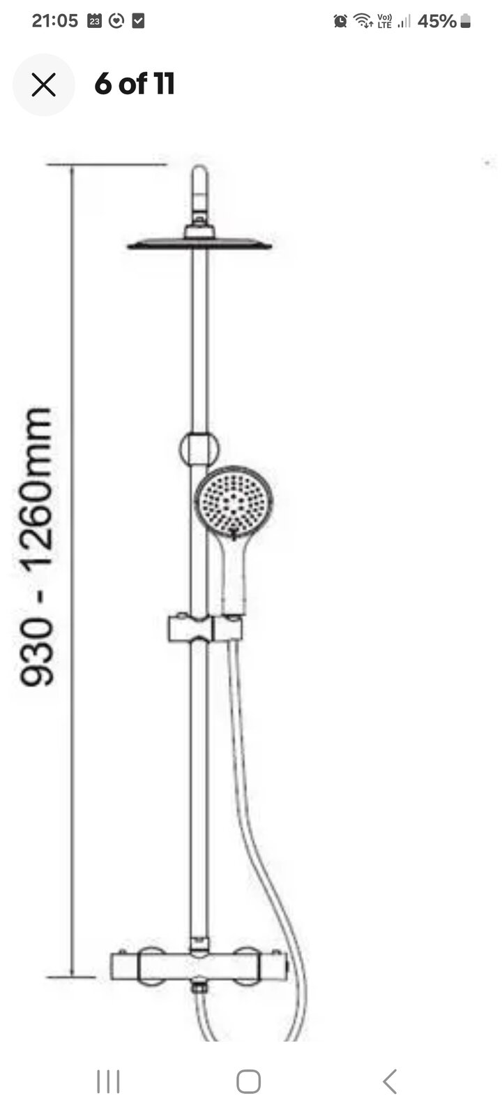

Max height is 118cm from mixer to the top pipe, so still short. I've seen pipe extensions for sale such as these https://www.amazon.co.uk/Shower-Pipe-Extension-Arm-Inch/dp/B08N2S2XFJ?th=1 might do the trick.
Or I may just do away with the fixed shower head altogether - putting a blanking cap in the connector on the mixer.

I think this will get you out of trouble.
That's not going to get the op the 1500 mm that he is looking for unfortunately Bod.
The extension pieces he linked to would.
