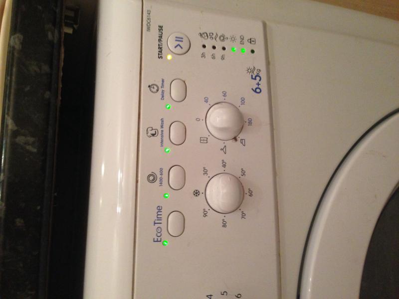

Recently my washing machine has been leaking and today when I used it at the end of the cycle all of the four lights along the top were flashing. I turned it off and then the door light was stuck on red. I tried to set it to do a spin but nothing happened. The only thing it would let me do was another full wash which it did but then I had the same problem. I cleaned the filter on the bottom right and I unplugged it from the mains but it didn't fix it. I eventually had to take the top off and open the door manually. The machine had no water in it. My question is if I run another cycle am I going to have the same problem? If so, does anyone know how I fix this?

The cycle has finished and all the lights were flashing after about 5 minutes it started again as though it was drying and then after about 5 more minutes stopped. Now all lights flashing and door won't open. I have taken a picture but I don't know how to add it to this post!!!

I had set it to do a normal wash no drying selected. Yesterday I did a short wash. I cannot set it to do a dry now as the clothes trapped inside are unsuitable. Just gone to look at it now and all the lights have stopped flashing but the pause light is blinking. It's like it doesn't think it has finished. I have pressed the off button and the red door light is on. It has now started up again by itself with all lights flashing and will stop in 5 mins with the pause button flashing!!!
