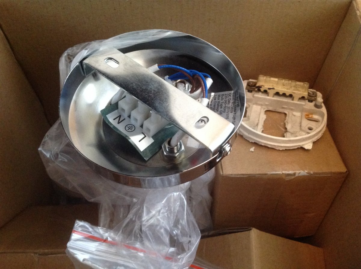

Hi there.
Just trying to fit new light could someone please tell me where I put the 5 wires what are in the line loop in ?
Total wires 3 in neutral
1 in live
5 in loop
I've put two pictures of new light and old any help would be much appreciated.
Stephen
The new lamps has three terminals Live ( for the lamp ) Neutral and Earth,
The ceiling rose has four terminals Live Loop, Switched Live ( for the lamp ) Neutral and Earth
You need to add the fourth terminal for Live Loop by by adding another terminal. Either as a separate piece of 1 way terminal strip or replacing the existing three way with a four way

So if I put the 5 loop wires in a terminal strip 2red 3 black will that be ok ?

Bad idea the light is upstairs and I have a loft conversion
I know your only trying to help but I think the terminal strip is the easiest way for me to do this and just want to know is it ok to put the five wires in a terminal strip from the loop?
Your old pendant is wired in a somewhat unconventional manner. Normally there would only be red wires in that centre loop set of terminals.
I would be interested to see what you find when you actually remove that old pendant, there should be a couple more red wires hanging around somewhere - maybe a loft conversion bodger has done some creative wiring!
I cannot exactly tell from your photo, but if all 5 are connected together in the pendant then, yes, you need to connect them together in a bit of terminal strip.
Bascially you have to replicate what is already there.
My problem now would be how do I fit the 2 red wires and 3 black wires from the loop in to the same terminal strip or can I put them in two different screws in the terminal strip?
Stephen
As you can see, there is no connectivity within a connector strip between the terminals
With Wago-type connectors there is.
If you must use a strip like that you'll need to link terminals together on one side and put your lighting conductors in the other.
