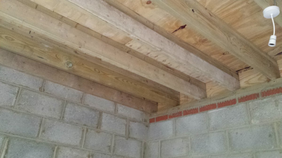

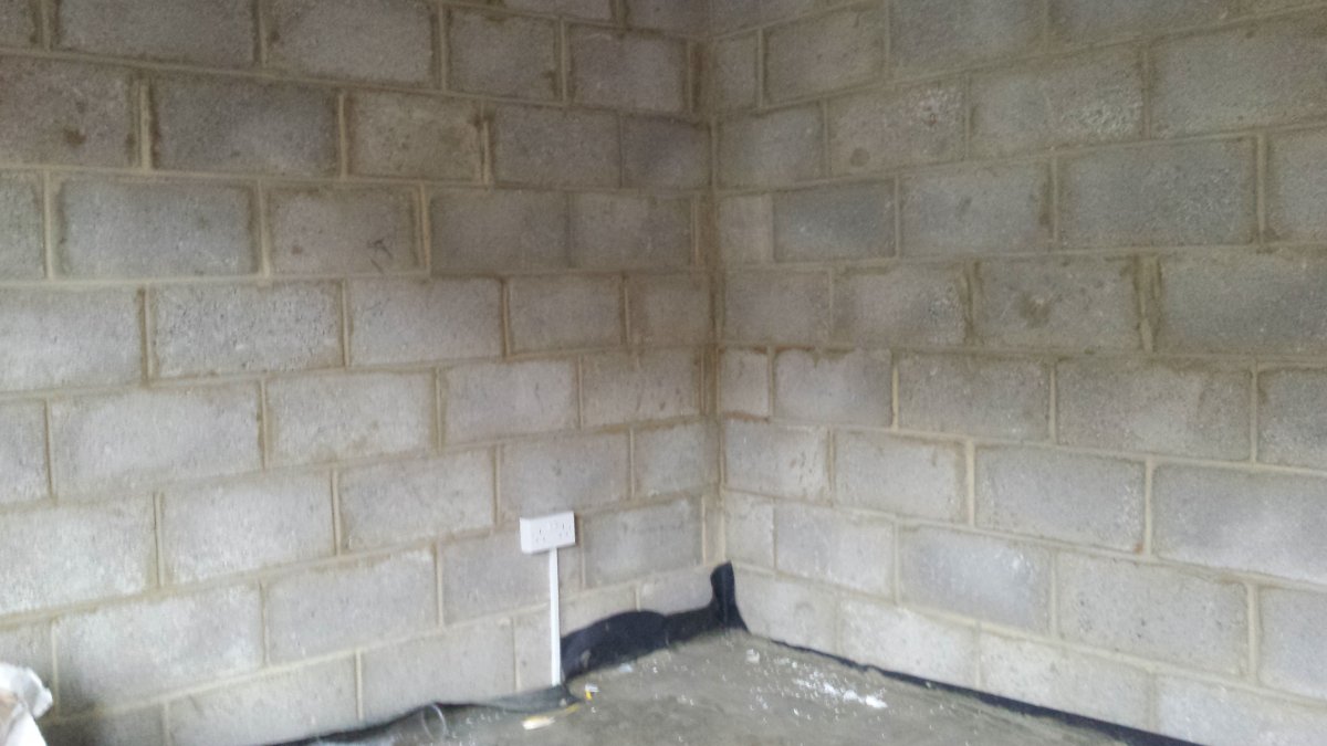

Hello folks,
Just finishing a new shed being built by builders but I'm a bit confused as to what materials they would use in walls for insulation and ceiling. As it is the walls and ceiling does not look nice, with concrete showing and the ceiling is unsightly.
At the moment, we're undecided if we're to proceed with insulation, as the cost will increase.
What does wall insulation involve?
The builder says, that involves adding plasterboards and then plastering on top?
With the ceiling, not sure what fibre he mentioned and then plasterboards and then plaster?
He is asking £1,500 to the insulation for walls and ceiling for 20 Sq M.
Floor is insulated by them already.
Apart from insulating and costs involved, is there anything else we could apply on the wall, apart from off course masonry paint and in the ceiling. It's not going to be an office or anyone living there, Mrs just wants nice looking finish.
Is 20Sqm the floor area, or the wall and ceiling area. You need to check exactly what he's proposing to do; he may only be offering to put 25mm of celotex on the walls, and maybe 50mm on the ceiling between the roof joists. Depending on what the shed is being used for, holes may need to go in the facias to allow an airflow across the roof above the insulation.
How much space are you prepared to lose in the shed; if he's going to batten the walls to leave a 25mm airgap, then put 25mm celotex, but the time you've added the plasterboard and skimmed it, you've lost almost 6" across the width. As long as the shed isn't going to suffer any water ingress, then call a couple of plasterers in, and get the to quote to dot and dab the walls and plasterboard the ceiling, and then to skim everything.

We're conscious that we would lose space. However, our only concern at the moment is that we don't want to see the bare concrete walls and timber roof joints. Is there anything we could do to make the walls and the ceiling nicer to look at? Or is the insulation the only option?

If you're fine with the freezer in a cold room, then you don't need to insulate place. You can just plaster the walls and then paint them, or you can dot and dab the walls with plasterboard and plasterboard adhesive; the plaster's would also put plasterboard on the ceiling, and they'd then plaster the whole lot. You can ask the builders to quote just for this, and you can call a couple of other plaster's in for competitive quotes.

We wanted to just plaster the walls and paint them, but the builder advised against this and says large cracks would appear on the walls? He said without adding plasterboard on the walls, it's not a good idea to just plaster on the inner walls. Is this true?
On the ceiling is there no alternative to adding plasterboard and then plastering?.
If there is no alternative, we could just plaster the walls and then paint and add plasterboard on the ceiling and then plaster and paint.
Putting plasterboard on the walls first, will give a much flatter surface, and dry quicker, so it's a good way to go, but not essential. Everything shifts and settles a bit after it's built, so you'd possibly get a few small cracks, but not enough to justify needing to put up plasterboard. But putting the plasterboard up will make the room a little warmer.
You could plasterboard the ceiling, fill the joints, and then paint. You could use plywood, if you don't mind the inevitable gaps at the joints - it's totally down to you.

I have seen problems with dot & dab on external single skins so thats maybe another reason he wants to use insulation.
Now I've agreed to do insulation. He is going to use thermal boards then plaster on inner walls and ceiling. On the ceiling he is going to use insulation wool and then thermal boards and then paint.
