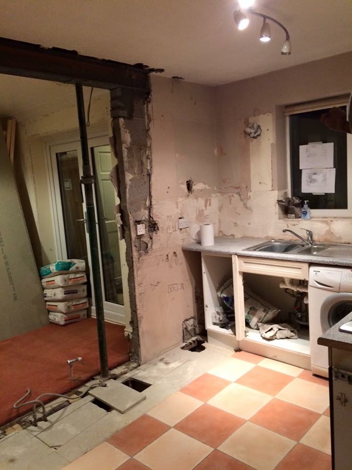

3 years ago we had an internal structural wall removed, a steel beam installed and put back together by a builder. The was wall separating a kitchen to a dining room and now its open plan, the wall taken down was about 2mtrs long.
We are wanting to sell the house but the builder has stop trading and I cant find the building regs etc we had for this anywhere!

If they have no record that implies that the builder did not make an application.
If it is required that you need certification for the sale (ie it gets noticed and flagged up) then you can make a retrospective application called Regularisation. This will involve opening up the ceiling or floor to check that the support used is suitable. Some mess and making good. Obviously you need to be sure that whatever work was done was done correctly, else you will need to bring it up to standard.
Whether you choose to do this first, or wing it and see what happens is something to think about.

I do have photos of it being installed so not sure if that would help???

It may help/be sufficient, you would need photos of not just the steel but also bearing etc. also.
If "nibs" have been left, and there is a downstand/boxed beam below the ceiling it is usually relatively simple. as the works are more straightforward to asses.
Here’s one of a few images showing the steel and the wall nibs it is sat in.

If a house it probably won't get flagged unless a planning application exists showing an old layout (as how do they know it wasn't always like that?), if a flat your layout won't match the lease so probably would get flagged.
Looking at it I'd guess it is a 152(h)x89(w)x16(mass/m), this is a standard Beam Size (based on the blocks being standard at 215mm tall and 100mm wide), and also bearing at least 150mm on the block wall which is normal practice. BC can probably confirm if this is sufficient and regularise without knocking holes but up to the discretion of BC.

Say you've lost the papers, the builder did it all, play dumb and wait until the buyers solicitors demand a £150 indemnity then agree to it. Cheaper than regularisation too.

If enough time has passed, and your buyers are reasonable. Most people would think that if it's stood for six years with little distress then there's not much wrong with it, and be happy to take their solicitors advice for an indemnity policy.
