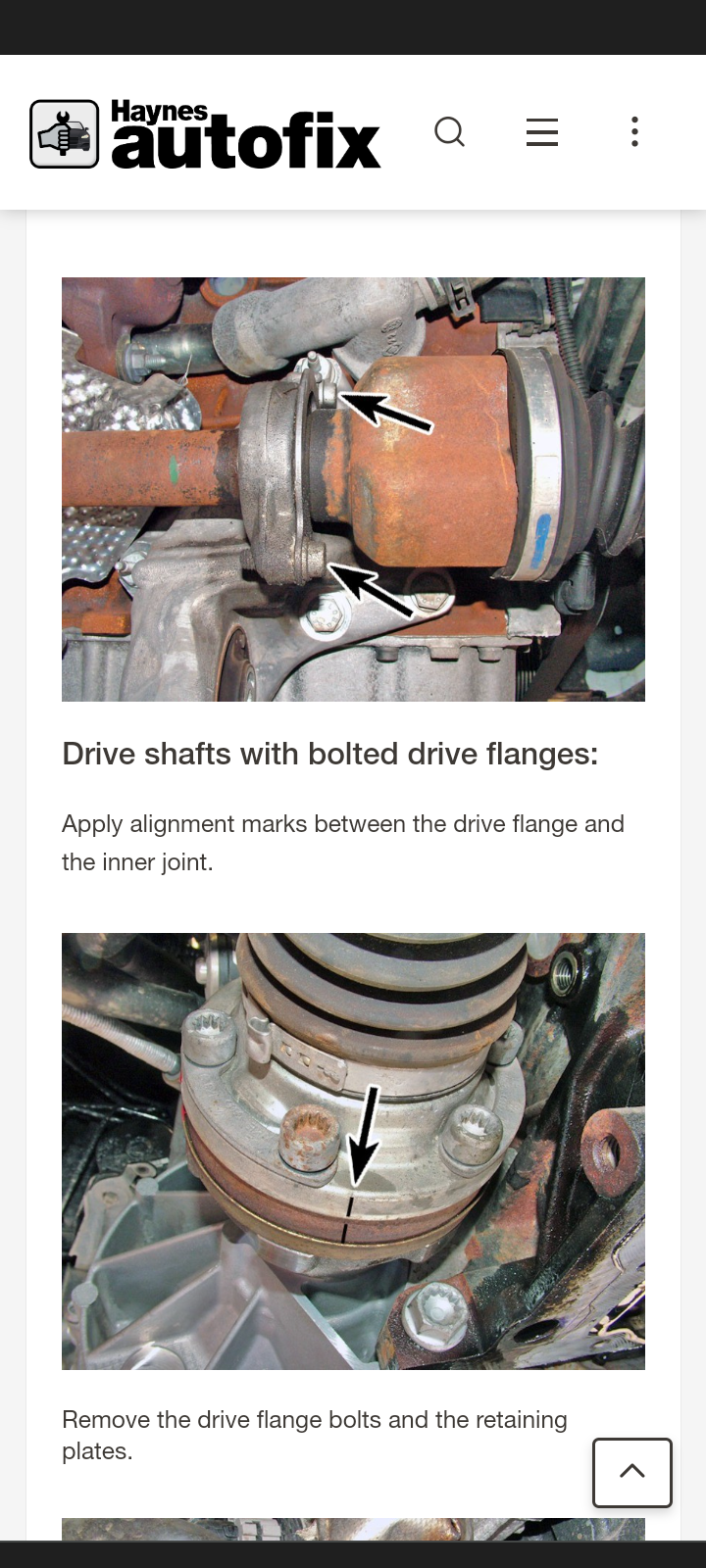

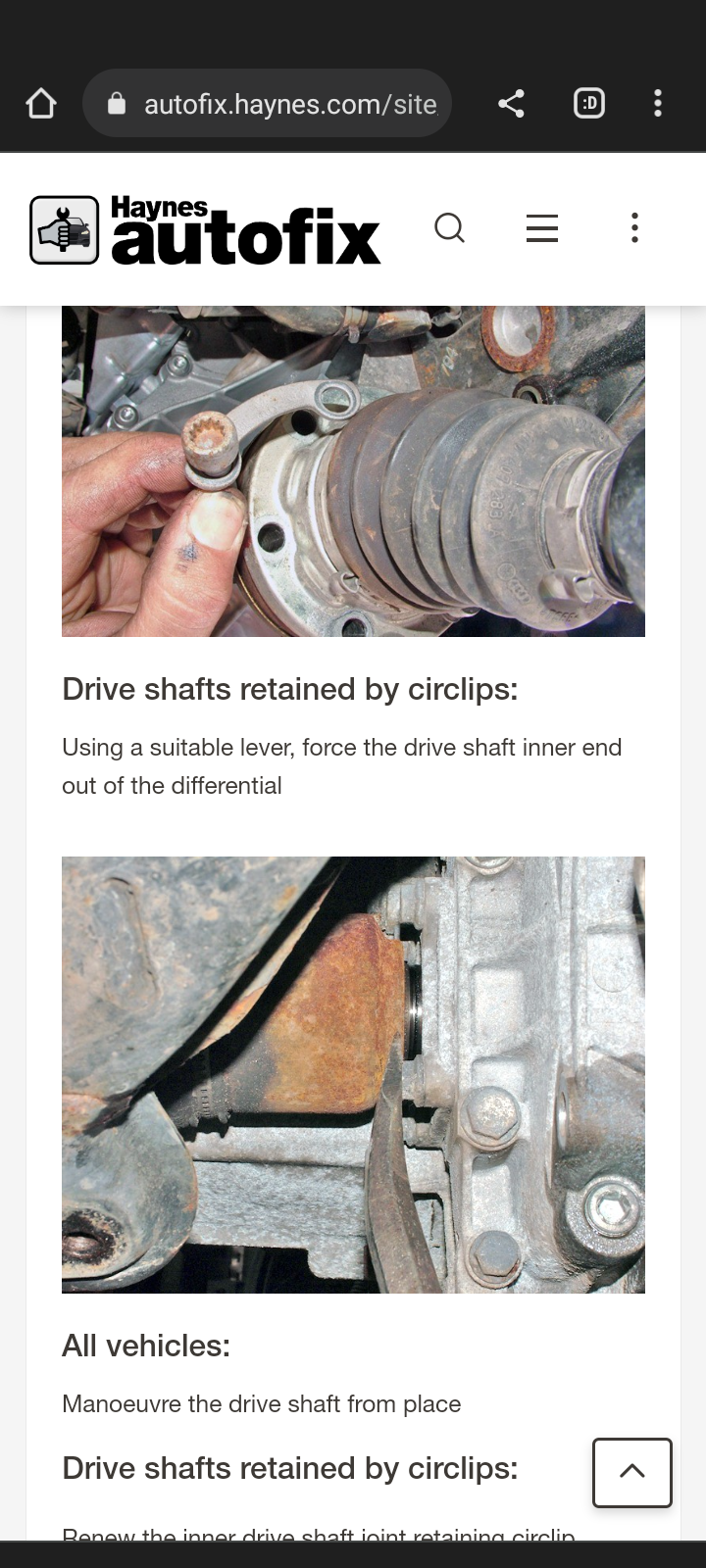

I bought an online manual for this car last night it seems a bit rubbish and not very well explained .
Anyway I don't know if this but if info helps
The bolts on top pics look like the ones I am referring to
