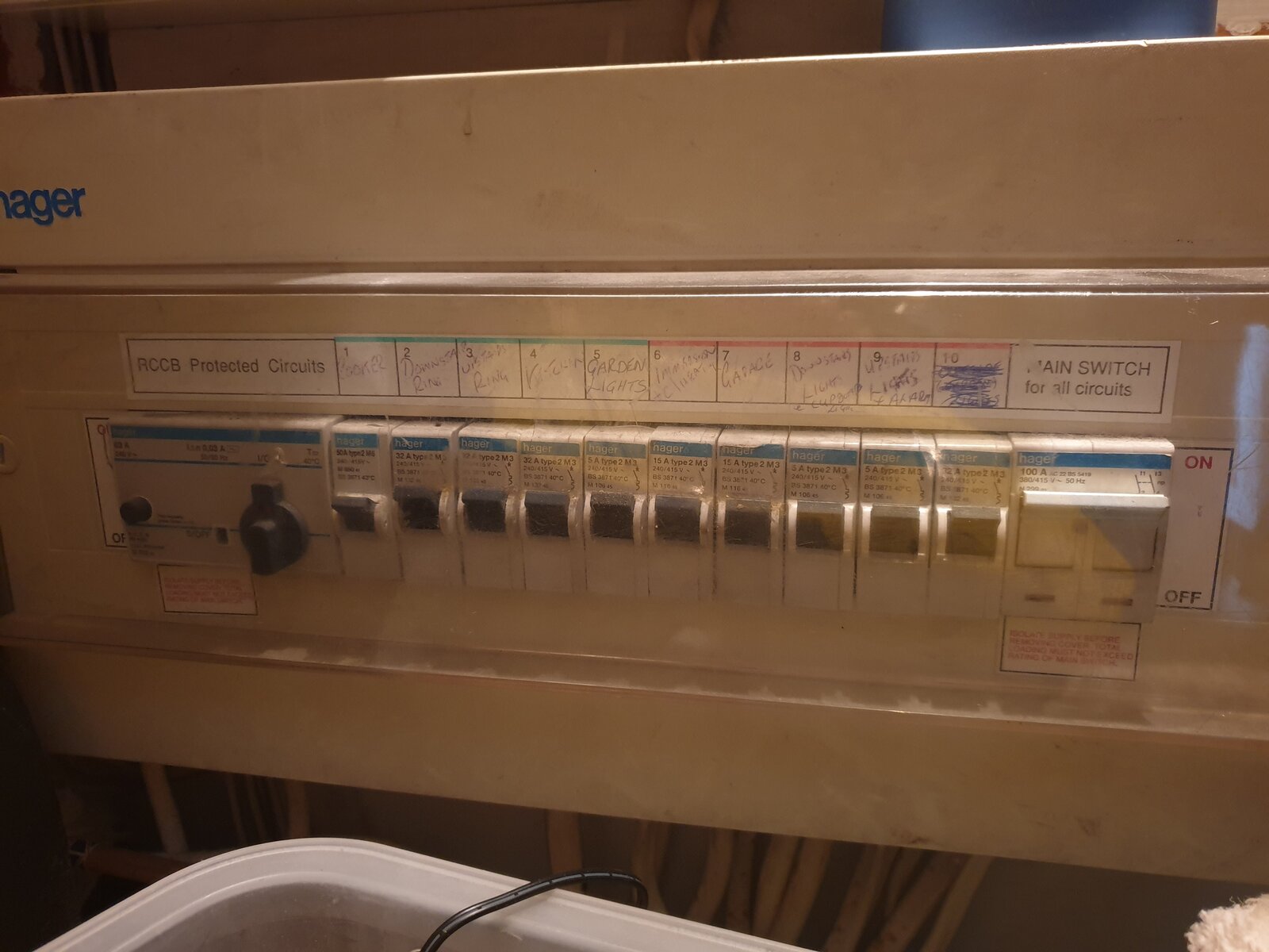

Talking to a friend the other week and she said she has to have a couple of consumer units changed in some properties she rents out. Had to be done by next year but as she was having a change of both tenants, she was getting it done before new tenants moved in. Something to do with them having to be metal or something. I have a plastic consumer unit that my Bro in law fitted for me about 20-25 years ago. Just wondered if it would be worthwhile changing it now to something more modern and possibly safer. If so, what would you recommend? This is what I have at the moment.
That consumer unit us perfectly serviceable. There are millions like it. It doesn’t need changing and certainly not just because it has a plastic enclosure. (Your friend is being taken for a ride if she us having to change the CU solely for that reason.
Changing a consumer unit is notifiable work. It’s not a DIY job.
If you decide to change it (you don’t need to) then you’ll need a registered electrician to supply and fit.
As I say, the one you have is fine. It doesn’t meet today’s regulations but it did when it was fitted (16th edition) and regulations are not retrospective.
Yes, give it a bit of a clean and rub out all that writing someone has scribbled over it.
That will make it look nice and new. ;)

She is being conned. Plastic CUs should not be fitted now but there is no requirement to change existing ones.
Regarding the garage circuit it does not seem to be RCD protected at the main CU. Is there a seperate RCD at the garage end protecting the sockets in the garage? If not I would try and add RCD protection to the garage somehow.
What is it with RCBOs- are they worth it?
I changed my consumer unit as the old one had rewirable fuses and no RCD. I decided the extra cost of having all RCBOs was well worth while as a fault on one circuit does not take out half the house.

I agree ericmark. My main reason for wanting the consumer unit changed was a total lack of a RCD, this included outside lights and sockets. I know I could have added one as a separate unit but that would have cut everything in the event of a fault. I reckoned it was far better to have each circuit protected by a RCBO.
You mentioned fire risk, I live in a first floor flat and I have changed the ceiling over the stairs from hardboard which burns well to gyproc which will not burn easily. There is no perfect solution but we do what we can within our budgets.
Maybe I should change the consumer unit to a metal one which would not cost much as the RCBOs would transfer but on the balance of risk I'll not bother, if there is enough heat to set the plastic consumer unit alight I think the burning meter and main 100amp fuse will be the bigger problem.
