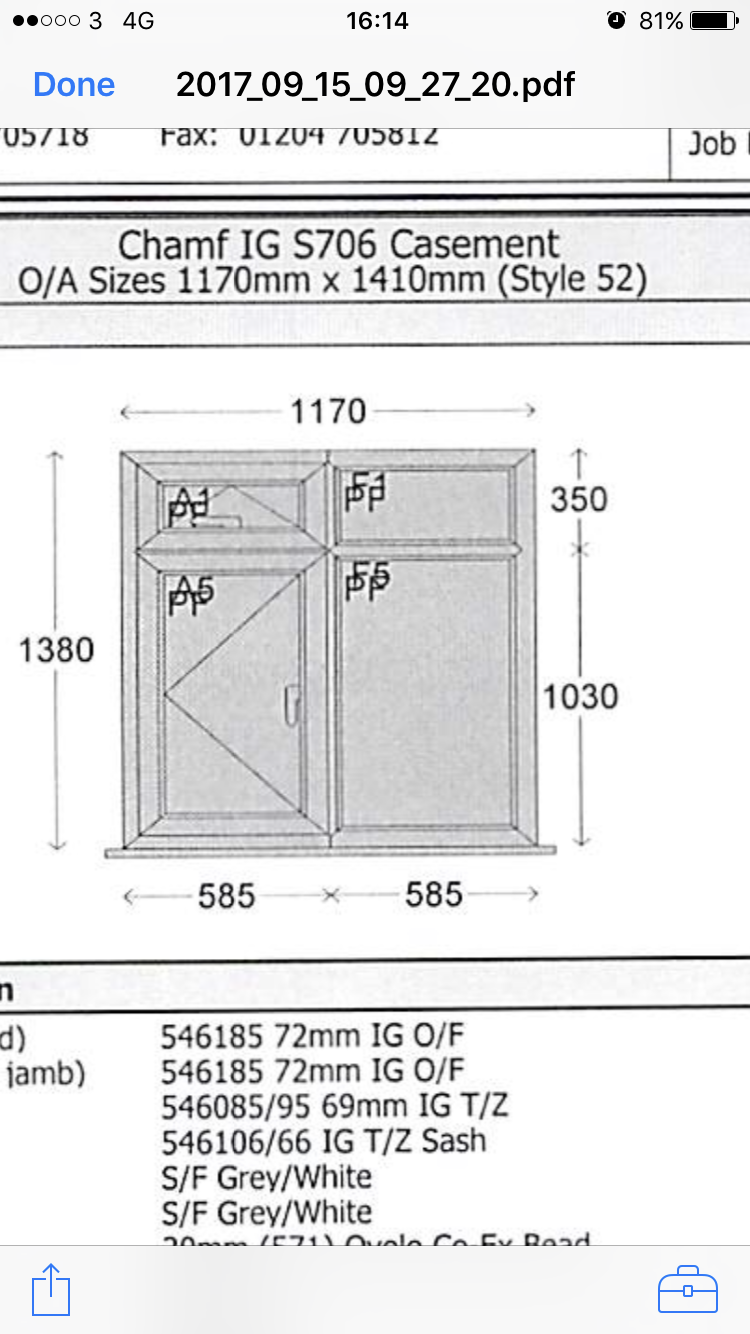

The key is the 'or'. The minimum 450mm size must be one of the dimensions, whether it be horizontal or vertical. So a window could be portrait or landscape orientation. It must also be a min of.33msquare. The area means that a window with min 450mm in one measurement will need a min of 750mm on the other.
The measurement is the clear dimension, so if the sash is in the way slightly when open that needs to be taken into consideration.
Your not far off at all Notch (y)
This is that window:
The loft one will have 3 slightly wider (650mm) windows and be the same style. I could easily climb out of that one.
Not a bad guesstimation then!
650mm will easily give you a bigger than 450mm ckear opening. As long as you achieve the 0.33m metre square.
