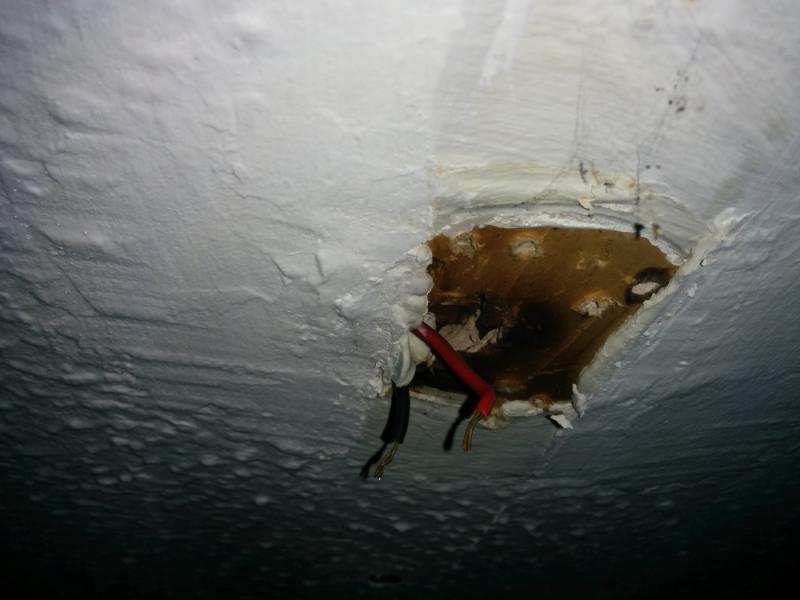

After removing a kitchen light, I found it connected by thin choc block to less than an inch of wire pair coming out of a ball of mastic and plaster partly blocking a hole in the ceiling. One of the strands of each wire had been cut or broken off - maybe to make it easier to bend into the choc block.
There was an earth connector on the metal body of the light fixing, but no visible earth wire. I assumed it was just old wiring without an earth, and tried to reconnect the choc block to put things back, at which point the exposed wire sheared off at the sleeving from where it had been overly stressed.
On further inspection, poking, prodding and pulling out chunks of mastic and ceiling, I found that there was in fact plenty of cable up there, but that someone had intentionally fixed it in to be that short.
There was also a bit of black electrical tape wound around the end of the insulation, which contained the earth wire, bent back along the cable.

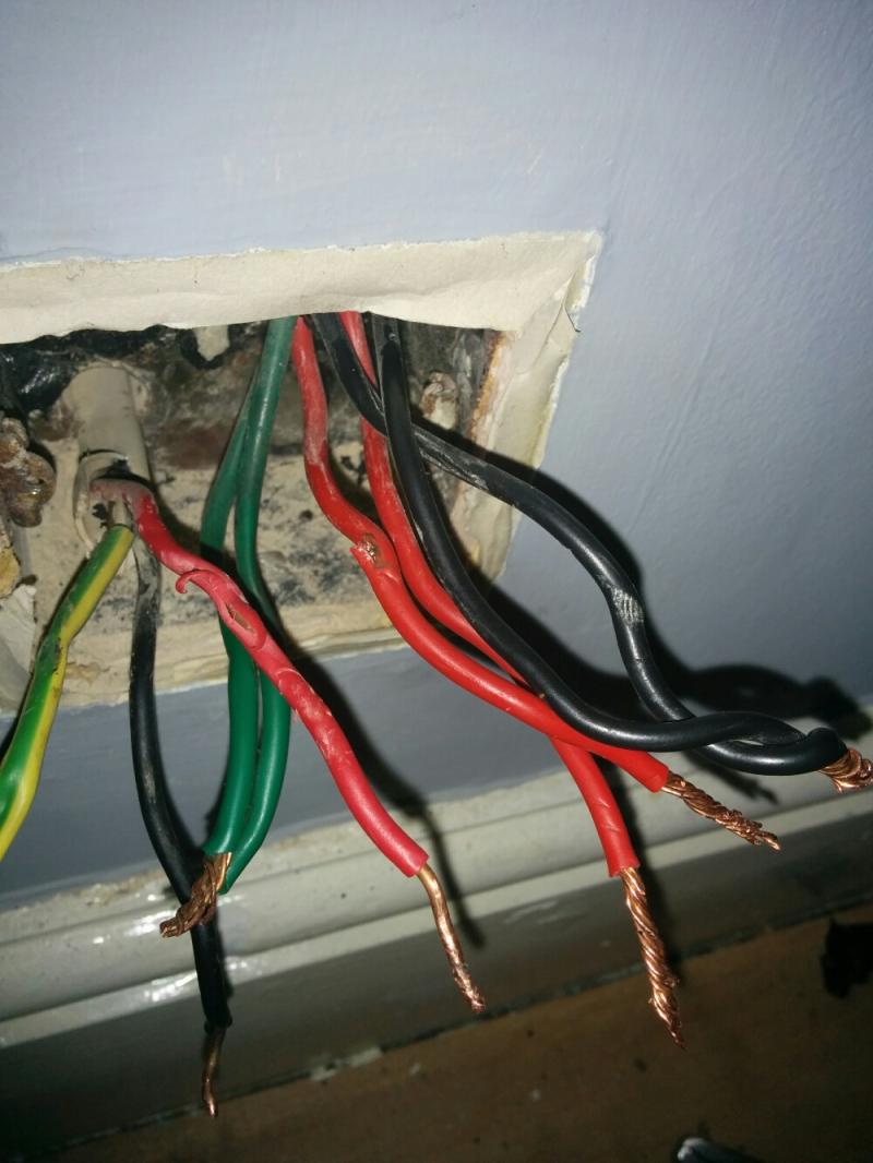

On the second socket after disconnecting it I found this:
Spot the great condition of that insulation. Two live wires have been stripped in the middle (forensic examination suggests a Stanley knife), and to add further excitement, a neutral has been squashed against a screw thread until the insulation was crushed.

It seems like your complete house wiring needs a serious attention, check each and every socket, ceiling rose, and all wiring where possible, if found out to be dangerous you might consider rewiring by an expert and get a few quotes, shocking really when you see those knife nicks in the insulation of red live carrying wires.

That particular socket, I've cut back the stripped wires to remove the obviously dangerous parts, joined up (Hopefully safely) with 15A choc block and will cover it with a blanking plate as soon as I have one. I don't think there's enough wire to safely connect a socket there.

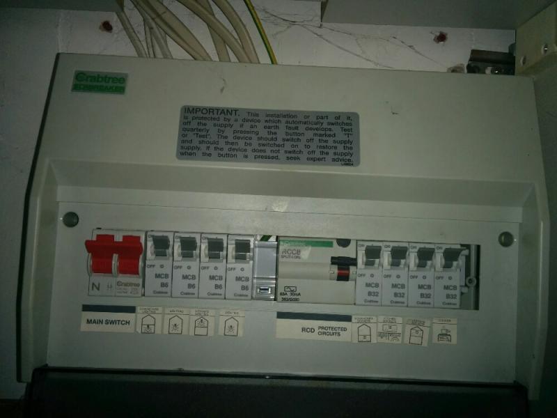

I think you mentioned your cooker keeps tripping, but not sure if you meant an RCD or an MCB, and if it is MCB, this would trip if there were severe overloading or intermittent shorting.
If you haven't got an RCD fitted then make that as an important safety device to protect your unearthed sockets. It is not a substitute for bad earths, but anything becoming live it can trip an RCD.

You say the oven is tripping - is this is the Consumer Unit? If so it sounds as though that may have been replaced, or at least had MCB's installed.

The consumer unit is a crabtree starbreaker. There's a central Switch marked "RCCB split load 63A 30mA" which trips out.
There's also a set of MCB 32 switches marked "RCD protected circuits". the one marked cooker is not tripping. Its possible these are mis labeled.

I'd say that looks more like "clumsy" stripping of the outer sheath to me, rather than deliberate stripping. From your description it sounds like there have been some BIY additions to the system, and the different types of cable (along with the poor workmanship) would support that.
Not at all uncommon. Prior to the use of RCDs this would generally go unnoticed - but where there's an RCD it will trip it once a load is applied.

That's the Residual Current Device (aka Earth Leakage breaker). It trips when there is earth leakage*, which as pointed out could just be a bit of damp in the elements. The two breakers labelled 32A are MCBs and act on current only - ie if the circuit is overloaded or has a short. The RCD is serving both the cooker and sockets - so it may not be just the cooker, there may be some leakage in the socket circuit as well.
* The technical bit, it puts the live and neutral currents through a small transformer - if they match exactly then the output from the transformer is zero (it's accurately sensing the difference between them), but if there is any difference then this shows up in the output and trips the breaker.
