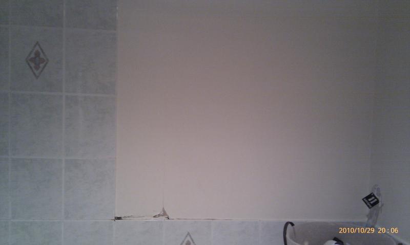

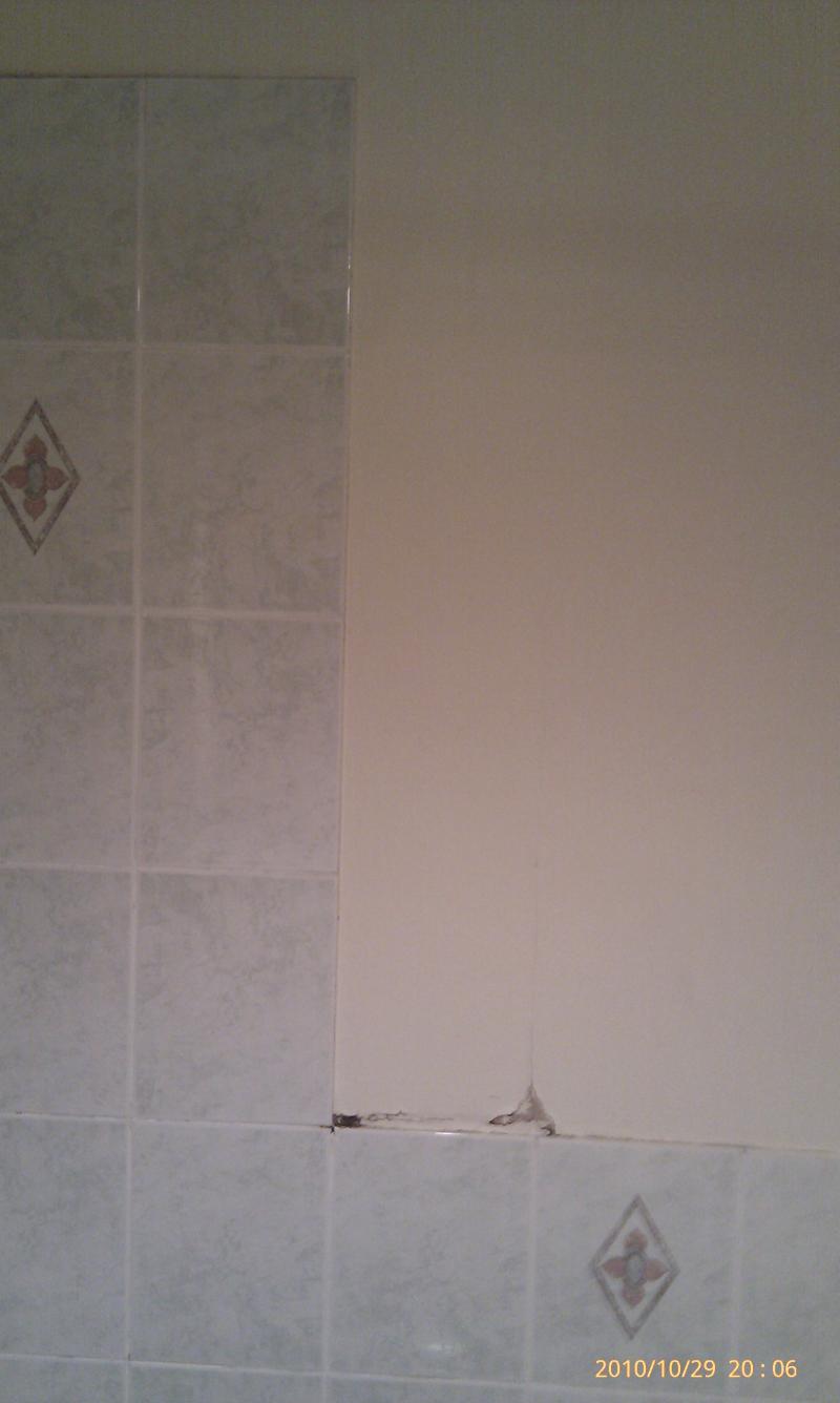

Hi,
Hope this the appropriate place to post but can you take a look at my pics and say whether or not the plasterboard is damaged and needs replacing or can it be saved.
Not sure when it started but the paint started feeling back above the tiles in the bathroom and now the plasterboard is exposed and I think the backing as gone with the paint.
I'd hate to have to replace the plasterboard for something so small.
If the pics don't do it justice let me know and I'll try and post some better ones.

Read this three times and haven't got a clue what you are asking. What are you actually trying to achieve?
It looks like water damage so I'd say your best shot is to clean it up and use car body filler. It really needs the whole job doing properly.

Definitely waster damaged.
So to clean it up, should I strip back the flaky paint that's left until it doesn't flake?
Apply the car body filler to the plasterboard and paint over?

My guess is that’s either behind a bath or in a shower cubicle & looks like water penetration damage, if so it’s almost certainly fecked; is it crumbly? You’ve should also strip all those tiles off as there is almost certainly a lot more of that crap behind the ones that are still on there & you will never get rid of that black mould.
To do anything other than a temporary stop gap repair, you should plan/budget for a total refit which will include replacing all the plasterboard with something more suitable.
Come on joe, car body filler :rolleyes: , it’ll be so damp & crumbly, he’ll be lucky if he can get it to stick! :LOL:
It's his only hope as far as I can see.
It's a shower in the bath.
It's not crumbly no which is why I was hopeful of a repair.
Not the news I wanted to hear but thanks for being honest.

youve read this 3 times and havent got a clue what hes asking joe ? lol ilmao, well i think it can be saved ive repaired lots worse , is there any chance of a pic of the whole wall muffin top?

Hi,
Here's a few more. Hope they're what you need.
does the plasterboard move when u push it? and are the tiles still stuck on ? if the plasterboard is sound and the tiles are still firm then its just a case of patching and making good wait for it to dry out first.
No, the plasterboard is sound as well as the tiles.
Sounds promising... so how do I go about patching it up?

Cheers![/quote it could mean taking the flaking paint off then making that hole in the corner bigger and patching with a piece of board placed behind it filling in then flushing it all in with easyfill to then blend in with the paint, and then repainting but ive just had an idea have u got any of those tiles left? if so just add another row, job done then 4get about it because another row of tiles or 2 for that matter wouldent look out of place
Ignore the plaster board you can see, its fine. Looking at the original close up pics, I still reckon what's behind those tiles is fecked & what you see is just the 1/3 tip of the iceberg. Filling repairs on what you can see are only going to give you a breathing space, what's festering behind there is still going to carry on & if it doesn’t smell already, it certainly will do at some point.
You might as well try joe’s car body filler, it'll probably last longer than plaster/filler if you can get it to stick.
