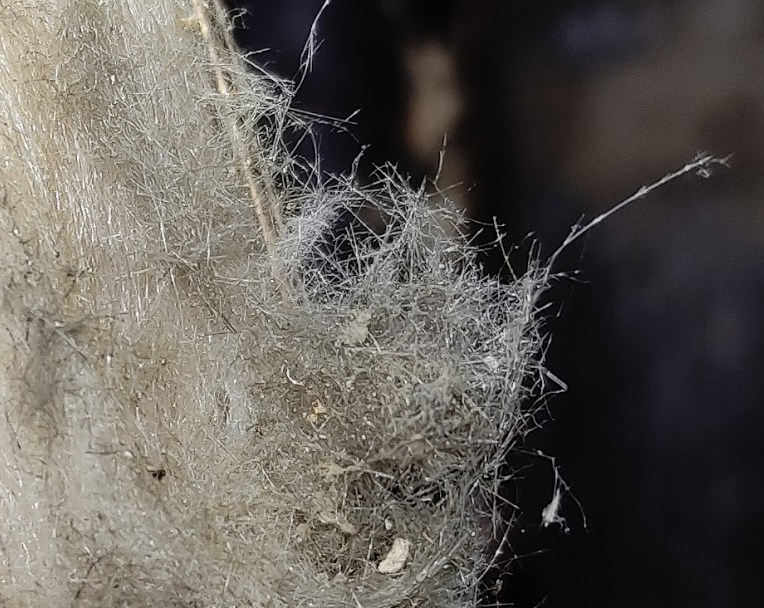

Is this pipe insulation Asbestos?

Hello all,
Just moved into my new flat, a late 70s to early 80s built council flat.
Removed a panel to access the services...
Bit scared.
Or is it just fibreglass?

Same image zoomed in:

Looks like fibreglass to me.
Google chrysotile.
You can have it tested to be sure.
Fibreglass. The stands look too big and too visible for asbestos.
