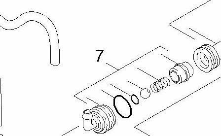

I have a KB3030 model and somehow managed to disconnect the detergent suction hose. :oops:
The machine started passing water internally and when I opened up the casing and connected it to a water supply the water was pouring from the end of the connection that the detergent suction hose connects to.
Have I lost a part that fits on the end of the plastic hose when I pulled it off - e.g some sort of non return valve?
Brilliant! The diagram really helped
It appears that the plastic tube simply slips over the nipple.
What looks like a ball & spring assembly within the 'detergent fitting assembly' (#7 in diag.) is probably the culprit as it's likely to perform a non-return function I'd guess. I doubt if it's a failure of one of the o-rings as the water is passing at mains pressure as opposed to just 'leaking' out.
I note that a replacement detergent fitting assembly is no longer available for my model :cry: However, there may be an alternative that would suit.
My next problem is to remove the large metal cover assembly which encloses the fitting!

Do you have a seperate lance you can try, it sounds like it may be a problem with that (perhaps blocked or obstructed) as I always thought that the soap was sucked out by the water flow creating a vacuum rather than pumped out.
