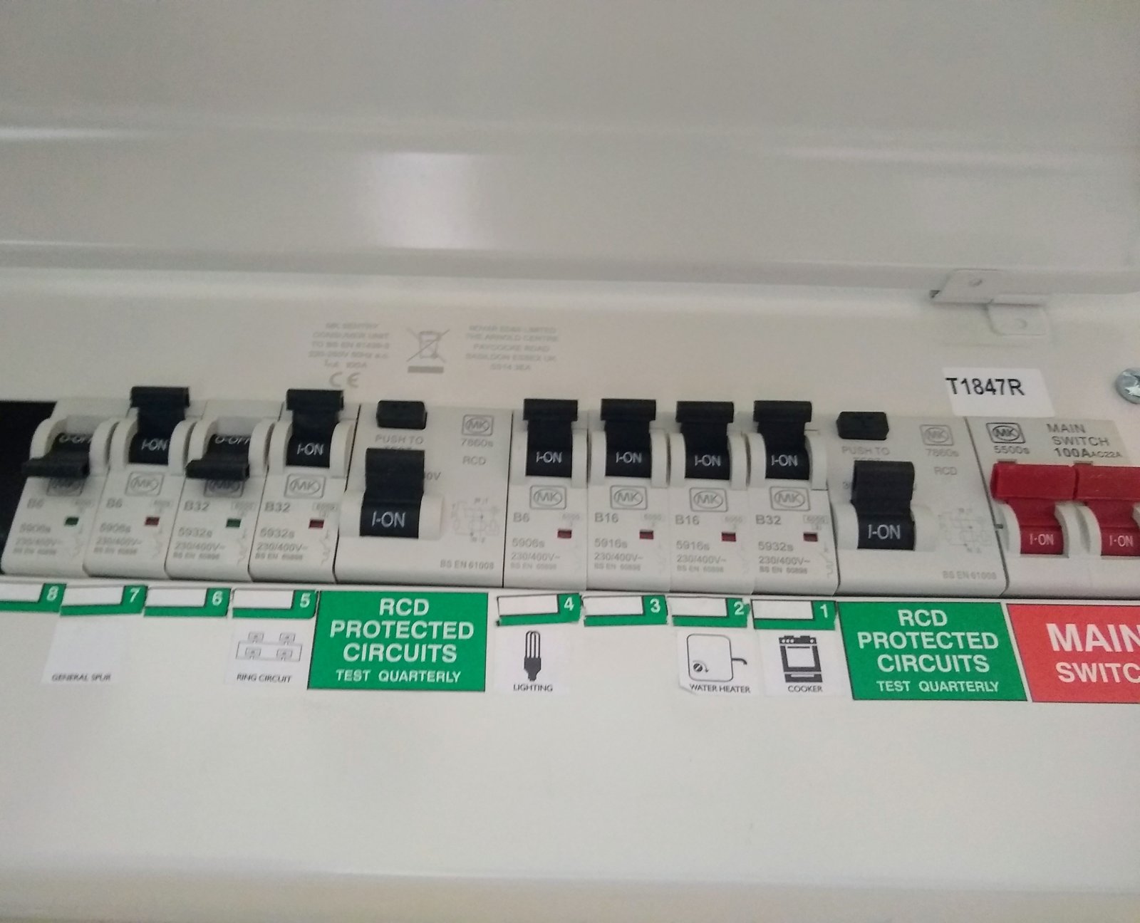

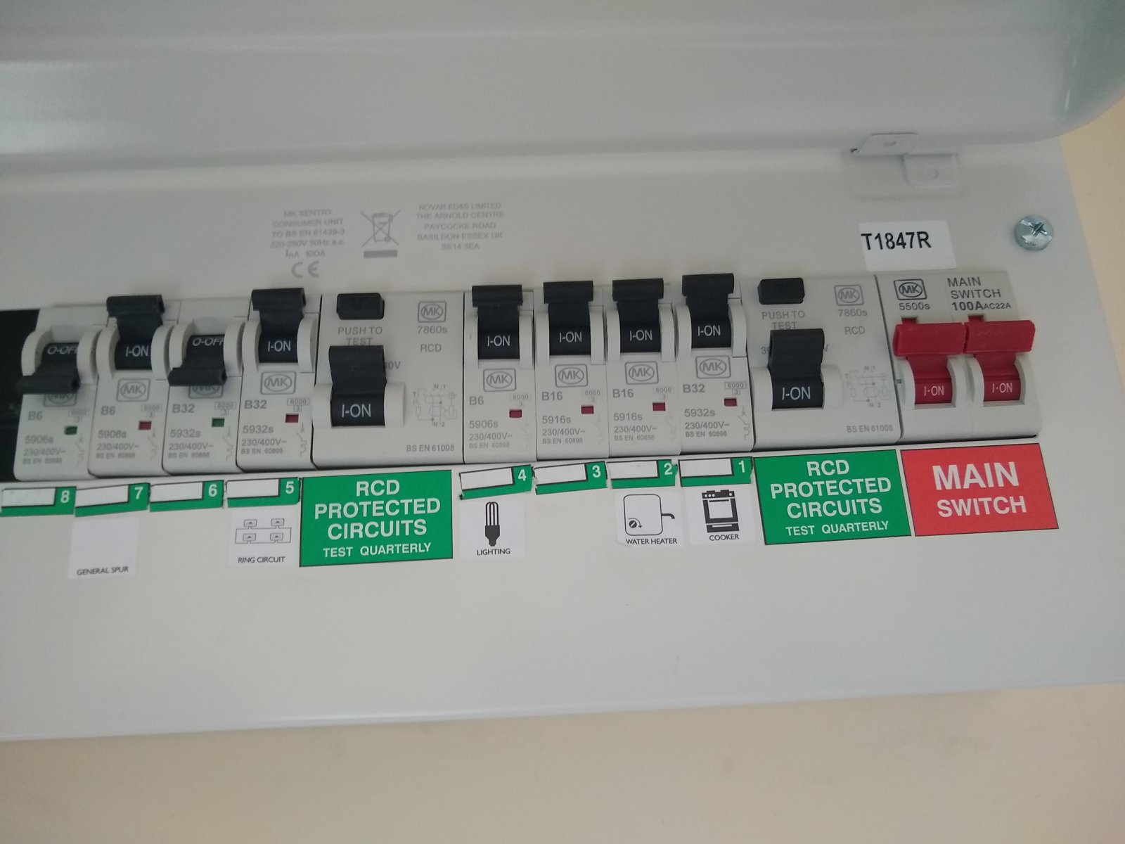

What you can do depends on how the kitchen is currently wired. Best place to start is the consumer unit. First point what type is it. You could find a wylex wired fuse unit. A later type with cartridge fuses, or a modern one with mcb's and rcd's in it. 2nd what rating is the part that powers the kitchen. It might power the whole house / flat, one floor or just the kitchen. A photo of the CU can help as well with the covers off so wiring can be seen.

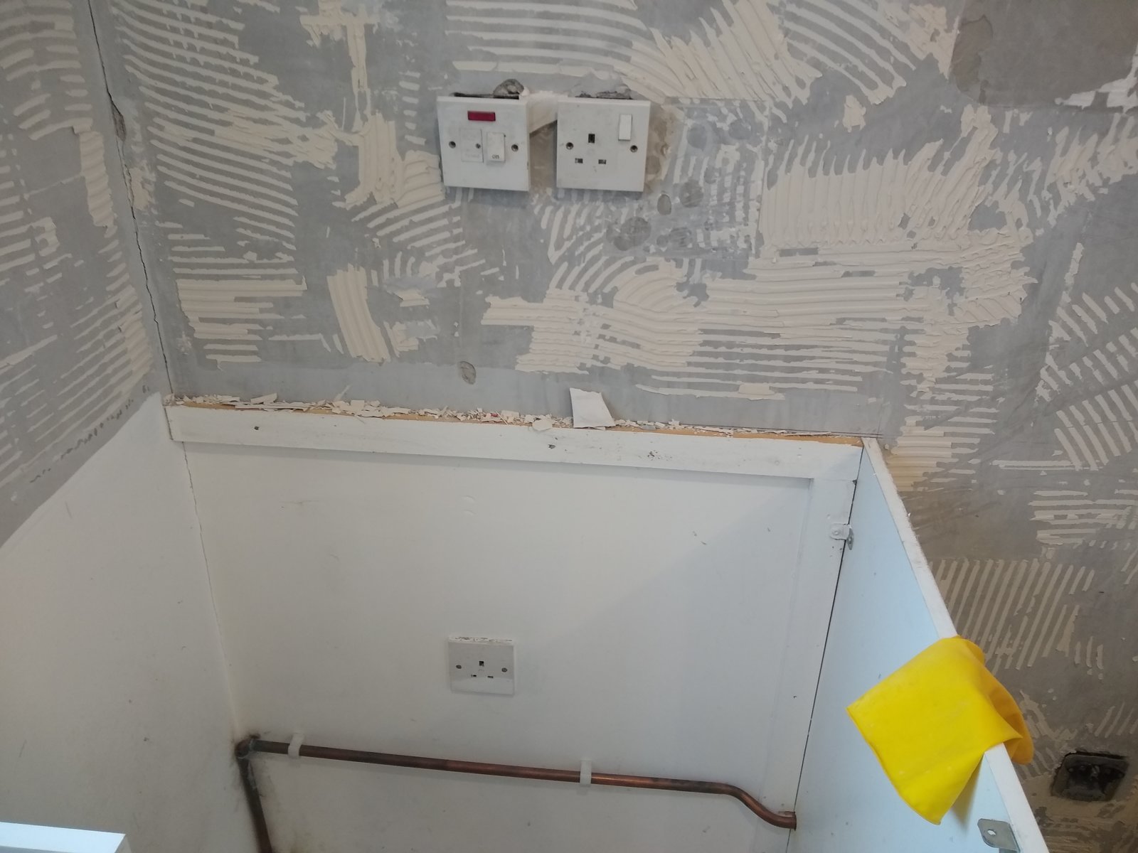

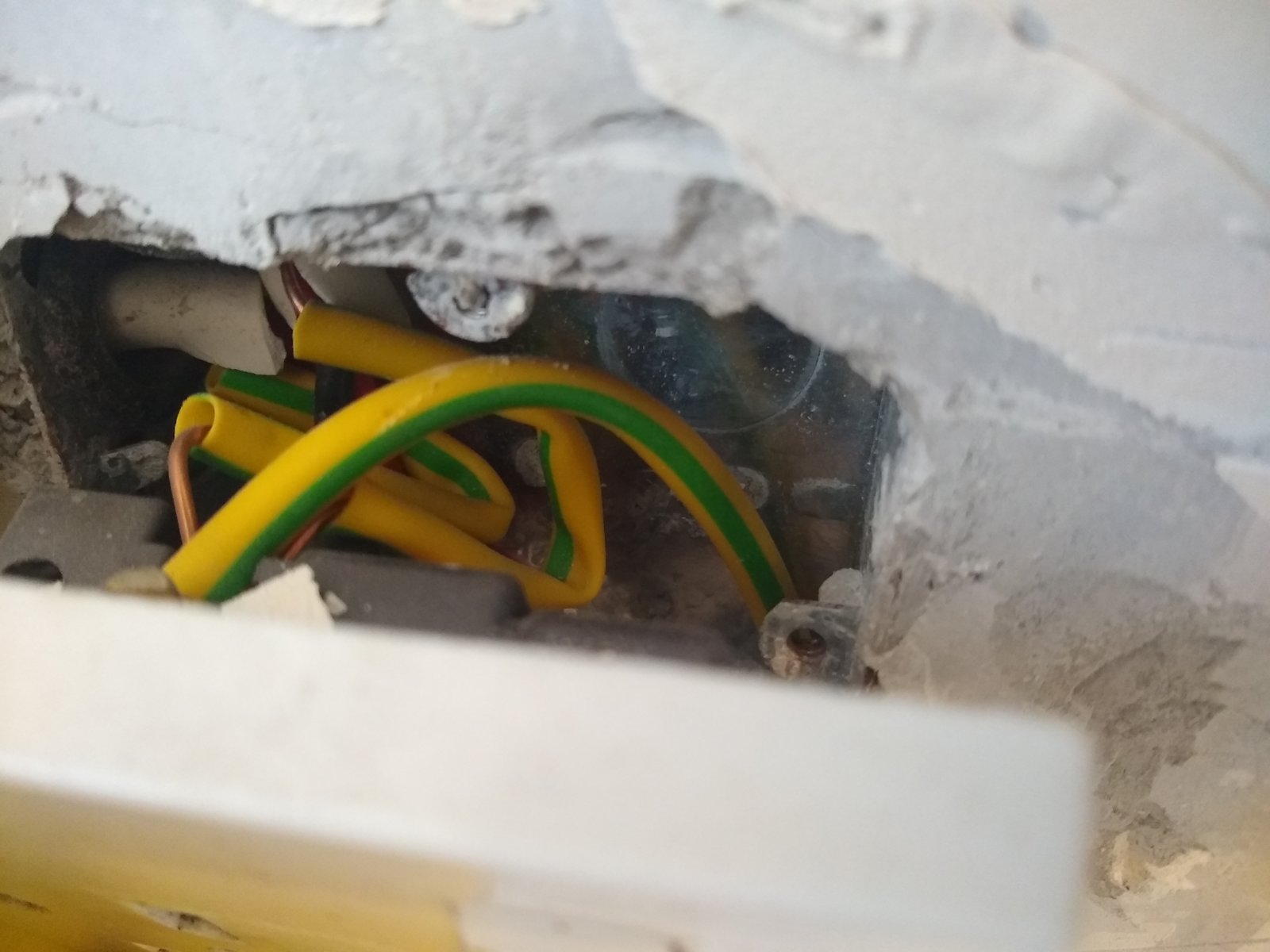

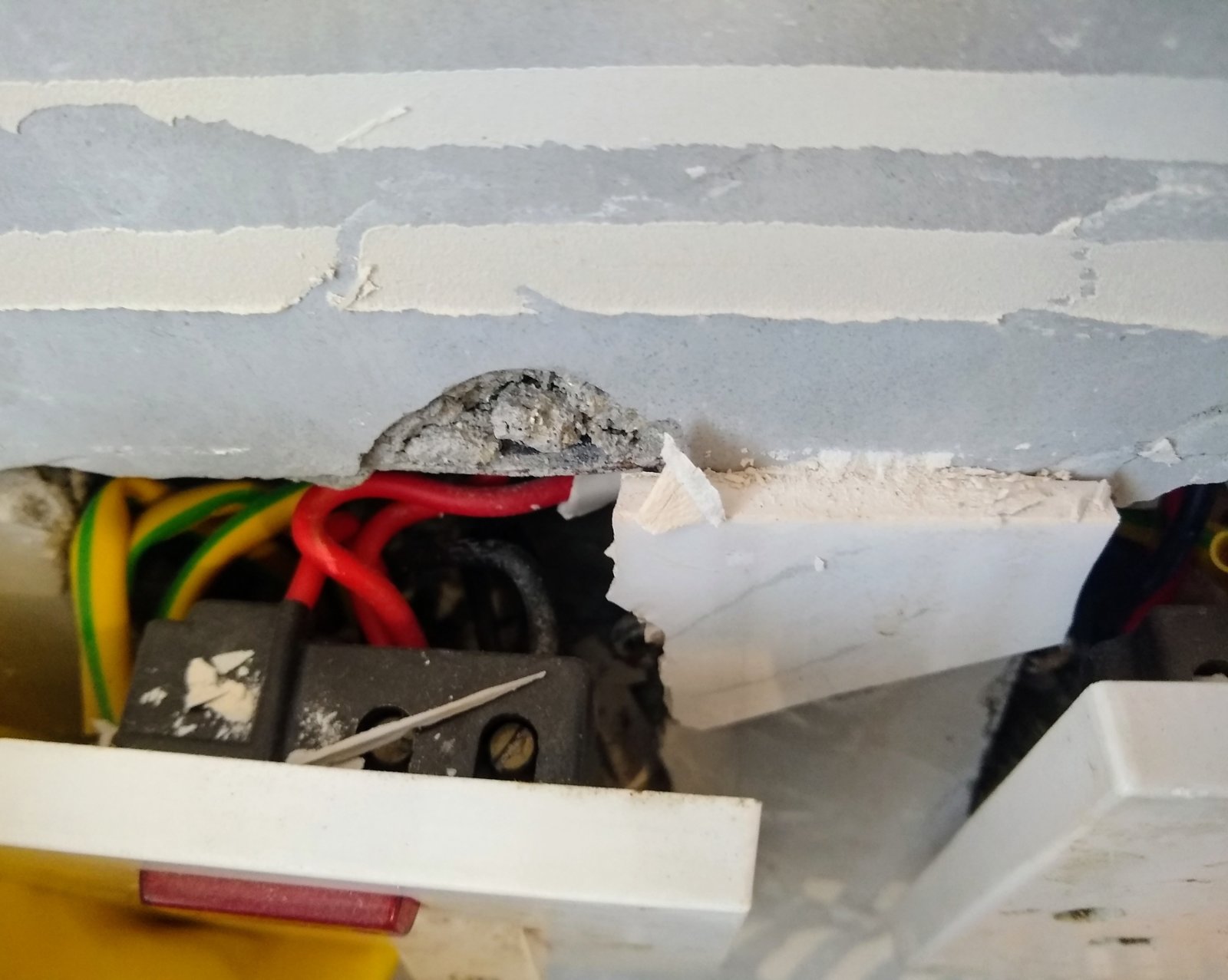

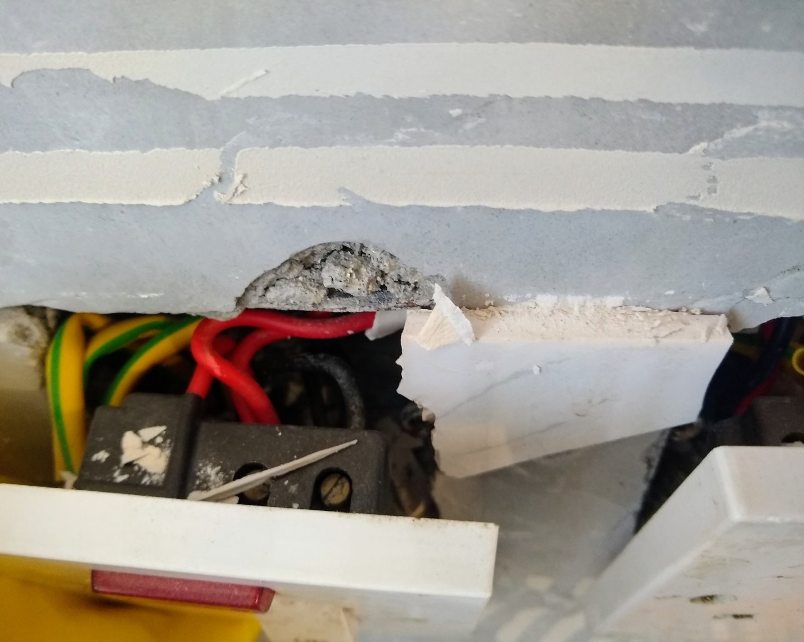

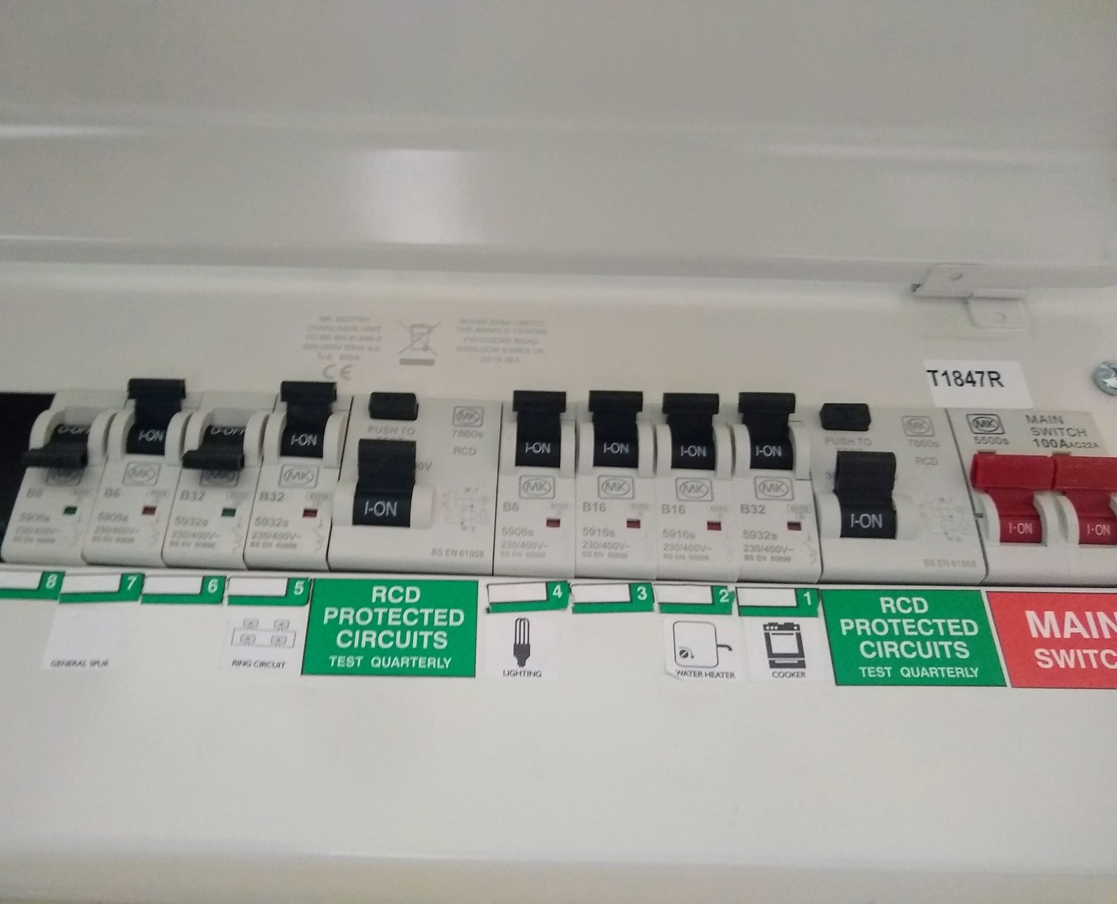

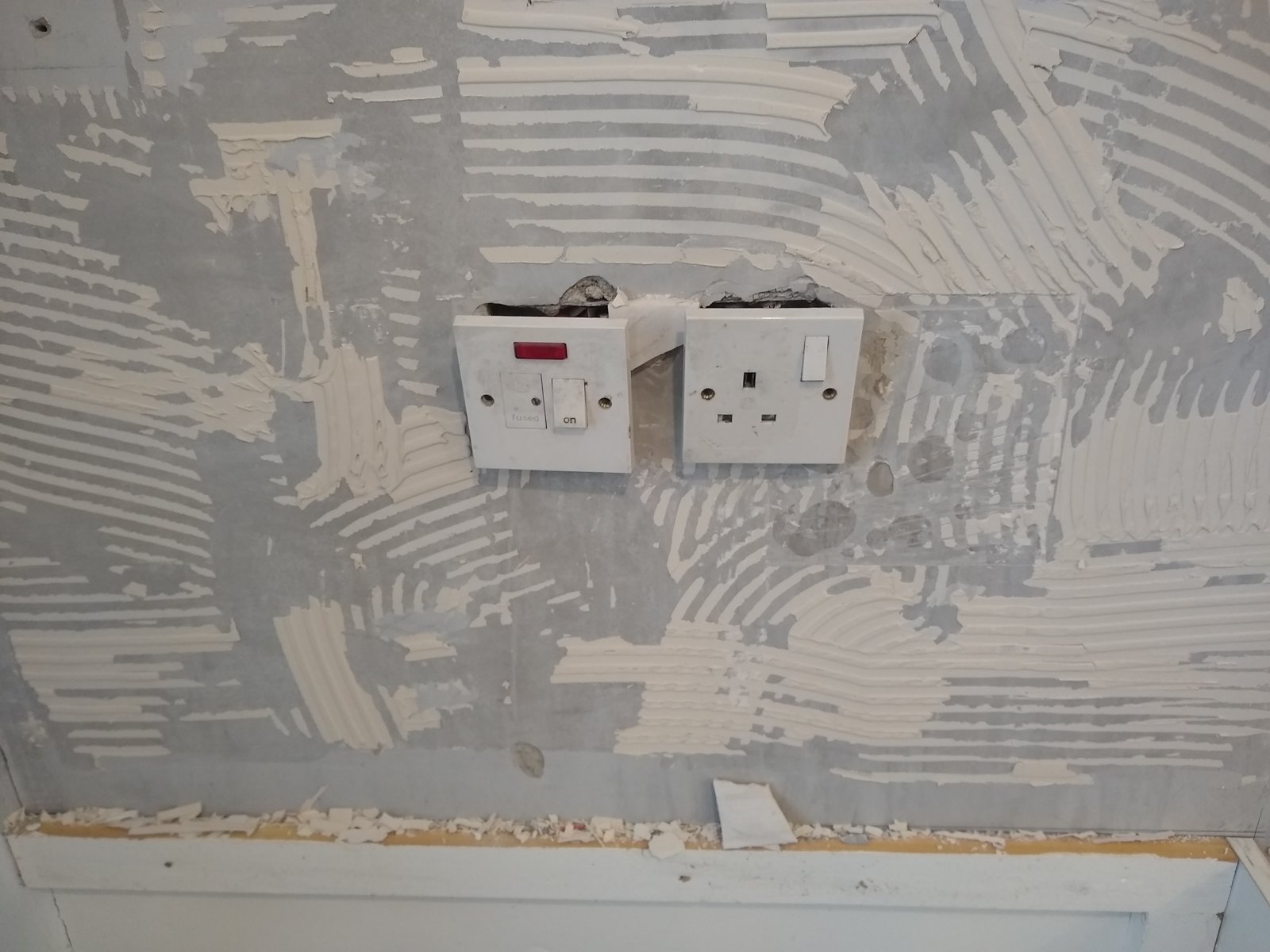

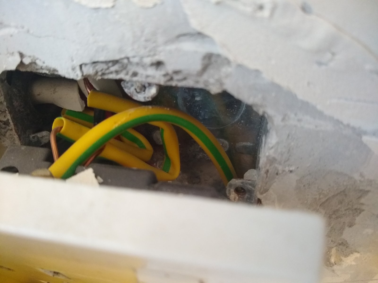

I have attached pics of the consumer unit, the fcu, socket and wiring behind the sockets
Both the fcu and single gang socket have wire coming in from the 1st floor, then then a wire going out to one another
@John D v2.0 the socket that i purchased is Double pole i.e. Live and Neutral switched on

You have 2 FCU's. One circuit rated at 6amps and another at 16 so depends what's on them. You need to find out what and which one you can use. Both may be capable of being fitted with a higher current MCD. Personally I would always fit an extracter via it's own SFU with a sensible fuse as motors can cause grief also a washing machine. That way if they have problems causing RCD trips they can be disconnected via a double pole switch. Switches on sockets might not be easy to get to. They don't currently insist on this as far as I am aware just suggest it.
Then comes the wattage of the washer and extractor.
Easiest why to find out which is which is to turn them off at the CU and plug something in that you are 100% sure works and wont overload them. One at a time, off and then back on again. Or buy a test plug. There is always a chance that some one might have slipped another socket in somewhere as well - maybe not an electrician.

I have added a pic of the CU listing
No, he doesn't. The things in the consumer unit are MCBs.
The 6amp fcu is a general spur and the 16amp fcu was providing power to an old water tank.
as above.
And it isn't a spur.
Incidentally you can't get a 16A FCU, and if you wanted a 6A one, you would have to order a cartridge fuse specially (probably unobtainable as the nearest standard one is 5A)
In the pictures I can see one FCU which is probably intended for switching an appliance socket. The description on the CU label is poor, it would be more meaningful to say "kitchen appliance" or "fridge outlet" or whatever it is.
It is next to a socket outlet, so it would be rather eccentric to run a dedicated circuit to it.

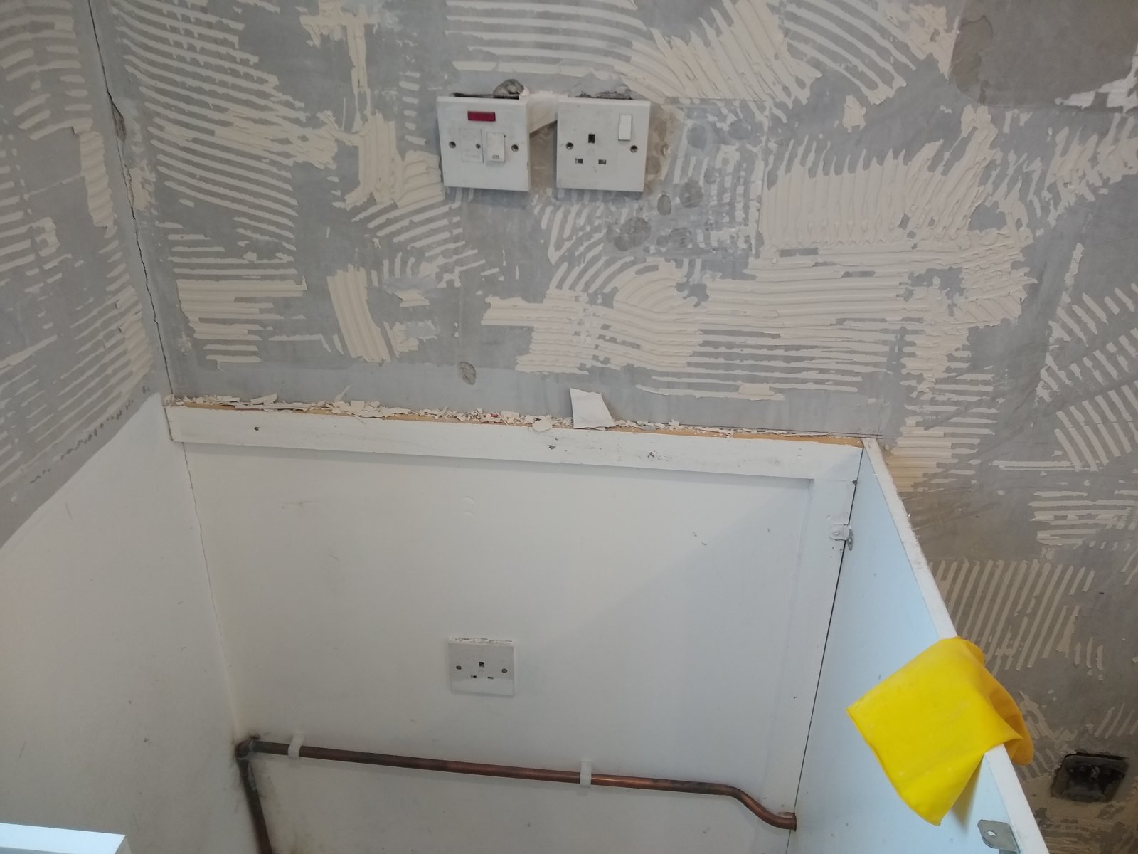

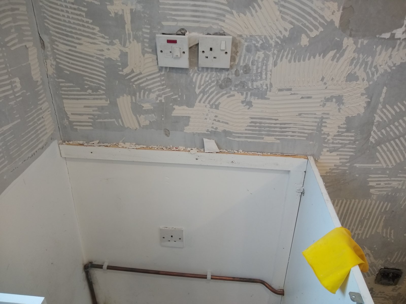

You are right, I have attached a pic of the appliance socket
However, according to my kitchen design the washing machine is on the other side of the room
So i will chisel out the existing wire and run a new longer cable to the position of the washing machine. The socket will be integrated into the base unit adjacent to the washing machine.
However do you have any idea how i can add an additional socket for the kitchen hood extractor?

Or you could spur off an FCU from a conveniently close socket. You could also do this for the washing machine. Trying to run a long cable from that old FCU does not sound very satisfactory. Leave it in place and you could use it for a fridge or something.
Shame to waste the 16amps. It could be converted to a 20 amp radial for sockets. When there is cooker circuit some electricians do that. I always wonder how many sockets and for what. A bit behind the times going on what may get plugged in now.
If washing machine is <2kw guidance suggest that it can be spurred of a ring - usually avoids overloading thanks to diversity. You have one ring, flat maybe? Houses often have 2. 3kw can be plugged in but a separate circuit is preferred. Maybe the 16amp one?
