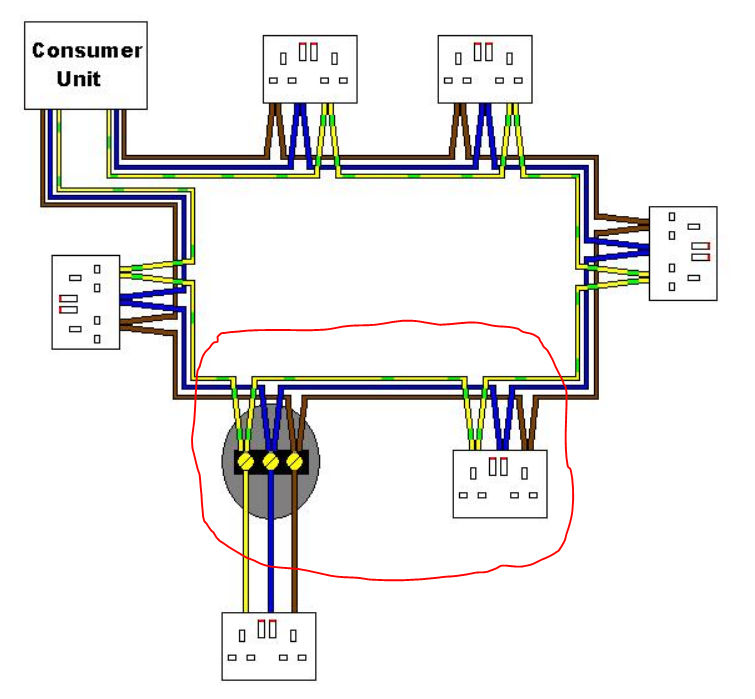

2.5mm cable goes between them (like a spur). But in addition, both the fcu and double socket have another cable coming into them (as if a supply). Is this normal?
They are on the existing ring circuit
If I understand correctly, then of course it is normal.
How else would the electricity get there and on to the next socket?
Then you have answered your own question.
A "ring" circuit is a circuit in the rough shape of a "ring"; it is not just another name for "circuit".
Imagine your FCU instead of the junction box.

I hope that's not a yellow cpc on the spur.
Picky picky. The other 'yellow' wires have green markings. I'm suprised that you didn't mention that the green spacings did not comply with the relavent standards.:rolleyes:
No mention of it being a screw terminal JB and must therefore be accessible either :D
