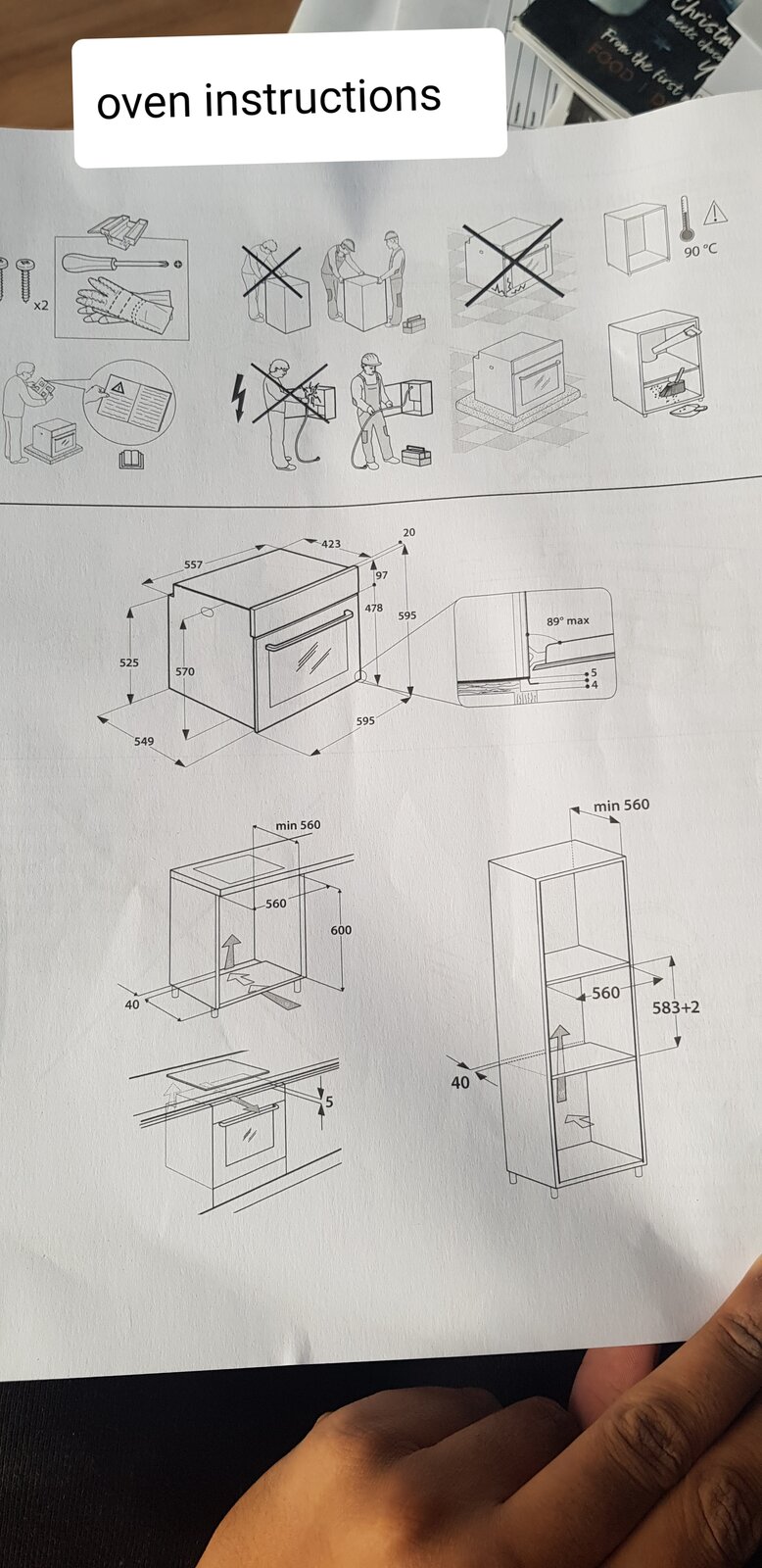

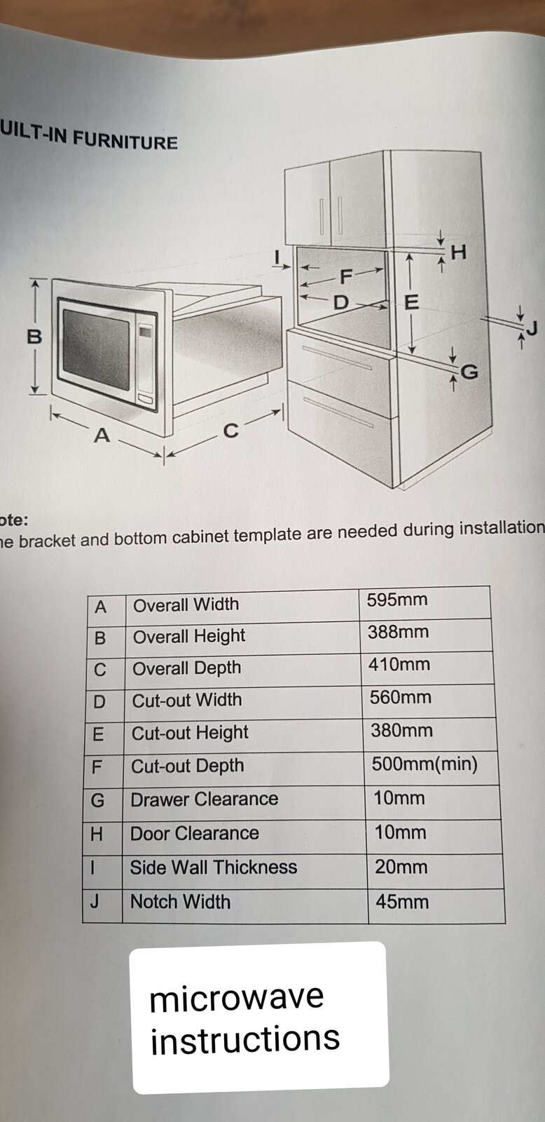

Hi all,
We picked up a larder unit from wickes and built it as if for a double oven so that we could fit our single oven and microwave. Our plug socket for both (both appliances have plug supplied) is now directly behind the oven. The ladder unit as built has reinforcement under the shelf for the oven. We then used a spare shelf above the oven to place the microwave on. There is of course no back board behind the oven or microwave. My main concern is how to ensure the correct ventilation for both. Can we install a grate in the plinth for airflow?
Also should we reinforce the shelf for the microwave as well? The larder unit came with extra pieces (G and H) as shown in the picture I provided
Any help much appreciated!

I don't know about yours, but built-in ovens usually have a cooling fan than blows air round, and out (probably the top front edge) until it is cool.
If your microwave is not intended for building-in, it may not have this. you can probably get by by spacing the shelf above to allow easy airflow, and having a gap at the front so that air can circulate through and out theough the open back, where it will naturally rise towards the ceiling. The instructions probably say how much clear space it needs above.

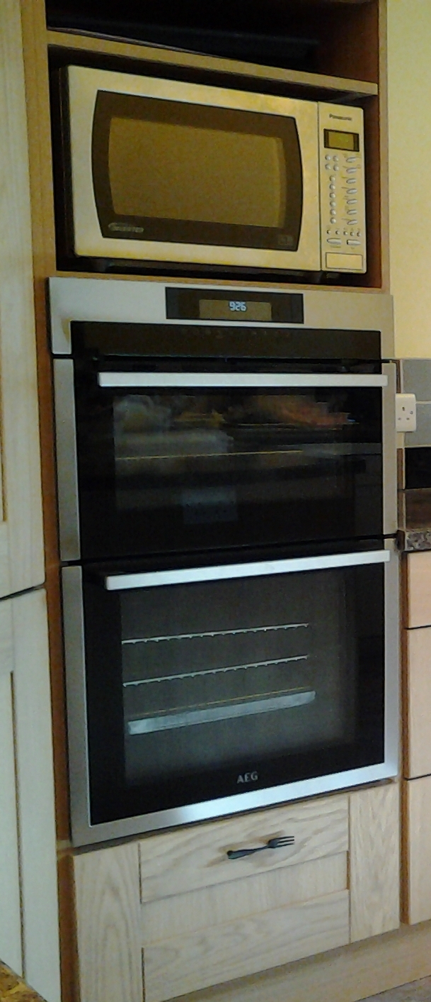

I have something similar and I think the gap above the microwave is about two inches, and the filler piece is spaced away from the appliance so you could poke a finger in. The back of the cabinet is open.
Could you share a picture possibly? Our oven is at the bottom and the built in microwave is at the bottom with the gap in between

Sorry, I meant putting just a vent in the plinth to aid natural airflow as the microwave and oven itself will have a fan of its own. I am trying to create the flow as shown in the oven instructions, but the section below has a back board.

I think there will be enough space behind the unit for air to rise up, and enter where the back is open, then rise up by convection and hopefully emerge through the gap at the front. The fans may aid this. You might be able to set the filler strip forward of the microwave.
By installing them in the locations provided, which as you have already mentioned, do not have a back to the cabinet.
You do not need to install grates, fans or anything else.
The pieces G&H are used as spacers to correctly position the oven vertically within the housing - but only if they are required, which they usually are not.
If your oven fits without them, they are not needed.
Any standard shelf is more than capable of supporting a microwave. Additional supports are not required.
You are trying to solve problems that doesn't exist.
