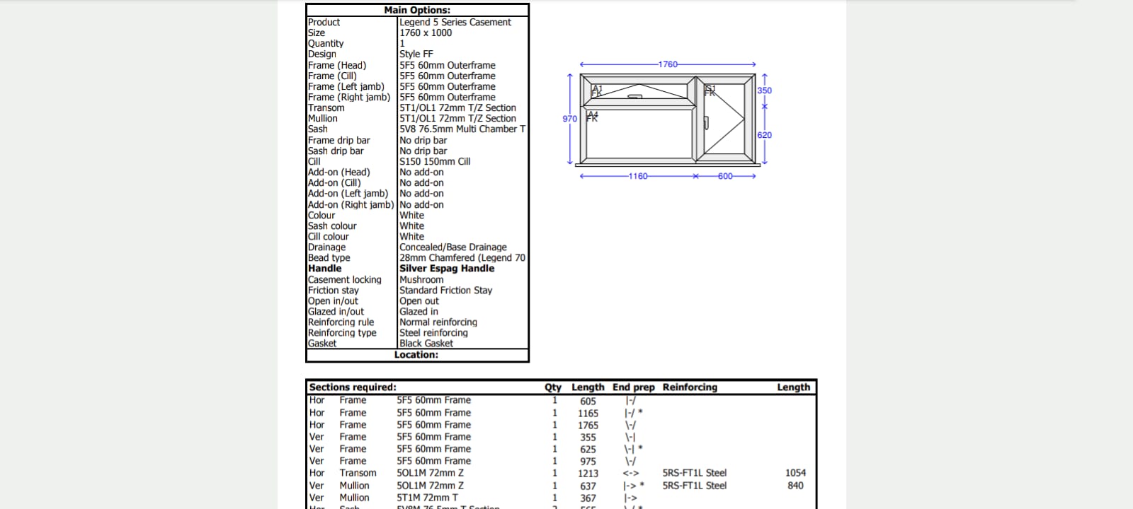

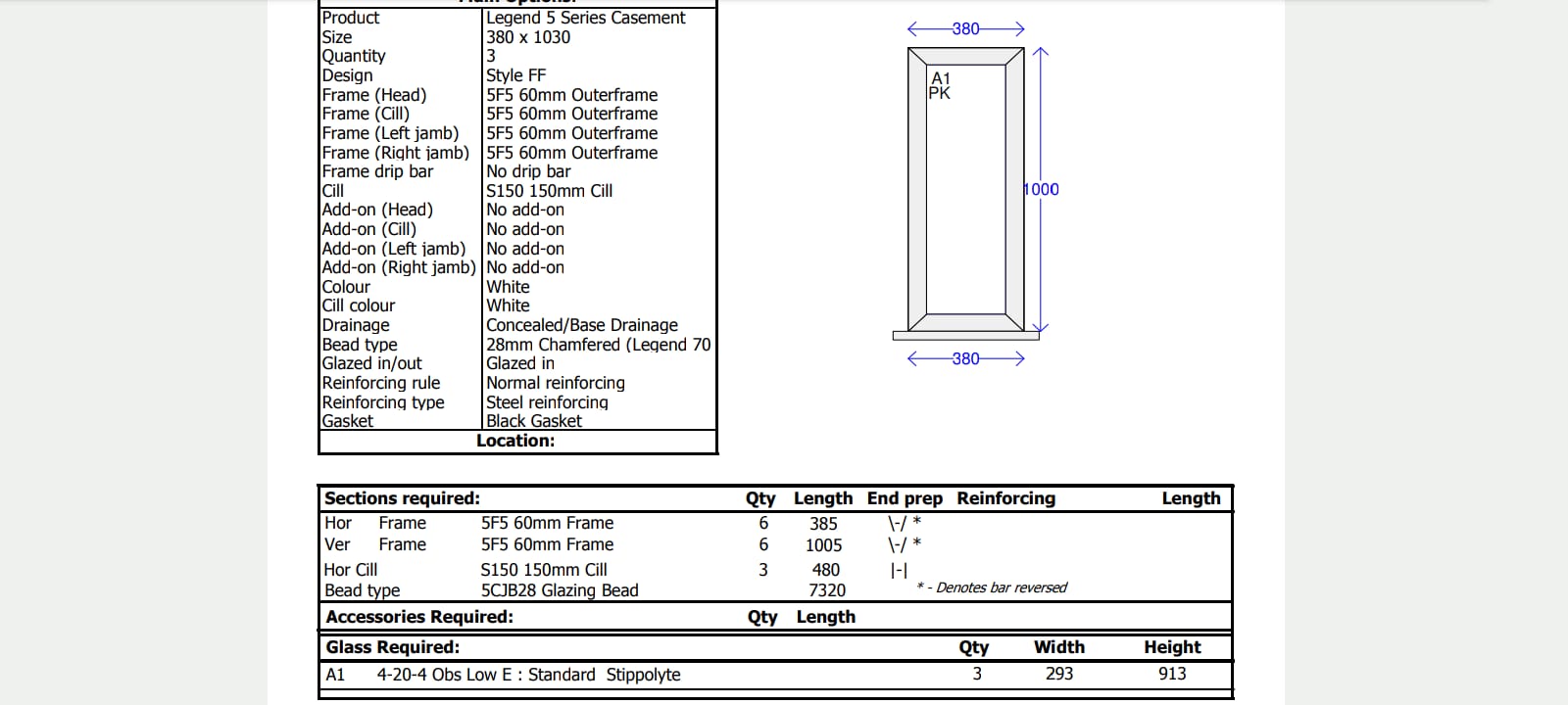

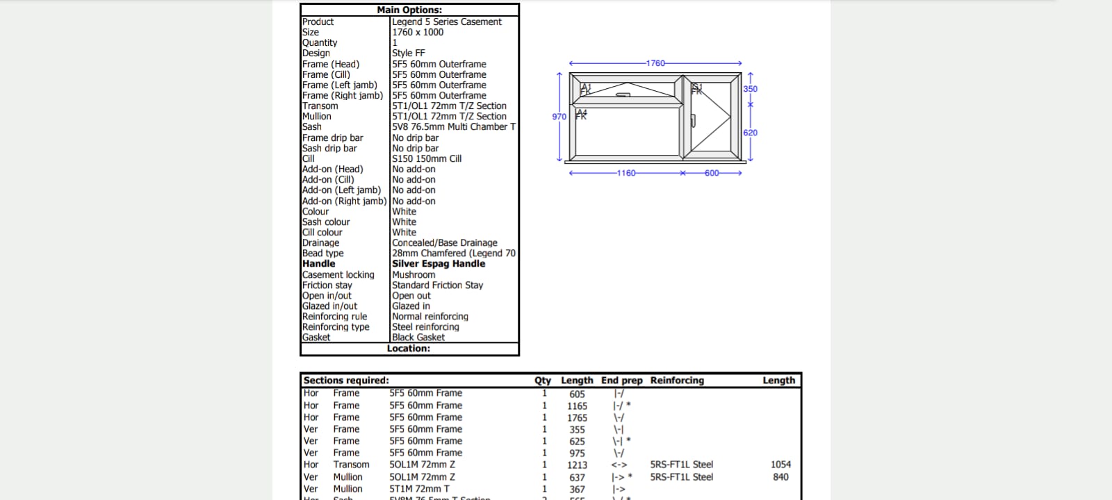

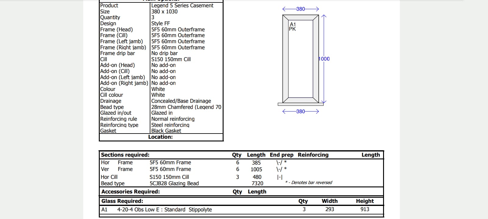

Hi everyone,
I’m currently going through a double glazing renovation and have a concern which I’d like to clear up for myself.
I have discussed and agreed with my double glazer that I am wanting the Kommerling C70 profile which he himself recommended. However, he has sent me over an order from which states Legend Series 5 Casement which he is telling me is a Kommerling system.
Can someone please shed some light on this for me? As if he isn’t being honest I’d rather not use him.
Please see order attached.
Thanks in advance
