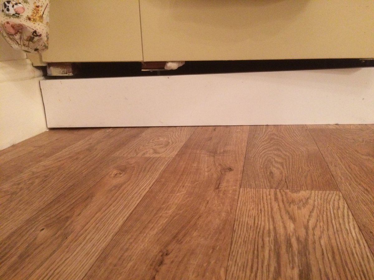

My main issue is in the kitchen the floor is quite uneven and slopes off towards the wall so the plinth under my kitchen cupboards is a tight fit one end but has a good 2 inch gap the other..
Would a solution be to cover the floorboards with some 6mm ply, then pour self levelling concrete to make a nice even surface? Any other ideas welcome.
Ideally, you want to lift the floorboards, apply furring strips to the joists from 2"-0" and replace the boards on top.
You can go the levelling compound route but 2" is a lot to make up and it will not adhere properly on top of the old boards.
As you can see it suddenly drops off

If all you're niggled about is the plinth then buy a length of 6" plinth and scribe it to follow the floor!

Dont do anything until you know the cause(s)?
Why does it "suddenly drop off"?
You might install a new floor according to various suggestions but what if the floor moves again?
Your pic shows the unit remaining level and the plinth dropping - yet there is no sign of any movement in the skirting? Who installed the units, and when?
You would do best to remove some boards, and investigate where the joists seat in the walls.
The kitchen was installed by IKEA in approx 2004. We bought the house in March 2014 and the survey said it had non progressive dips in the floor (can't remember exactly how they Worded it)
I do think its a bit odd as the skirting board doesn't have a big gap in it.. As if it has either sunk with the floor over the years or been refitted flush with the floorboards

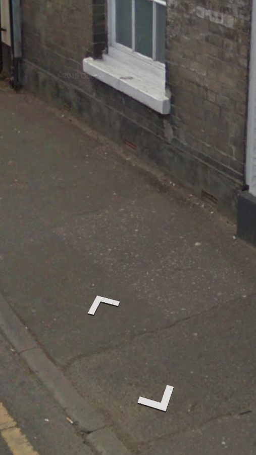

Why not post some pics showing the outside wall(s) of the kitchen.
Is the external ground level lower than the kitchen air bricks?
Here's a quick screen shot from Google Earth of my external wall. The air brick is i guess you would say on the first row of bricks along the bottom.
