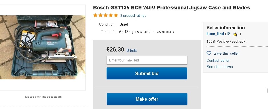

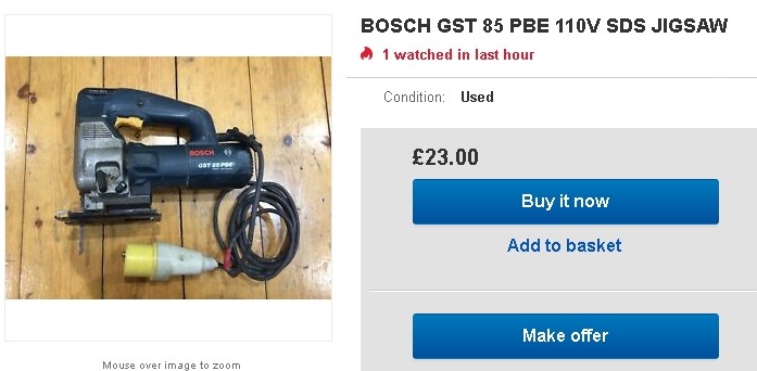

Maybe of interest to you, i recently got a gst ind bosch on e bay for £30 , it had hardly any wear on , but still re greased it , i see lots on 240 and 110 v ones, all seemed fine, i have also in past got a 110v one , been fine for 3 years on site, cutting wood metal laminate suspended floor , used mostly every day for £25 , better than new DIY from lidl
