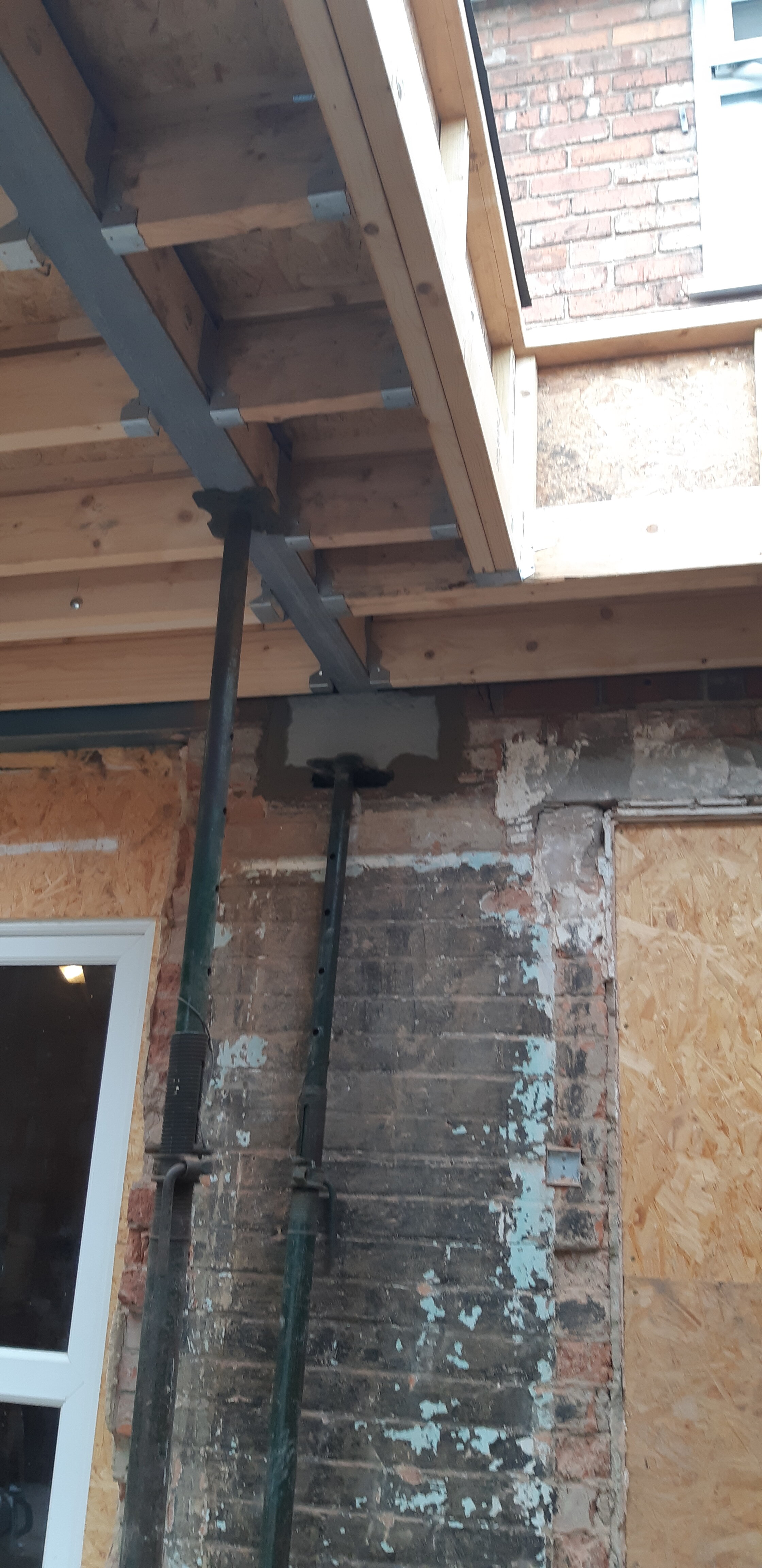

Hi all,
Having a nightmare with sliding in my 600x215x100 Padstone into a tight position under the steel. Any advice?
Every time I slide it in, I have mortar spreading out and then finding it difficult to get the Padstone tight to the steel.
Not as easy as the ones I’ve done before with much smaller padstones.
I have got the steel into position with acros now just building up to the steel but finding it difficult sliding the Padstone in and getting a tight Padstone fit.
am I allowed to have a thin mortar line under the steel and above the Padstone?
