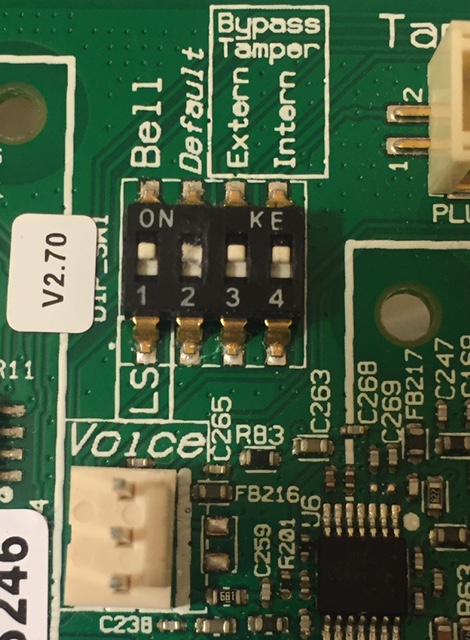

Hi All,
Moved in a new home. House has a Risco Lightsys alarm installed, but with no external bell and missing a couple of sensors. I have purchased these and have gone to fit them.
I'm wanting to set the alarm back to defaults. I looked up in the manual how to reset the "defaults". Setting the dip switches according to the attached picture. Restored the power, and waited, expecting to need to enter the default code of 1111.
This didn't happen, it started back up normally, all the previous setting still there. Am I missing something?
The 2nd dip looked a bit bashed around, so I took a meter to the connections.. when its in "on" defaults its pulled to 0v. When it's open there is about 3.3v on the bottom pin.

  • Am I setting the dips incorrectly?
  • Is there another way to cause the reset?
  • There is a RS232 interface, is it possible to flash the unit back to default?

Dil switch will reset engineer code and user code back to default
You will need to go into programming mode to default the programming
Page 59 of manual
Hi, Thanks for the reply.. Even with the Dip switch in place the codes don't reset..
I am expecting that following restoring power it should go through the initial setup.. But this doesn't seem to happen, the codes don't reset..
Is it possible to reset it via the programming interface?
Basically, I cant enter the installers menu..
