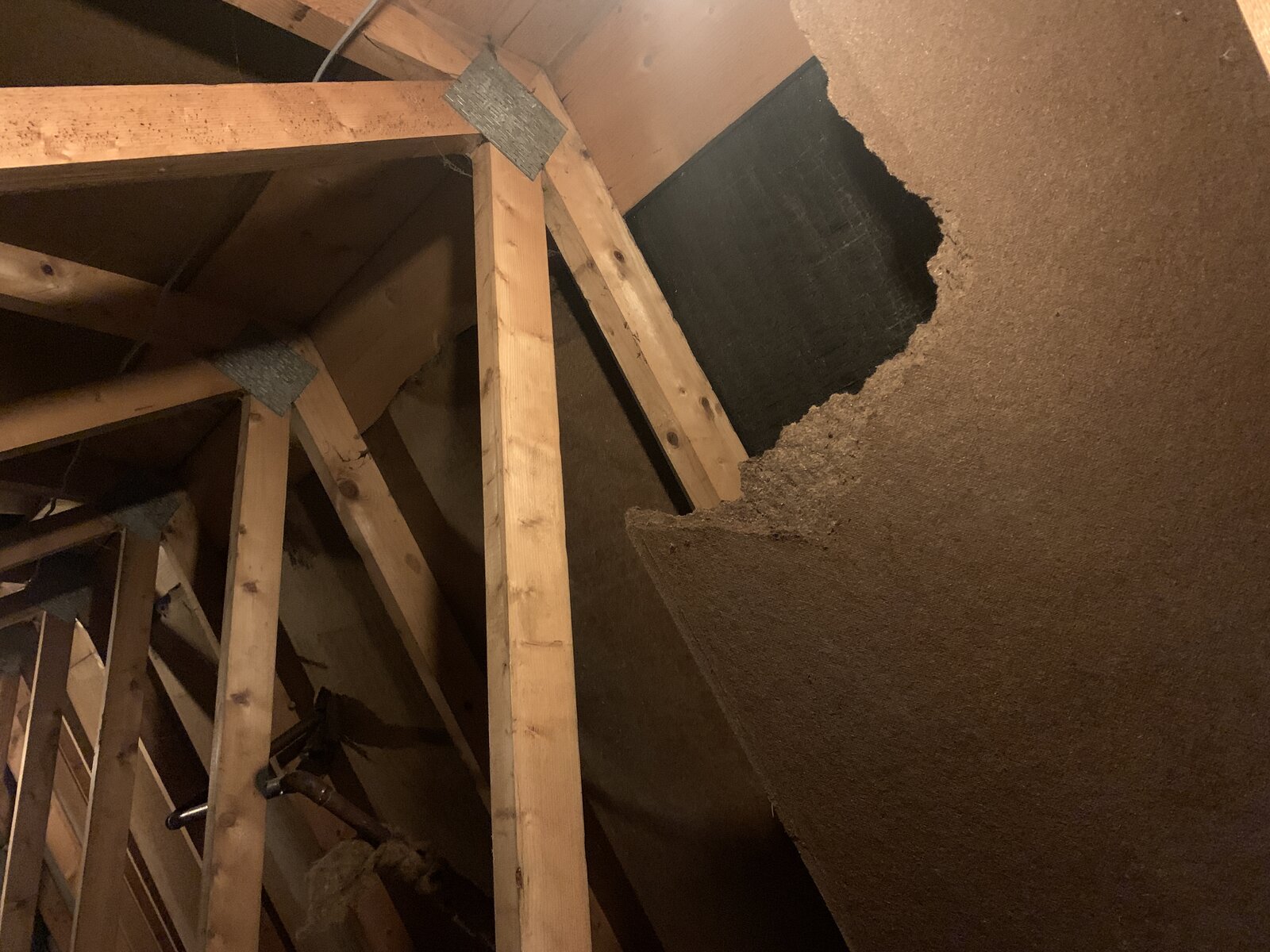

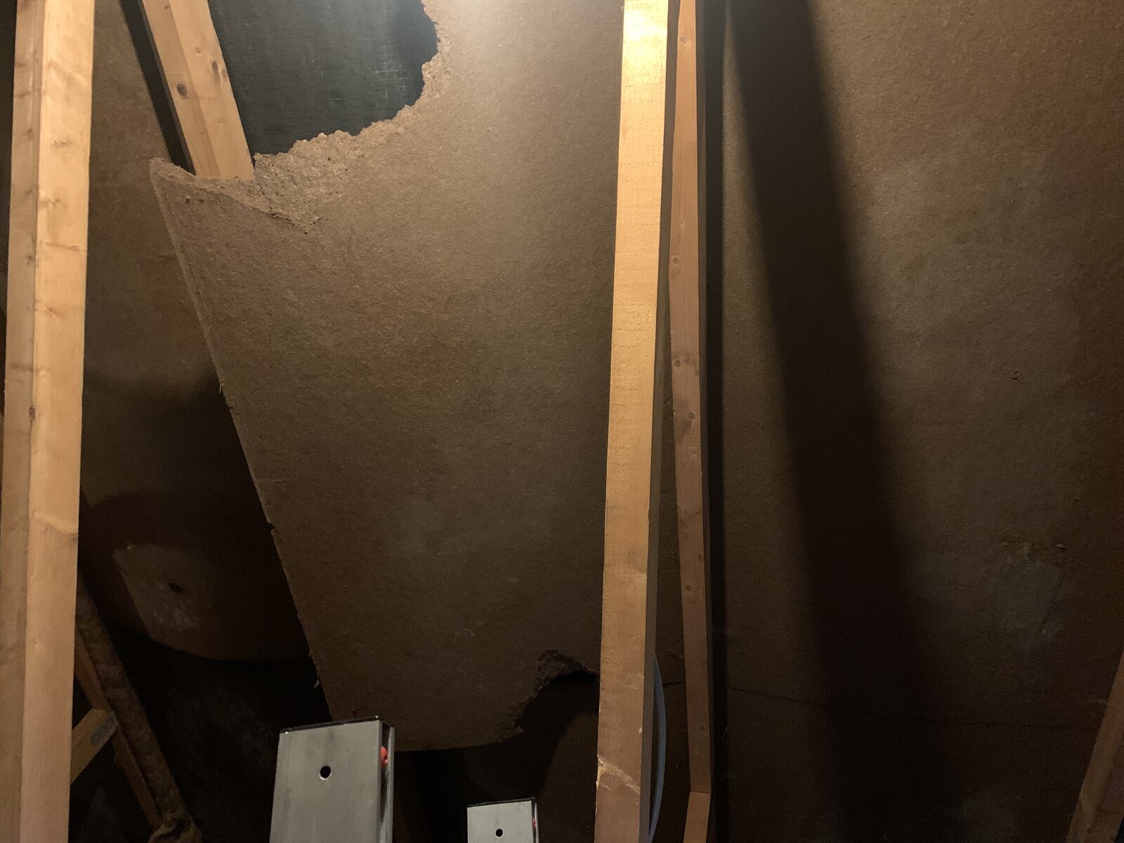

Hello, our loft ceiling is looking a bit sad (see photos). The brown board stuff is peeling away from the roof and crumbling. It's been like this since we moved in 2015. I guess this board stuff has been in there since the house was built in 70s. Should it be replaced like-for-like or something more modern?
Any help appreciated.
I'm also looking at eliminating damp up there by following these tips, if that affects things. Obviously the damp has appeared since loft insulation was dramatically increased 2 years ago.

You shouldn't have the board at all, I guess a previous owner did it to reduce dust or as some peculiar attempt at insulating or other futile idea. Do you have open vents at the eaves which have been kept clear of insulation?

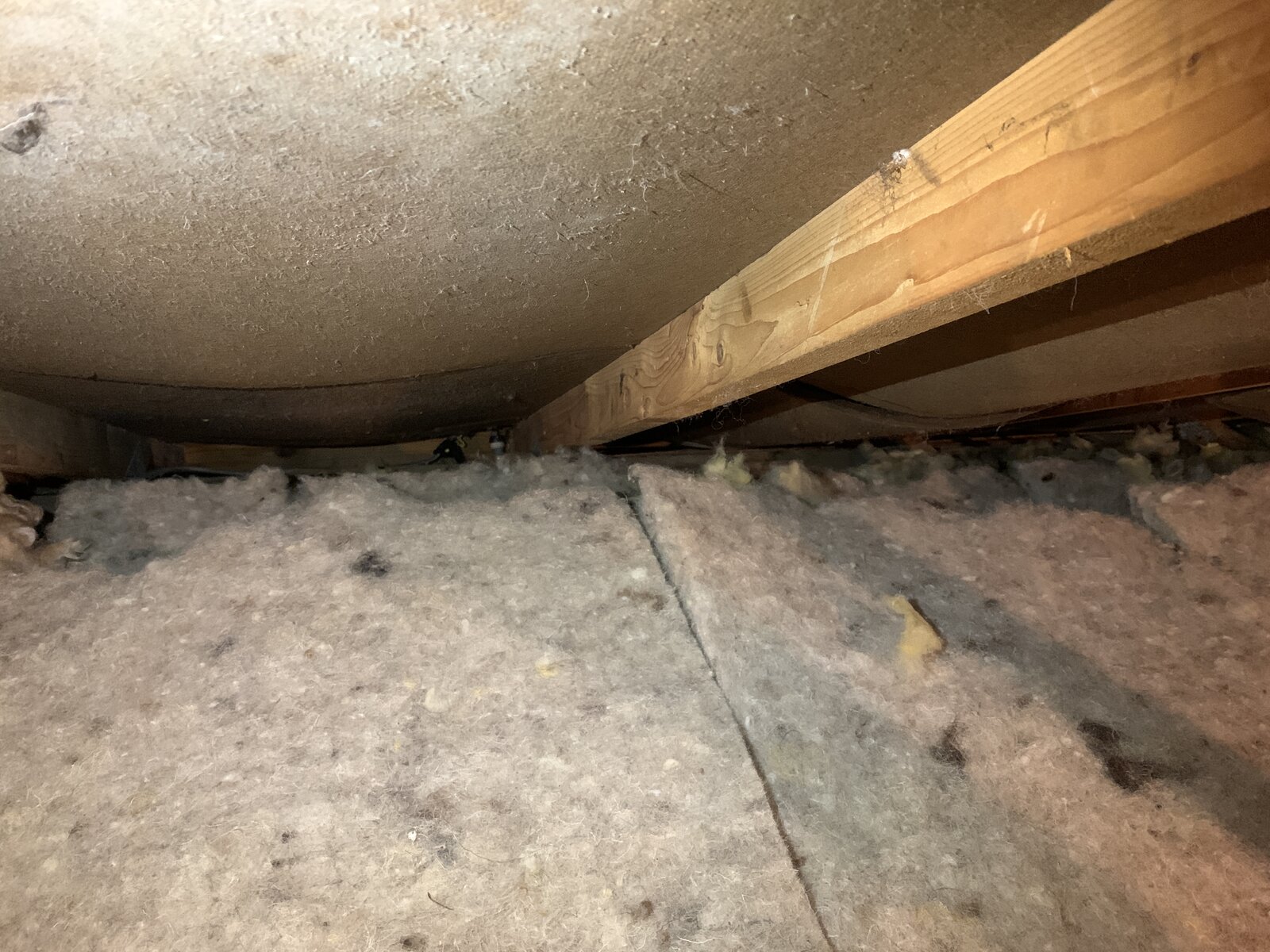

Look at the eaves. Can you see daylight, or has the insulation been pushed right to the edge?
Roll a bit back and photograph it.

The attached pic shows the gap in insulation next to the eaves. You can just about see the downlighter which used to poke out and illuminate the house (lights since covered over with new soffits).
I can't see anything that would provide ventilation at the eaves, either inside or out. There seems to be vent products available for exactly this kind of thing.
In the photo you can also see where that brown board stuff is sagging and possibly getting in the way (at right).
As for bathroom, yes the plan is to seal off bathroom downlighters and get better ventilation.
