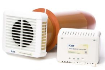

If you want to get really serious about it, you can get single-room MVHR units that claim 80% heat recovery. Not cheap though, might be cheaper to just keep wasting energy...
Yes, I should have mentioned that, but, as you imply heat recovery systems are not cheap, and I personally don't know of anyone who uses them - although the same people often seem to fuss about relatively trivial causes of 'heat loss', whilst happily letting an extractor 'pump out' a lot of heat!
Kind Regards, John
I have never understood the heat recovery claims, because I make it, at best, 50%. All they can recover without heat pumps, is to recover half of the difference of the incoming air temperature, versus the outgoing. Outgoing 20C, incoming 10C, at best the fresh air warmed to 15C.
A counter current heat exchanger can do a lot better than that. Whether domestic appliances are that sophisticated is another question.
